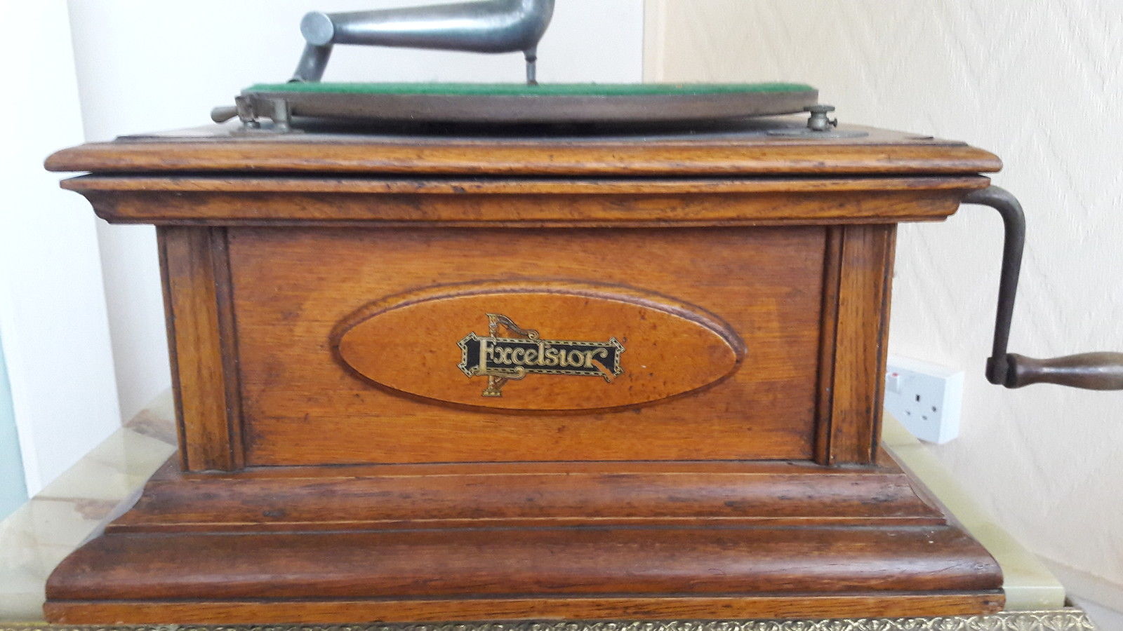

I bought this machine two days ago, since the price was good, and I also would like to possibly save it from "oblivion". These are all the photos I have so far.
Excelsior....could it be Excelsior Werke Cologne, but I understand the Excelsior name also was used by providers of gramophones. I was able to find this information from a past thread:
viewtopic.php?f=11&t=48629&p=288186&hil ... or#p288186
by epigramophone » Tue Feb 23, 2021 10:37 am
Tournaphone was one of several brand names applied to gramophones supplied by The J.G. Murdoch Company of 59-61 Clerkenwell Road, London E.C.1, one of the largest firms in the trade. Other Murdoch brands included Beltona and Excelsior.
I don't know if someone instantly is recognizing this machine...
The elbow is broken as we can see, maybe also bigger parts of the back bracket, I find it a bit hard to decide from the received photos. I will upload more photos when I collect it at the end of next week when being able to also check the motor.
Whateter state it is in, there is still a horn, cabinet, soundbox, and a winding handle...

Yes, Murdochs were Excelsior agents, so the name was not just a Murdoch brand. I've never seen an elbow split like that before, but it should be repairable by someone with more skills than I have!

Nostalgia, good purchase! It looks as to be going to clean easily and beautifully. The wood pattern painted horn seems to be repairable in the spotted areas, but the split elbow seems to have taken part of the horn throat... A delicate but rewarding work is awaiting you!
The tonearm seems to have detachable parts, as if it was possible to fit an interchangeable part for playing Pathé records... The adjustable ring at the end looks as if adjustable too, so you can use different soundboxes...
very nice!

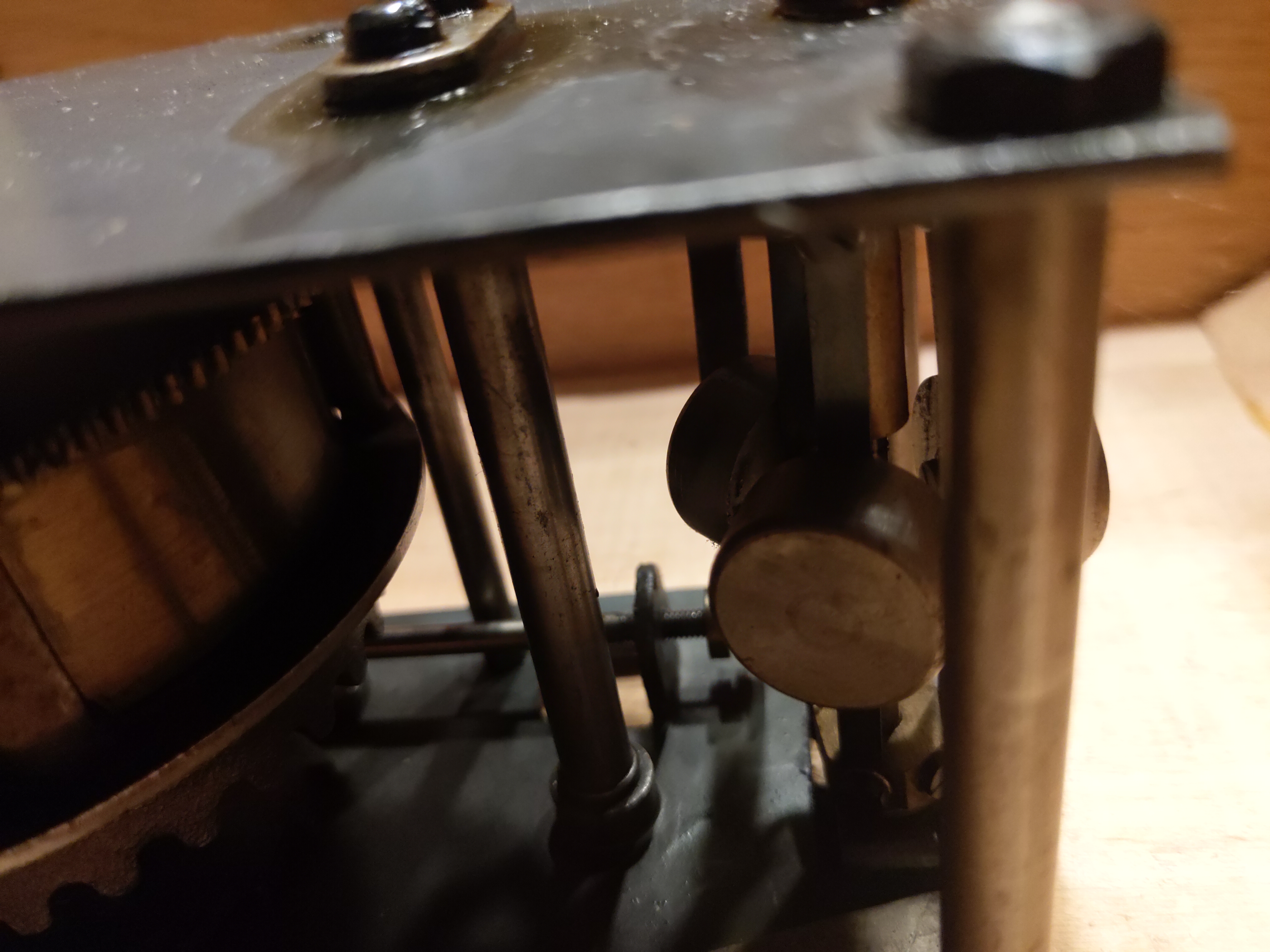

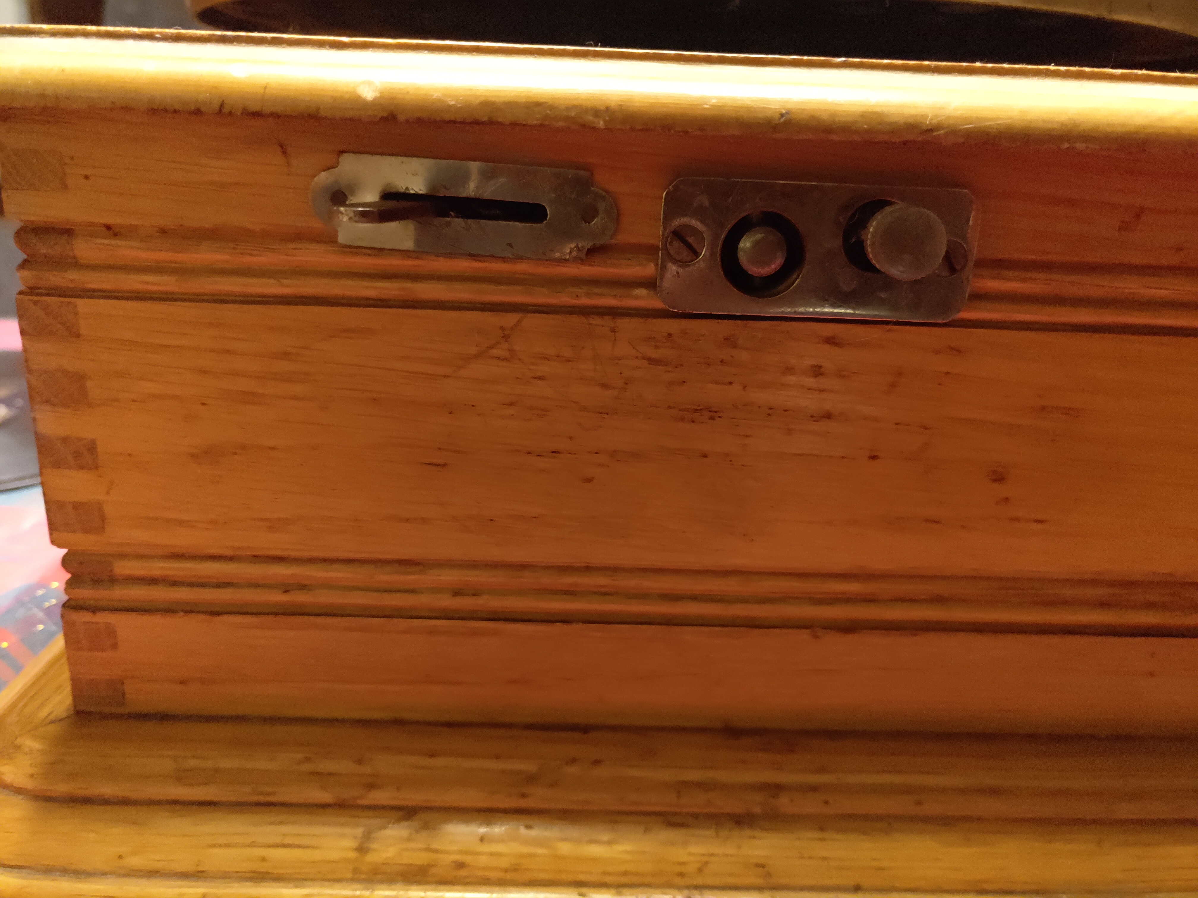

I have today collected the machine, and upload some photos so you can have a look. The elbow has split, but there are no further damage to the horn. The elbow must have been glued to the horn in the past, and rust around the connection to the bracket have disallowed the horn to be moved sideways, and adding too much force have broken the elbow. I don't have any spare elbows of this size, so when looking at the elbow, I feel the best solution will be to remove all the rust, before gluing the elbow, and if necessary add some epoxy at some minor areas. If someone have better ideas of repairing the elbow, then of course please state your opinion...
The motor is an original Excelsior Werke motor, I recognize it from another Excelsior machine showed in this thread:viewtopic.php?f=11&t=41477&p=246460&hil ... or#p246460
I add many detailed photos, for reference, since Excelsior machines are not that often shown on the forum.
