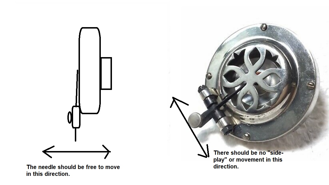

I agree with Marco. If it's not the needle causing the distortion, it's the sound box (reproducer). I've listened to a couple of restored 109a's and they sound more like a small electrically amplified gramophone than an acoustic one, so investing a little time or money to have the sound box overhauled is a good investment.
IF the sound box has already been overhauled with fresh gaskets, etc., then you might check the adjustment of the needle-bar pivots. The needle bar should be free to track the record's groove, but there should be no side-play. This simple illustration shows what I mean: HTH,
OrthoFan

As far as I know, the gramophone hasn't been overhauled or maintained since it left the factory.OrthoFan wrote: Mon Oct 25, 2021 11:37 am I agree with Marco. If it's not the needle causing the distortion, it's the sound box (reproducer). I've listened to a couple of restored 109a's and they sound more like a small electrically amplified gramophone than an acoustic one, so investing a little time or money to have the sound box overhauled is a good investment.
HTH,
OrthoFan

- Posts: 4652
Re: Columbia 109a sounds distorted
Then one advice: if you do it yourself, I wouldn't disassemble the needlebar from its fulcrum unless absolutely necessary. It's very tricky to reassemble, as the pivots at both sides rest on 5 or 6 tiny bearing balls each, then adjusted with a screw pivot and a nut, which you can see at each side. This is the most difficult part to adjust. If you look under a strong light, through the small gap at each end you could even see the balls inside. This only needs a drop of oil, and if too much side to side play, loosen the nuts and moving slightly the screws until there is no play, but still the needlebar is free to oscillate under its own weight when you turn the soundbox up and down. Then readjust the nuts without moving the screws (this is also difficult, you may need three hands, or the soundbox firmly fastened in a vise or something).
