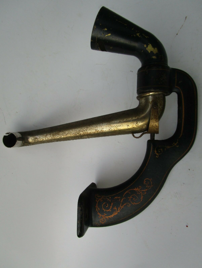

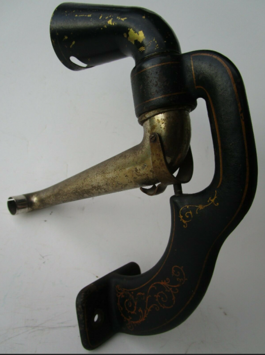

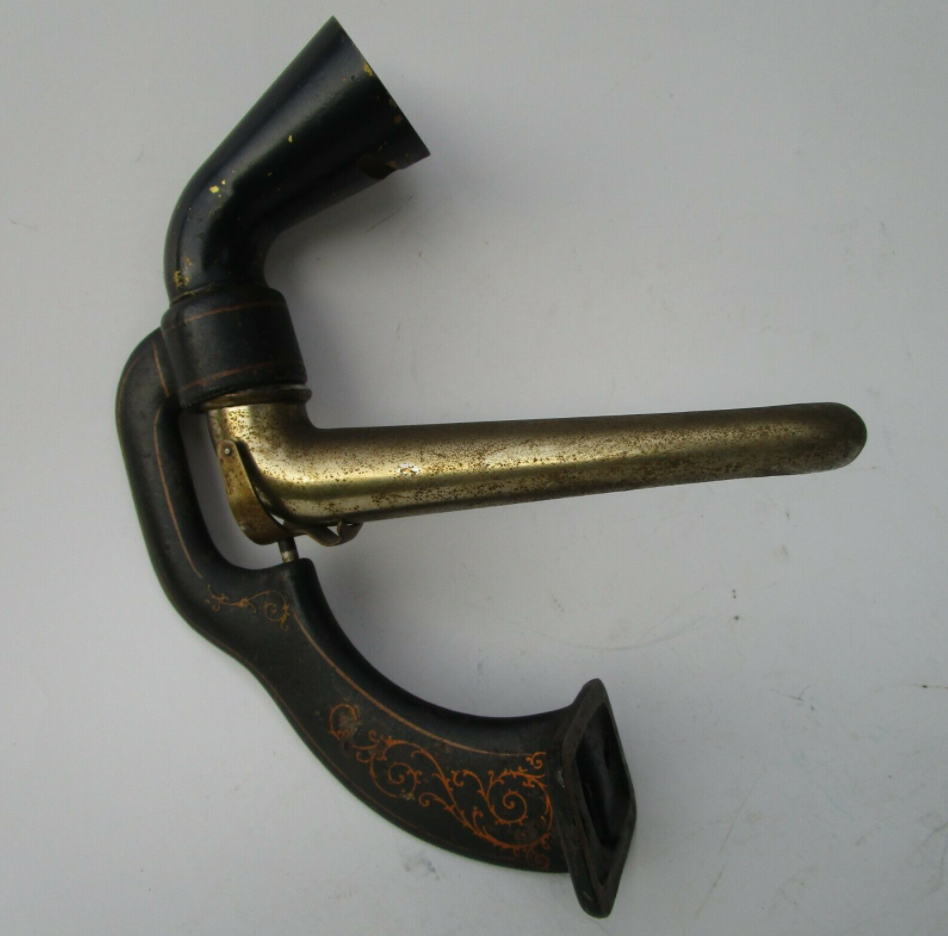

Victor O has no goose neck, but a complete back bracket and tonearm from a Vic. III through VI will work, but it won't be correct for that machine, here are some photos from eBay that are correct, and the completed listing from eBay.

OK , I stand corrected. The photo he sent has that early tone arm with that cradle. I've never seen that type tonearm and thought it was something cobbled up. Guess I'm going to pick up a 0 tomorrow. Thanks guys, I never stop learning something new

I've got a spare Victor O tone arm like the one in Jeff's post.

And then... there is also the arm that has a gooseneck built into the shape of the arm, but solid, with no swivel joint.

Yes, as mentioned there are a few variations of arm and back bracket used during the years the Victor O was in production. So, knowing the prefix letter and serial number may be a big help to the members. Once you get it, i hope you post pics in order to answer your question.
Hopefully Jerry's will be the correct version and problem solved.
By the way, a Victor arm or back brackets for a Vic lll - Vl will not work on a Victor O.
