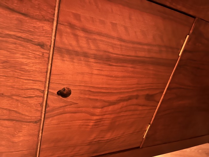

Missing handle for access door on A-450
Post by Josh_boro20 »
On my A-450 I am missing a handle for the back access door. I was curious as to what it looks like and it there are replacements out there. There is a round hole on my machine where it appears to have been one at one time.

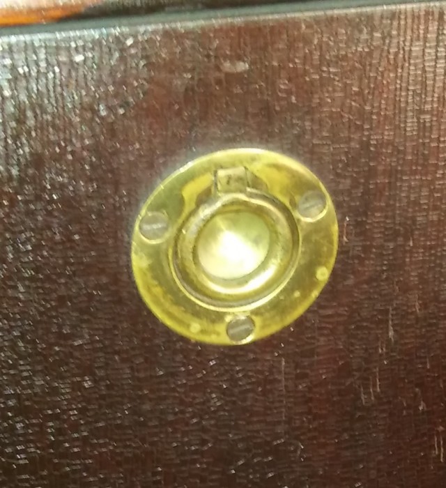

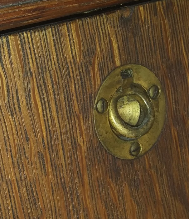

schweg
Posts: 805
Joined: Sun Jan 11, 2009 8:41 pm
Location: okc ok
Re: Missing handle for access door on A-450
Post by schweg »
Here are pics of A 400 and A 250. They appear to be identical
Josh_boro20
Posts: 124
Joined: Tue Oct 29, 2019 11:04 am
Personal Text: Vintage sound
Location: Seattle
Great that is a huge help, one thing I noticed on my machine is that it has the hole for the pull handle, but it doesn’t have any screw holes, I wonder if never had a pull from the beginning?
Posts: 6595
I'm thinking it has new veneer covering up old holes. You'll know when you install a pull handle and the screws go in easily after they break through the veneer layer and drop into existing holes before eventually tightening up.
Another thought... Is the dimple in the bottom of the pocket simply from the centering point of the flat bottom drill that made the pocket, or is it a screw hole? I've seen versions of these pulls that used 1 screw, in the center.
Josh_boro20
Posts: 124
Location: Seattle
Thank for those observations, I took another look and it does appear to be a screw hole in the center. I’m almost positive it’s the original veneer. Do you by chance have a photo of the part with the single screw in the center?
Posts: 6595
Josh_boro20 wrote: Sun Oct 31, 2021 2:37 pm Thank for those observations, I took another look and it does appear to be a screw hole in the center. I’m almost positive it’s the original veneer. Do you by chance have a photo of the part with the single screw in the center?
I have seen the single screw style, but do not have an example to photograph.
