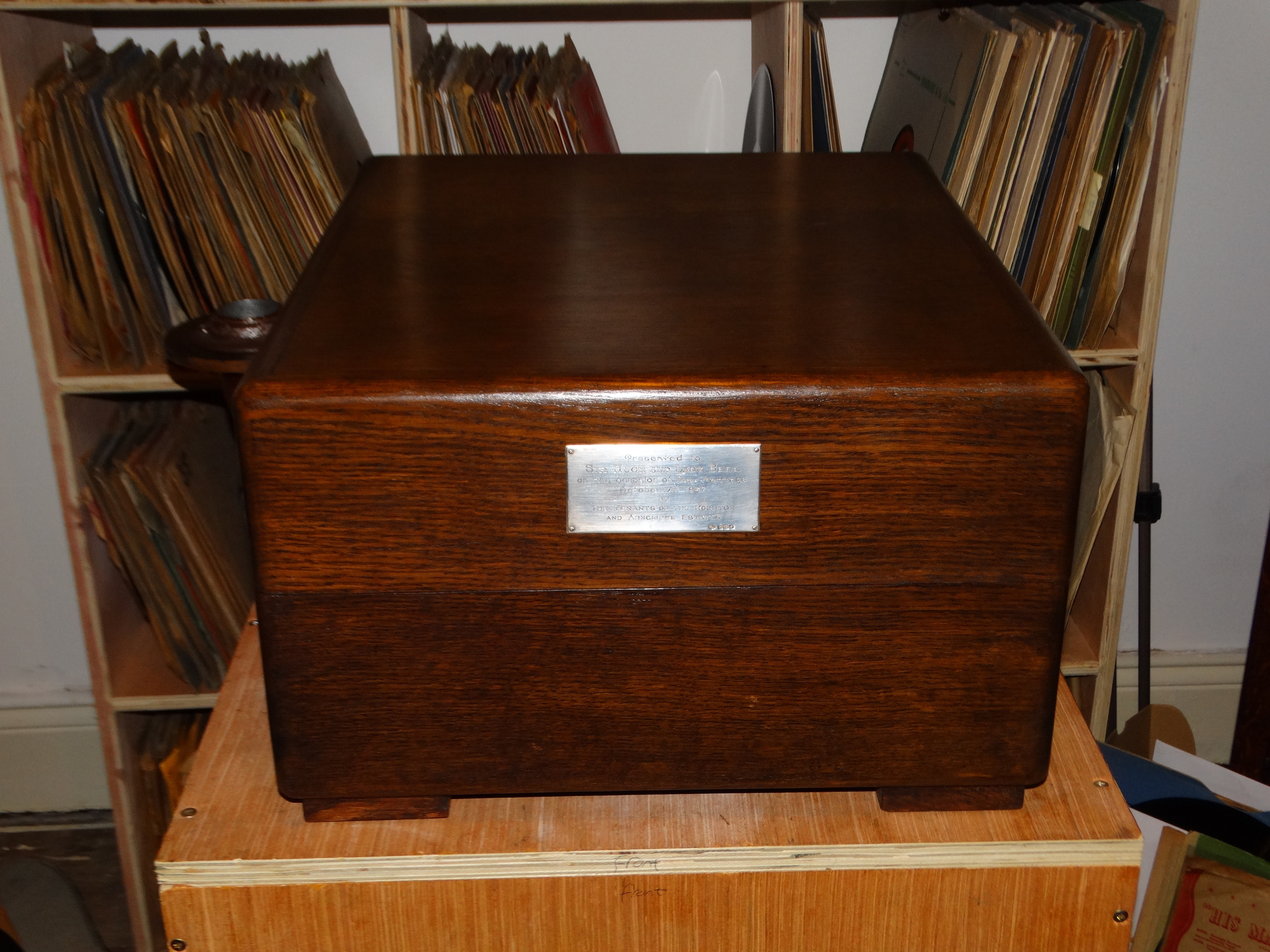

Now that is better!, back to a slightly more appropriate colour, finished in nitrocellulose lacquer as it was originally.
The extra arm rests removed from the motor board, holes filled and tonearm rest returned to the original position.
Now to finish rebuilding the soundbox, I was hoping for parts to arrive today but they didn't, tomorrow possibly

Having felt so sad for that poor machine previously, this is joyous to see - I feel quite emotional! Congratulations yet again Alex!
- Posts: 4653
Re: Twisty horn EMG Mk IX - So, how bad was it?
Looks majestic, sober, elegant... That simple wooden box hiding inside the marvelous 3d sound! Congratulations!
Thanks! In person the colour is much more like the first photo, the flash lightens things slightly, but it is a very pleasing shade.
The tonearm was dry as a bone with stiff ball bearings and no grease packed in to prevent air leaks, I remedied that and last night gave it a quick test with a Meltrope II and it really sounds wonderful, I look forward to getting it’s original soundbox back on it
