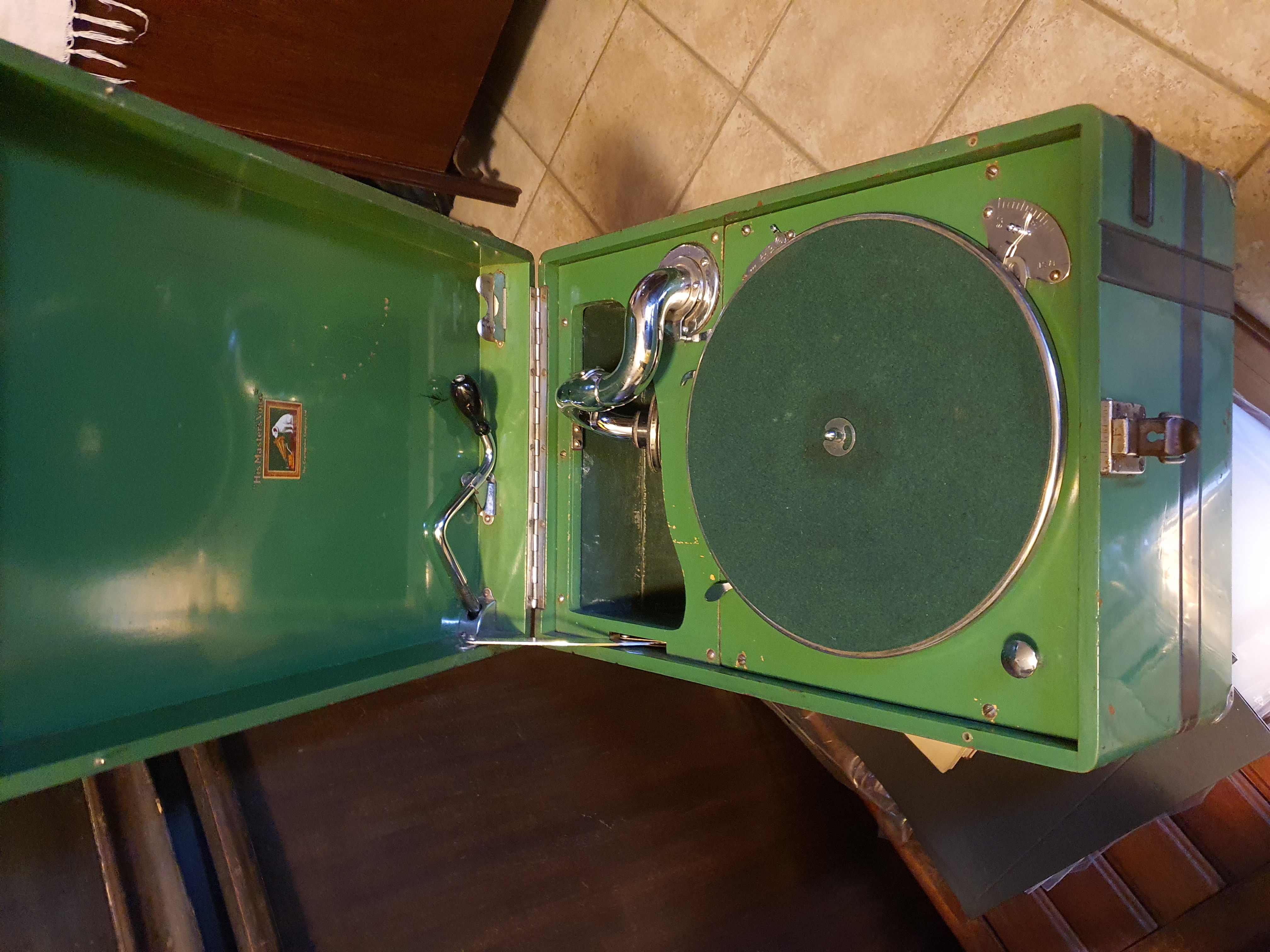

Hello Chunny
I have a colonial with the same pattern, but its original paint is in green, with the black stripes. Maybe yours started its life that way, and was altered to what it looks today.

Re: Colonial HMV ?
I'd love to see pics please.I have a colonial with the same pattern, but its original paint is in green, with the black stripes.

Re: Colonial HMV ?
Here they are. Not identical, but similar. Mine is a model 114, with the larger 32 motor and the deep case .
