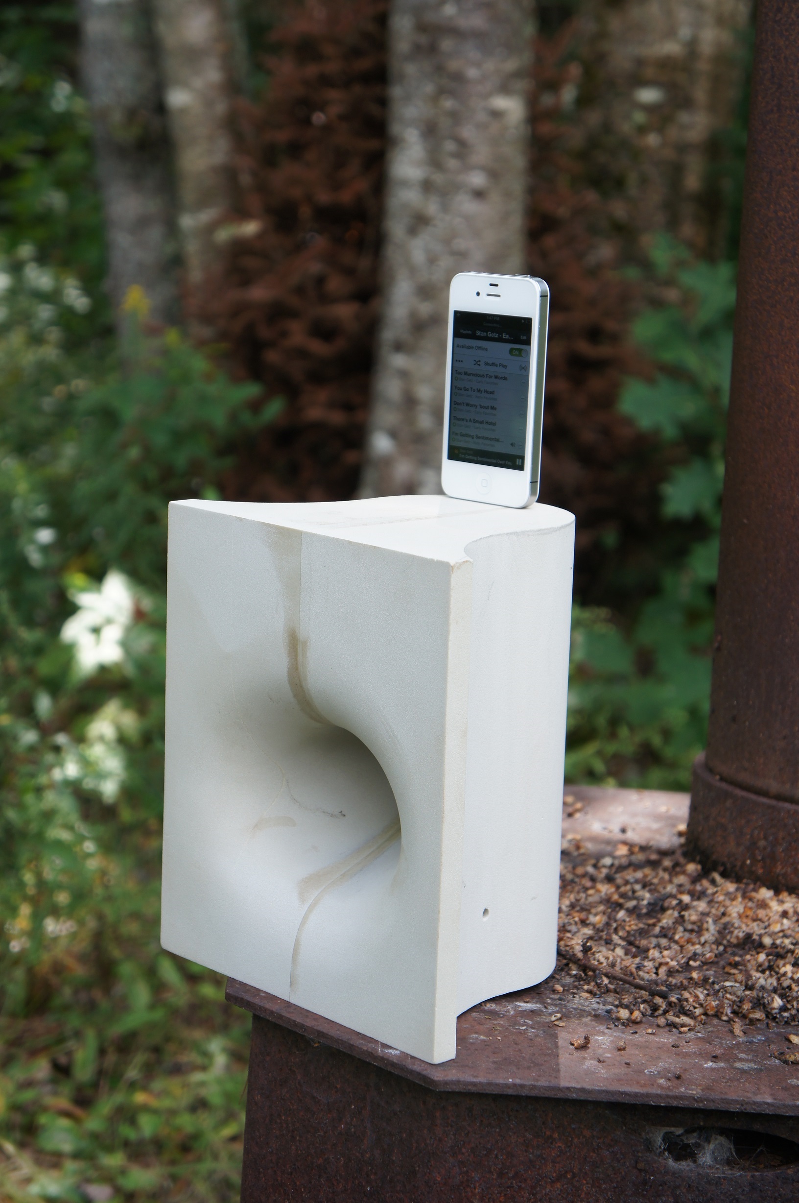

Is that really a Victor replica? I prefer drawings of the originals.
I've attached 2 phone horns I did a while ago.

Bob Baumbach produced the Ampli-Phones. I have one in transparent plastic. The horn is sized to be resonant with the speaker in an early iPhone. Unfortunately, new iPhones don’t fit into the throat, and the speaker output has changed so the balance of the formula would be off.

No problem. No, I'm not interested in making a 3D printed version of the Orthophonic horn. It's much too large, and in that I'm working on a milled version of the Wilson and Webb horn, I've already taken on quite a bit. I'm only interested in seeing and understanding the Victor design. Thank you for the reference however to the phone horn.
