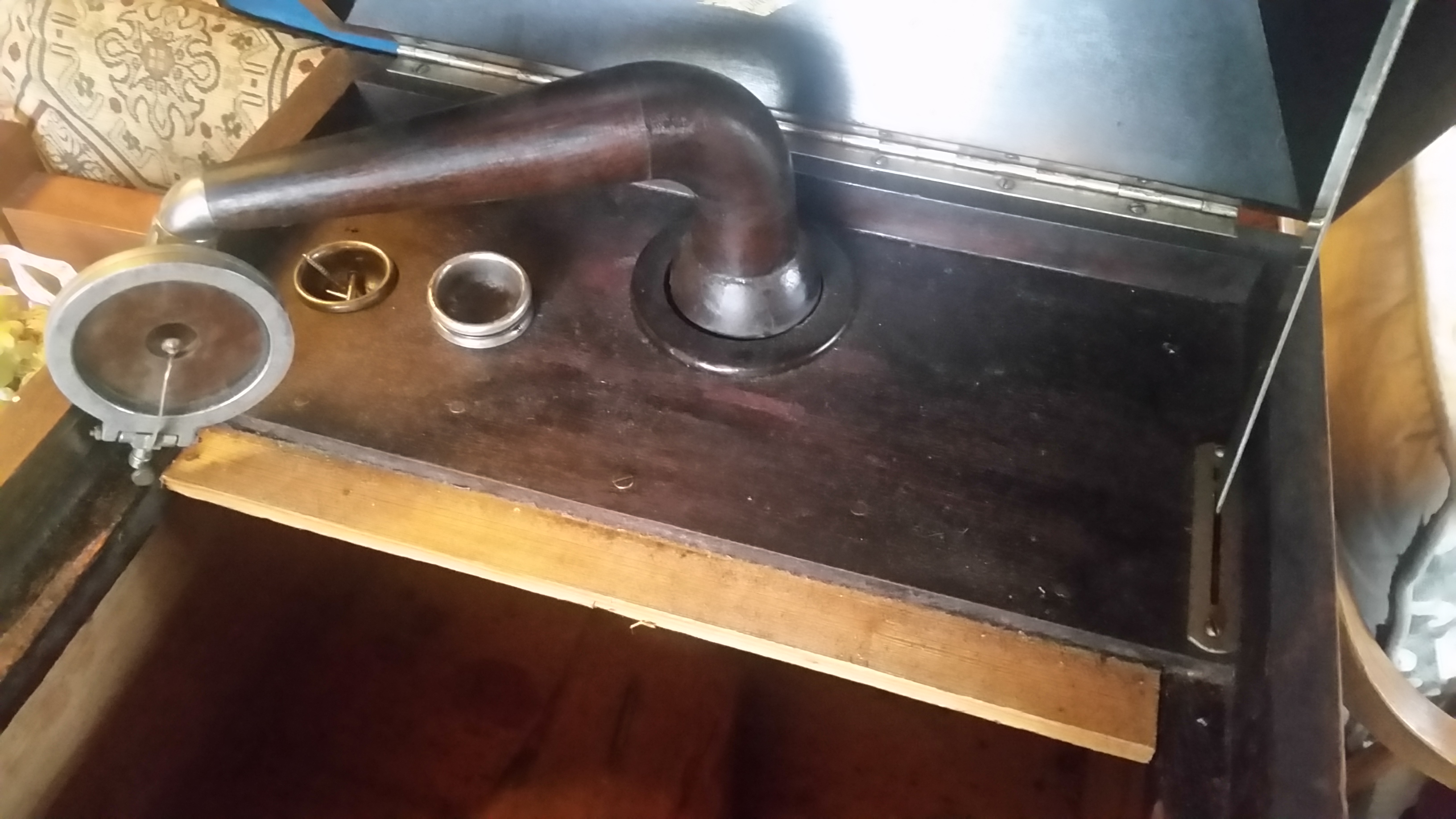

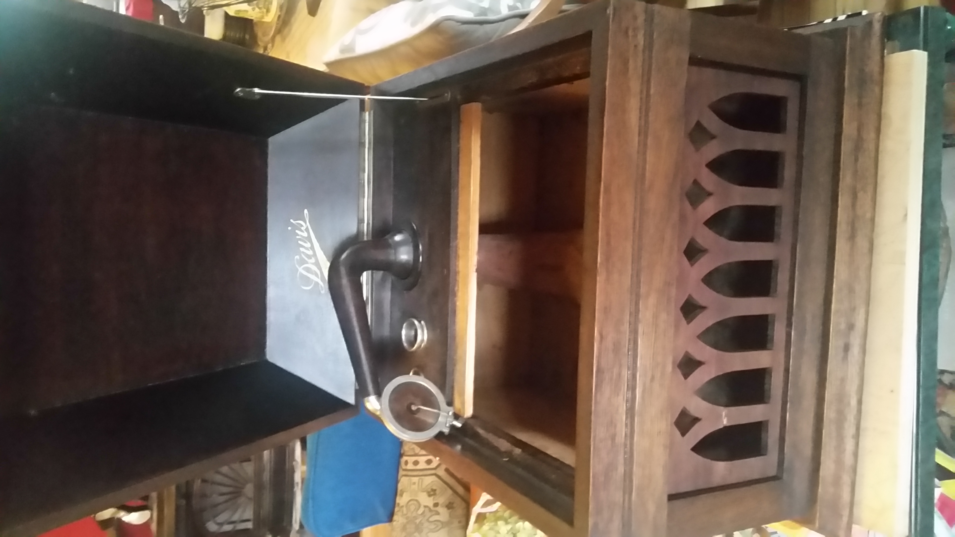

I recently acquired a Davis tabletop machine. The flexible joint connecting the wood tonearm to the papier maché horn seems quite loose. Perhaps whatever seals the connection can be replaced. If so, what is the material, and how is the tonearm removed from the horn? I don't see any obvious connection for tone arm board to the cabinet. It seems to be glued in place. There is a metal ring around the tonearm base, it doesn't seem to turn or lift, and there are no visible screws attaching it.
Any suggestions will be appreciated.

Can the board that the tonearm is mounted to be removed from the main body of the case so you can see the underside?
Alternatively, maybe remove the bottom panel from the case?
The wooden tonearm is a relatively rare animal.
Good luck

The bottom seems integral, probably rests in a dado. The board with the tonearm seems to have been glued in as well, although it may be the hardened finish.
The long section of the tonearm is nicely turned, the 90° segment is 2 pieces. The joints look solid. The tonearm appears to be mahogany, the case/cabinet may be a mix of oak, and probably some chestnut finished to look like oak. I recall reading much of the "Golden Oak" furniture was actually chestnut.
I may try gently prying the ring around the tonearm base to see if it releases the tonearm. My concern though is that I may damage the throat of the horn.

TN Allen wrote: Sun Nov 28, 2021 4:50 pm The bottom seems integral, probably rests in a dado. The board with the tonearm seems to have been glued in as well, although it may be the hardened finish.
l wouldn't recommend prying prying on that ring. In the photo it looks as though there's several screws attaching the board to the cabinet.

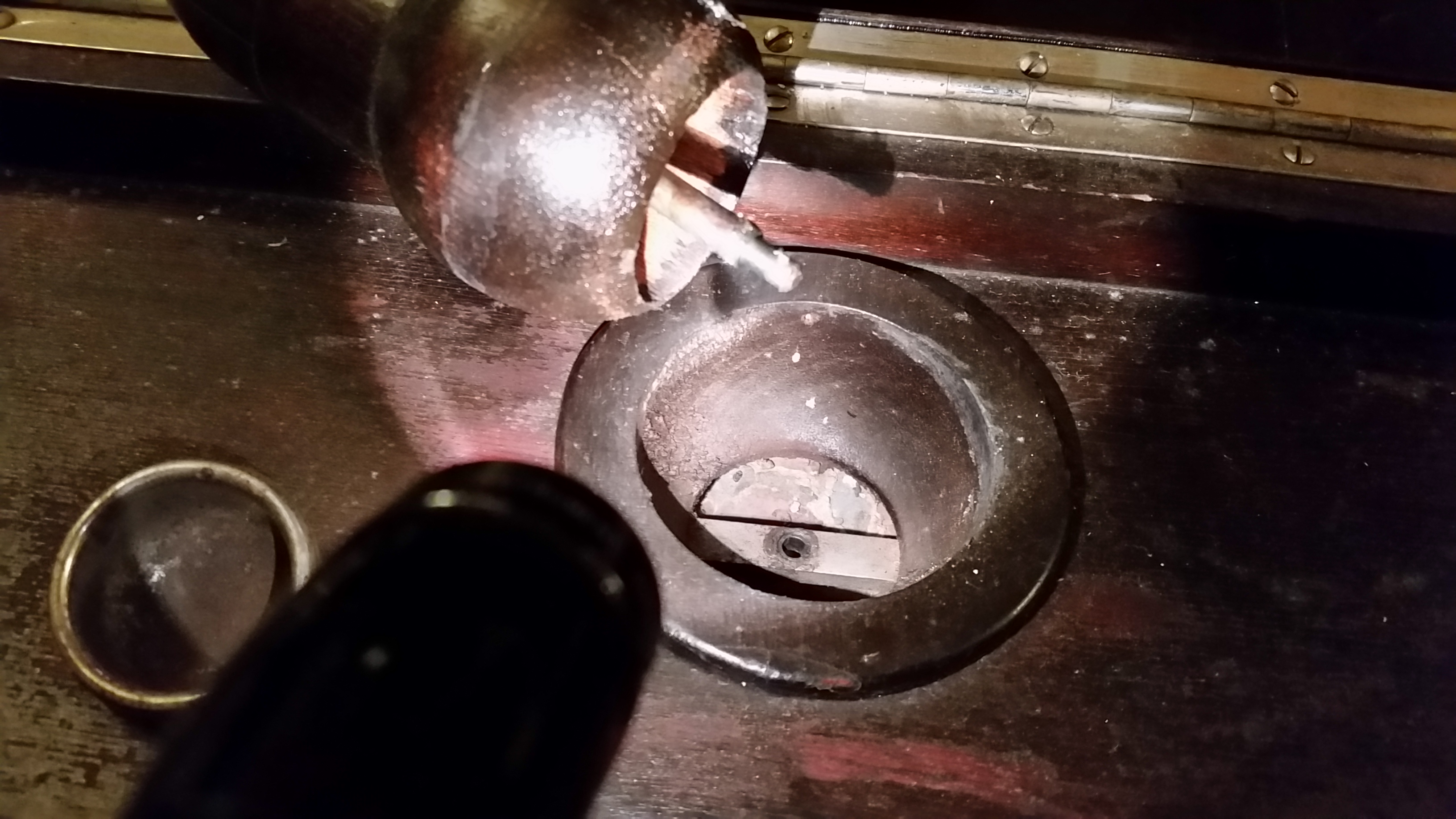

The Davis people were clever, their retention system is simple, and with a little trial and error, and an intuitive sense, the mystery is solved.
Turning the tonearm to about 3:00 on an imaginary "clock face" aligns a key on the tonearm retention stem with a keyway in the bar that holds the tonearm in place. I've attached a photo, sadly not done in good light.
The system doesn't seal the tonearm pivot well to the horn below. I thought there might be a better seal. The concave ring the convex base of the tonearm turns in seems to be glued solidly to the papier maché horn.
I'll probably clean up the mahogany and oil it, perhaps what this machine may lack in sound quality will be overlooked in considering the nice wooden tonearm.

There must be any kind of grease that holds up well with wooden parts, not being absorbed. Old wooden gear clocks and horse carts wheels and axes do use something. Maybe it's not wet grease, but some kind of powder as talcum or graphite... You only need one that greases the junction and is thick enough to seal the air leaks.

Try a tallow-and-beeswax mixture to seal this.
Or you could make something from wool felt soaked in beeswax that would serve as an air-seal, then maybe use vaseline as a sealant?
