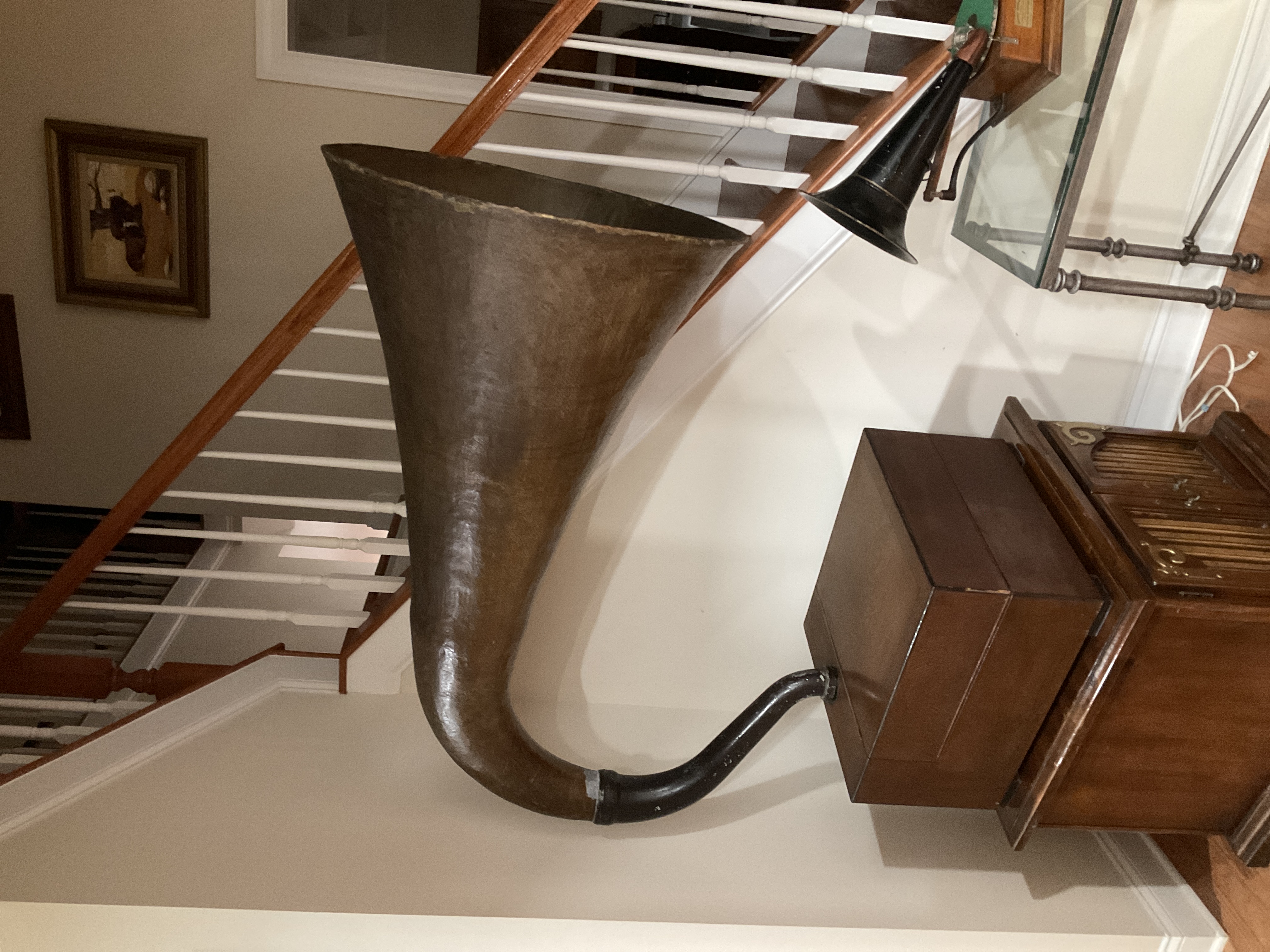

How do we identify what model EMG this is? The address on one of the labels under the lid is: 11 Grape St, London, but we can’t find any tag stating a specific model number. The horn bell is about 30 inches in diameter and it has an electric motor.
emgcr
Posts: 1205
Location: Hampshire, England.
Re: E.M.G Davey Mark numbers
Post by emgcr »
That is a very nice Xb. It is possible you will find a number stamped into the wooden deck-board underneath the turntable. However, if the original specification used a wind-up spring motor, the number can sometimes get lost when conversion to electric operation was carried out. EMG were at 11 Grape Street from 1929 to 10th April 1948. Do you know the history of this instrument ? It would be good to have photographs under the lid.
Orchorsol
Posts: 1831
Location: Dover, UK
Post by Orchorsol »
Always wonderful to see another EMG! The details are on page 112 (PDF page 125) of "The EMG Story" kindly reproduced by Chunny on his website by permission of Frank James's family: http://www.gramophonemuseum.com/images/ ... ory%20.pdf
