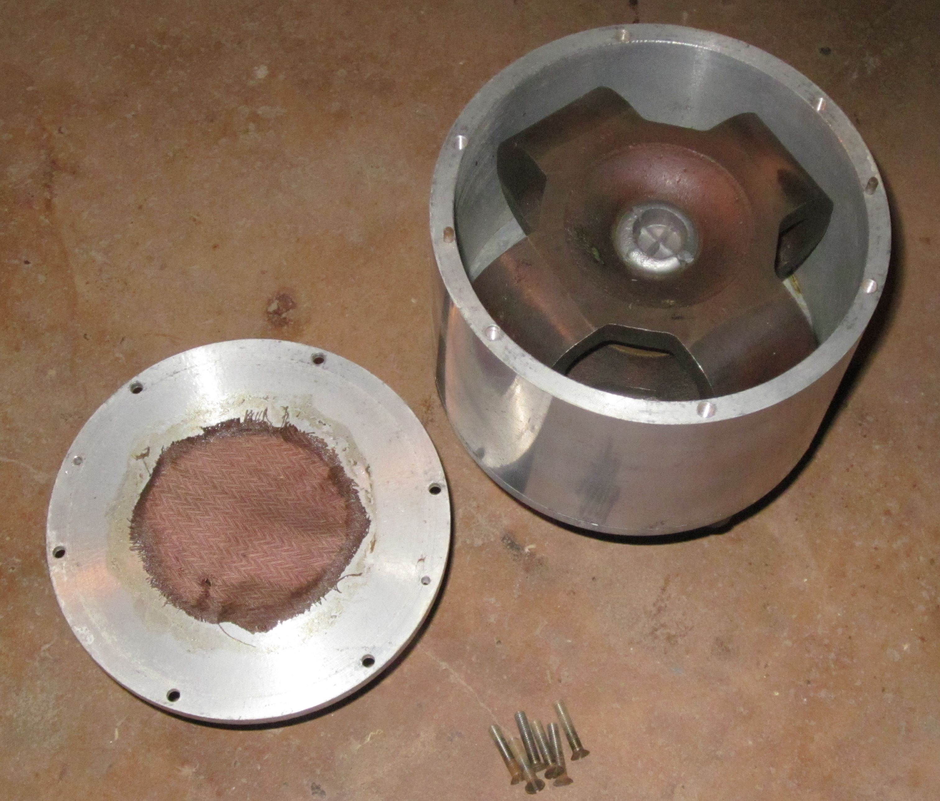

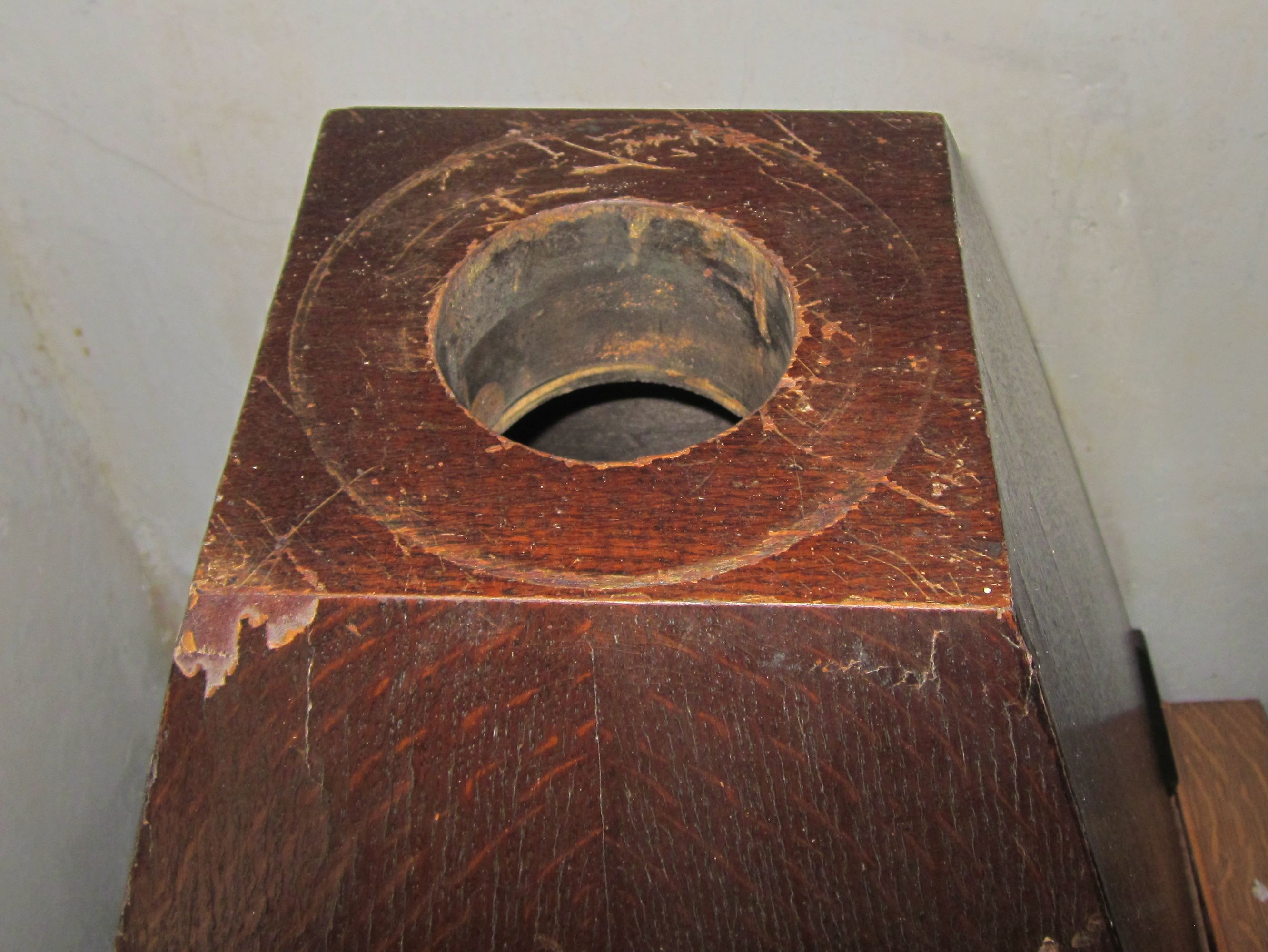

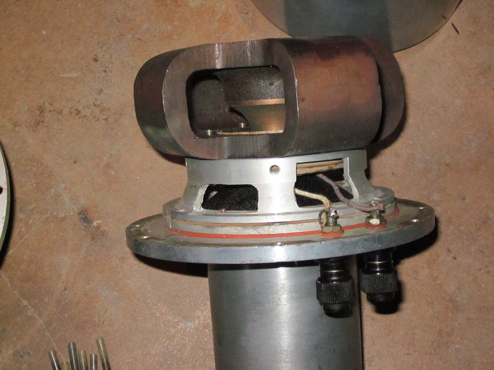

I assume this speaker had a gasket or some resilient flange between the driver and its pyramidal wooden stand. The hole in the stand measures 5-7/16", the driver 5-⅛" so the fit is quite sloppy- not at all like the old post card photo! The driver appears to have been "ported" through the hollow pyramid so something close to an airtight seal was probably intended, but then EMG-Expert people will know far better than I and, I hope, be able to describe the missing gasket.

I imagine the stand was used with a smaller horn and just for connecting up to a radio. An Expert Junior or Senior horn would be far too big. I am confused at the size of the hole, 5-7/16". The Expert Senior horn slides into a ~ 3-½" hole.

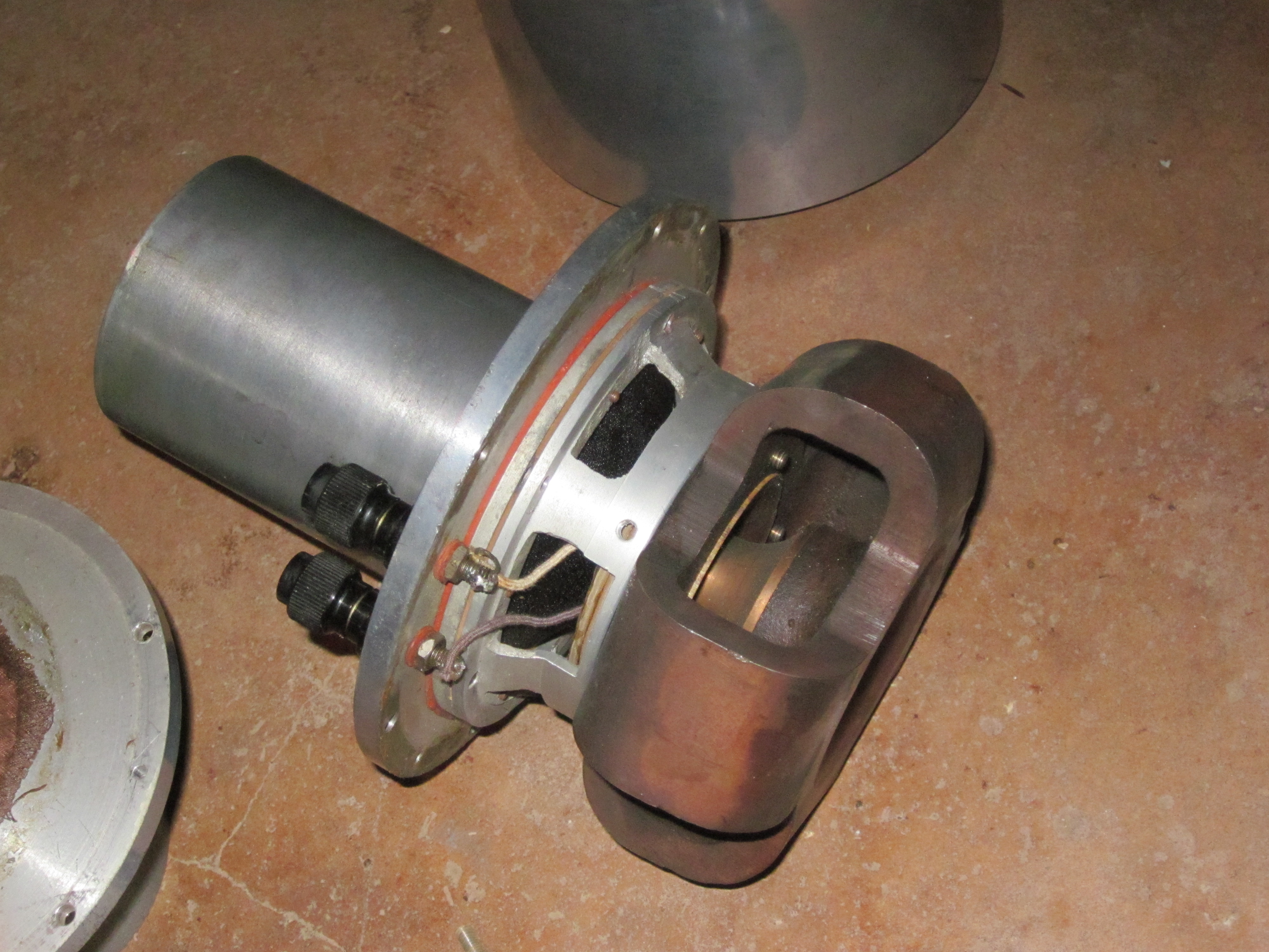

It does work- not much to go wrong I would think though some letters accompanying it suggest the original owner had some sort of trouble. As you suggest, a smaller horn might make more sense but in fact it came with the Senior horn in place which leans forward a good deal more than the old photo shows. Maybe Mr. Ginn employed the 1930 equivalent of Photoshop.
Since these things don't seem terribly common I thought you might like a few more pictures.
-Dave
-Dave

Very embarrassing! Substitute "3" for the "5" in the dimensions I gave. My combination of myopia and stupidity can create mysteries where none should be. In another piece of stupidity it seems never to have occurred to me to investigate what is obviously a British patent number; Ginn or Phillips explanation of the rear port on the driver should make interesting reading. Apropos of that, Chunny's old photos are a little confusing. The driver on the HMV is straightforward enough- its case may plausibly be either sealed or open, but placing the driver on an Expert gramophone as shown in the other picture would vent the back of the speaker into the tone arm and sound box (at least if the case is open in back as mine is). I can't claim to have tried this arrangement, but I'm not really tempted.

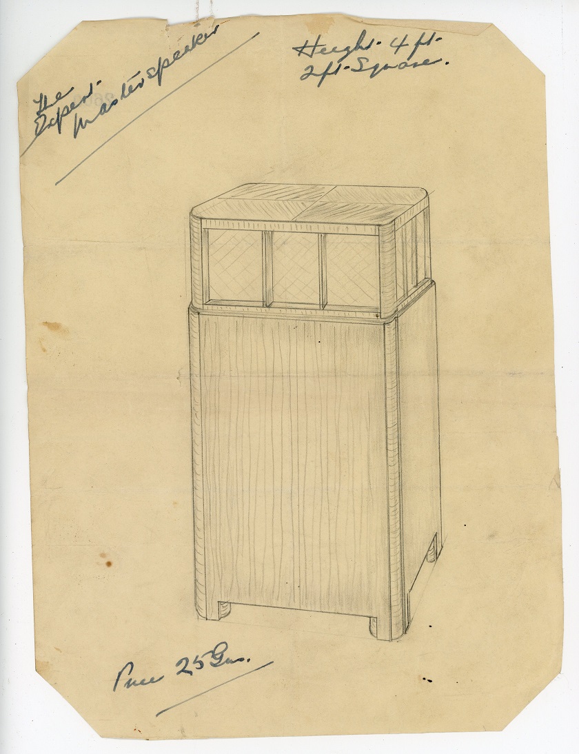

In answer to other questions: (1) I'll be happy to provide measurements but I'm guessing that they may not now be necessary with my "3" for "5" corrections. Let me know. (2) I am in the northeast USA. (3) More paperwork- interesting to see how courteous and personal was the attention Ginn gave his customers. The speaker design shown was new to me- do any of these exist? Modern enthusiasts might find Ginn's comments concerning horns a bit heretical.
