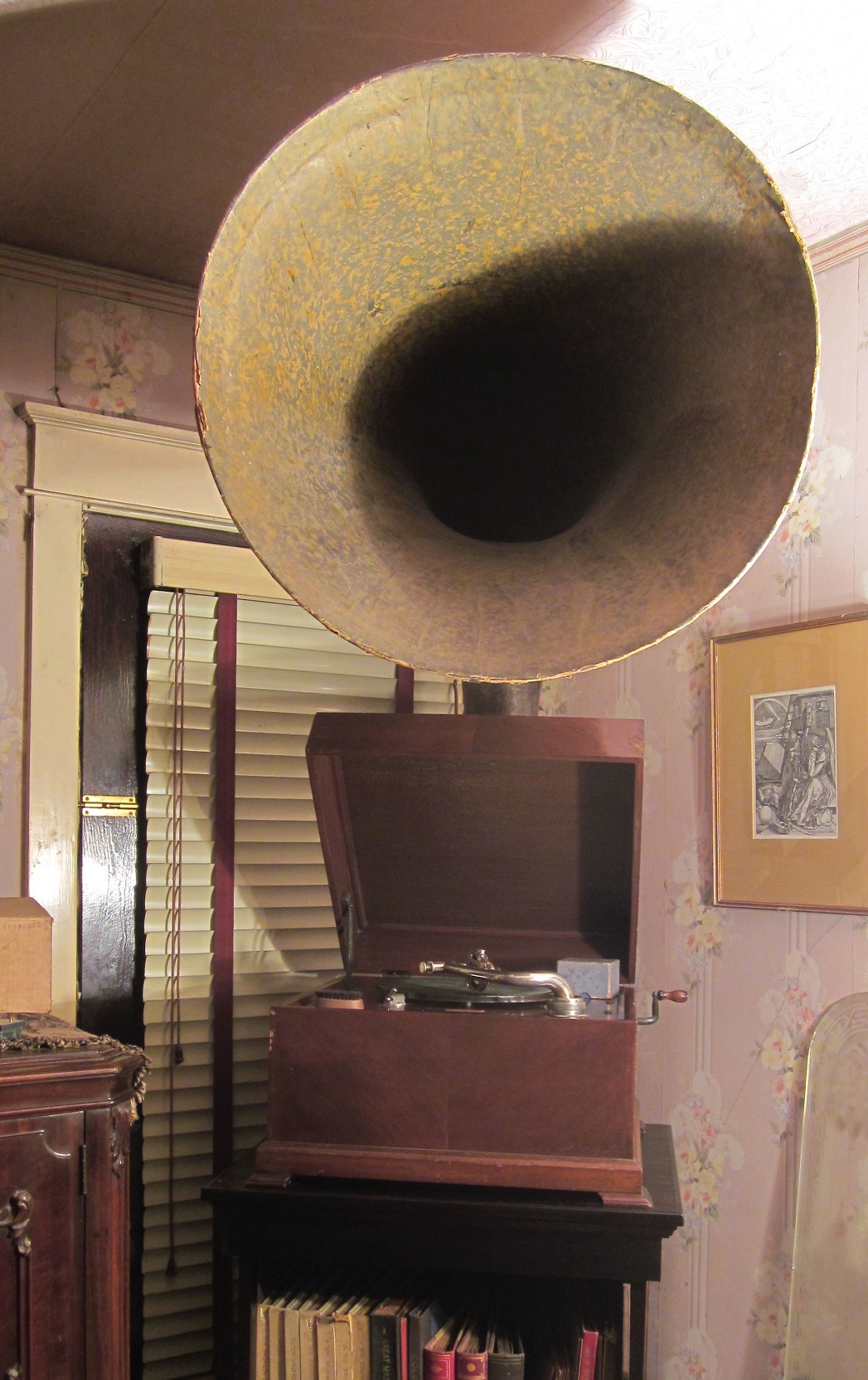

Very many thanks Dave for all these inputs which are hugely appreciated. May we be allowed the privilege and treat of seeing your Expert Senior please ?

Thanks for all the kind words. Am I correct in assuming the "Rathbone Place" address suggests my gramophone was made very shortly after Ginn's "departure" from EMG- 1930 or 1931?
It's a little surprising that one of the two horns has a sort of varnish over the paper while the other has no coating of any kind. The varnished horn is easy to keep clean but I've had to be satisfied with gentle dusting of the other-
so pardon its dusty appearance in the pictures. Of course in this it matches the rest of the house so I shouldn't complain.
It has the four-spring sound box and Paillard spring motor.
-Dave

Very many thanks and it is wonderful to have discovered the existance and whereabouts of another magnificent instrument. Your comments about the varnish finish on one of the horns is interesting. This could have been done by initial request when new or, perhaps more likely, by a subsequent owner---we shall never know. Are we talking about just the exterior or is the interior also varnished ? In my experience it is not a good idea to have a bright surface on the inside as this tends to encourage odd reflections adversly affecting sound reproduction quality. If one is varnished internally, do you notice any difference in the comparative sound ? Presumably the horns are interchangable ? This was not always the case for some strange reason as I have come across one bronze spigot with a larger diameter than the usual size ! However, the securing threads are the same so it is possible to unscrew and swap around.
Ginn was located at 55 Rathbone Place from inception of the new business in June 1930 until 1933. He relocated to 10A Soho Square between 1933 and 1936 and then moved to 64 Frith Street from 1936 to 1939. Unlike EMG, I am afraid he did not use stamped production numbers so we cannot narrow the dating further than that. The thought is that he did not want to draw attention to just how young the firm was ! My own Senior has no badge at all and has the number 2 (probably a workshop number) stamped into the underside of the tonearm flange but maybe suggesting the possibility of being an early model---also with Paillard GGR 255 spring motor. Additionally, mine does not have a tonearm rest. I see yours is similar which might also point to early production ?
