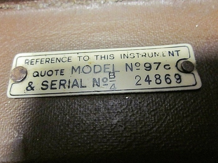

The HMV97 was catalogued in Black, Blue, Green and Red but never Brown, yet here is one described as such.
What makes me suspicious is that the seller has posted 12 pictures, none of which show the HMV transfer.
If the machine has been repainted it has been done quite well. What do others think?
HMV97c in Brown on UK eBay. Really?

It hasn't been painted but where's the winding handle clip vanished to? Note they are using a tungstyle needle tin clip to secure it! That's suspiciously the same location as the 102 lid clip.
It looks to me as though the horn opening has been rather crudely lined with rexine and there appears to be a horizontal crease across the rexine in the lid. Also note how crudely the cloth has been cut around the motorboard apertures. It looks to me as though the ivorine plaque has been refitted too; one of the nail heads is significantly bigger than the other. I'd ask for a photo of the lid inside.
I think the whole thing has been recovered possibly but certainly not in recent years. It has plenty of age to it. Without a picture of the lid I wouldn't touch it though. That is unless I was desperate for another Meltrope III soundbox!

It looks as though a piece of the covering material has been stuck over the internal base of the lid, and then the whole thing has been re-painted. The internal horn opening should be painted card, and not covered with material, as this one seems to be, and the outer covering on the lid appears to be very cracked. Given all that, plus the absence of the handle storage clip, possibly the HMV trademark, and the substitution of the proper soundbox with one of those 'orrible (only my opinion!) Meltrope 111s, I agree with Steve, and wouldn't touch it.

Yes, if I was interested in bidding I would certainly want to see more of what is inside the lid.
The 97 winding handle clip should be inside the horn mouth on the left, but it appears to be missing.
I have yet to see a 97 with a Tungstyle needle clip as original equipment.
Nothing wrong with a Meltrope III soundbox. A good one will outperform anything this side of an EMG or Expert.
