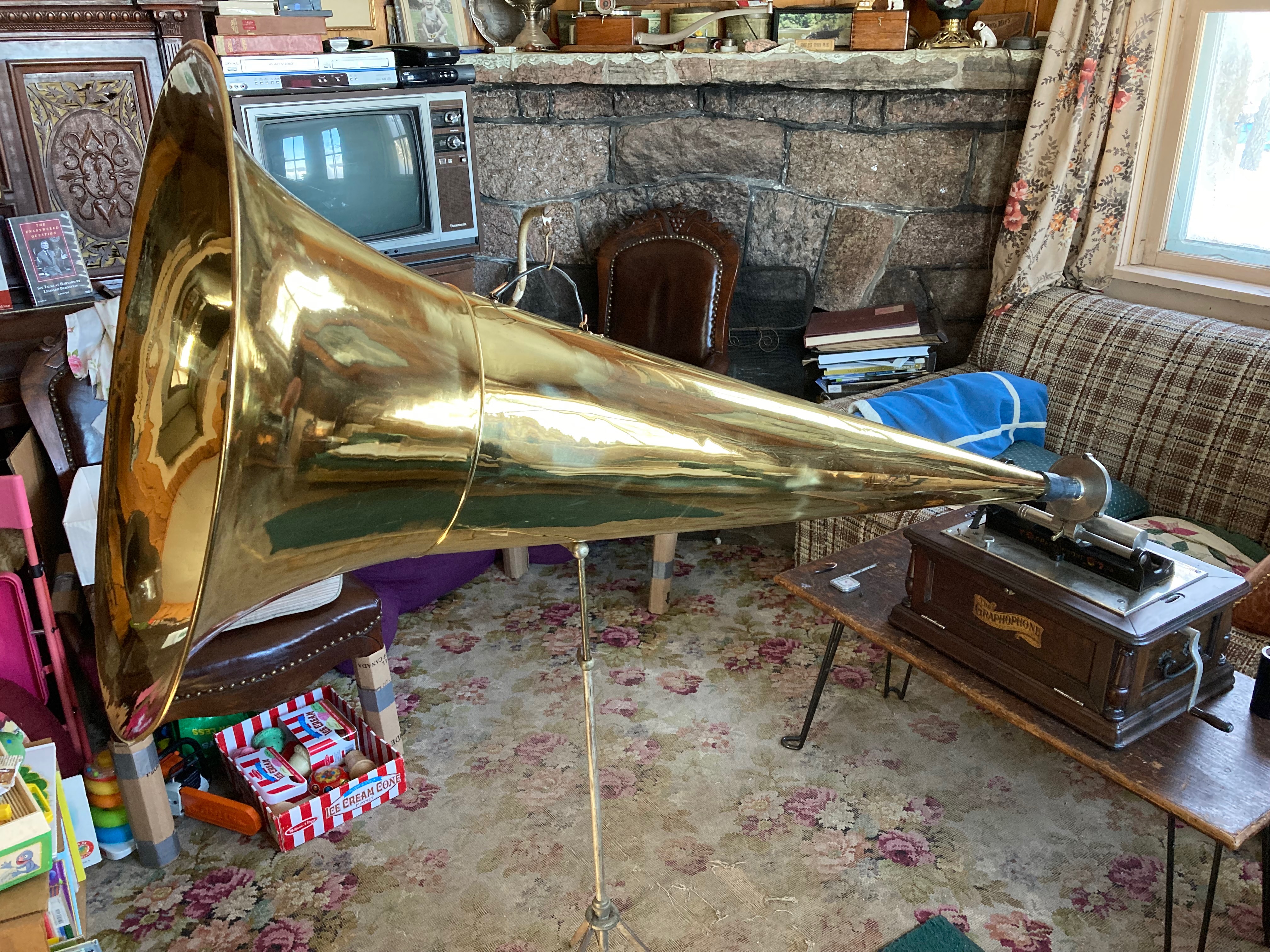

I have been fortunate to work with a friend to restore his Columbia BC with a Higham reproducer. The easy part was the horn. Constantly amazed at the workings of the Higham reproducer and we knew enough to not touch it. The end result was a beautiful playing machine but not quite as loud as we expected as we learned in the printed page that Lee sent. The machine is a 2 & 4 minute model and plays both the Columbia indestructible 2 & 4 minute cylinders with a universal stylus. We had no information to work with and really appreciate getting the instruction manual and the letter. We will leave the reproducer well enough alone. I know the individuals that work on this model and can appreciate the talent they must have to restore the reproducer. I will post a video on the CAPS Facebook page so please follow.
