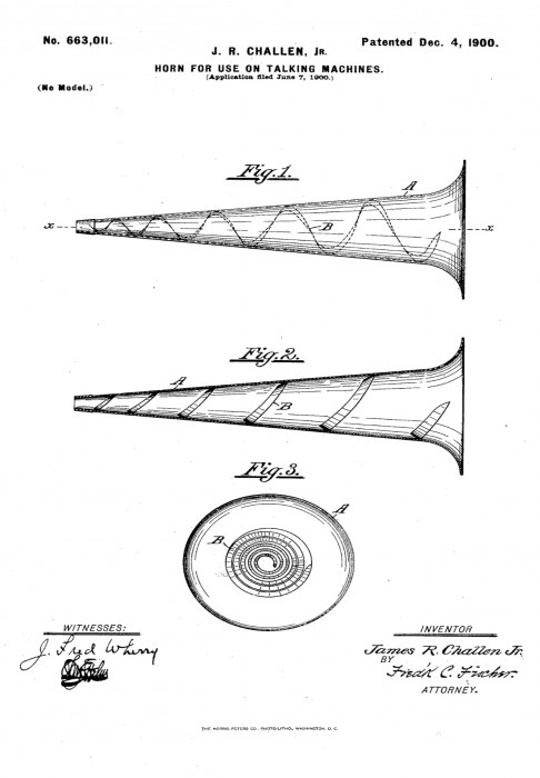

663011 Horn with internal volute
JohnM
Posts: 3190
Location: Jerome, Arizona
Post by JohnM »
Horn with internal volute.
Marco Gilardetti
Posts: 1515
Location: Italy
Re: Horn with internal volute
Post by Marco Gilardetti »
This is not trivial. If done with brain, by obstructing the throat of the horn from view, it may have the effect of increasing manyfolds the length of the horn.
