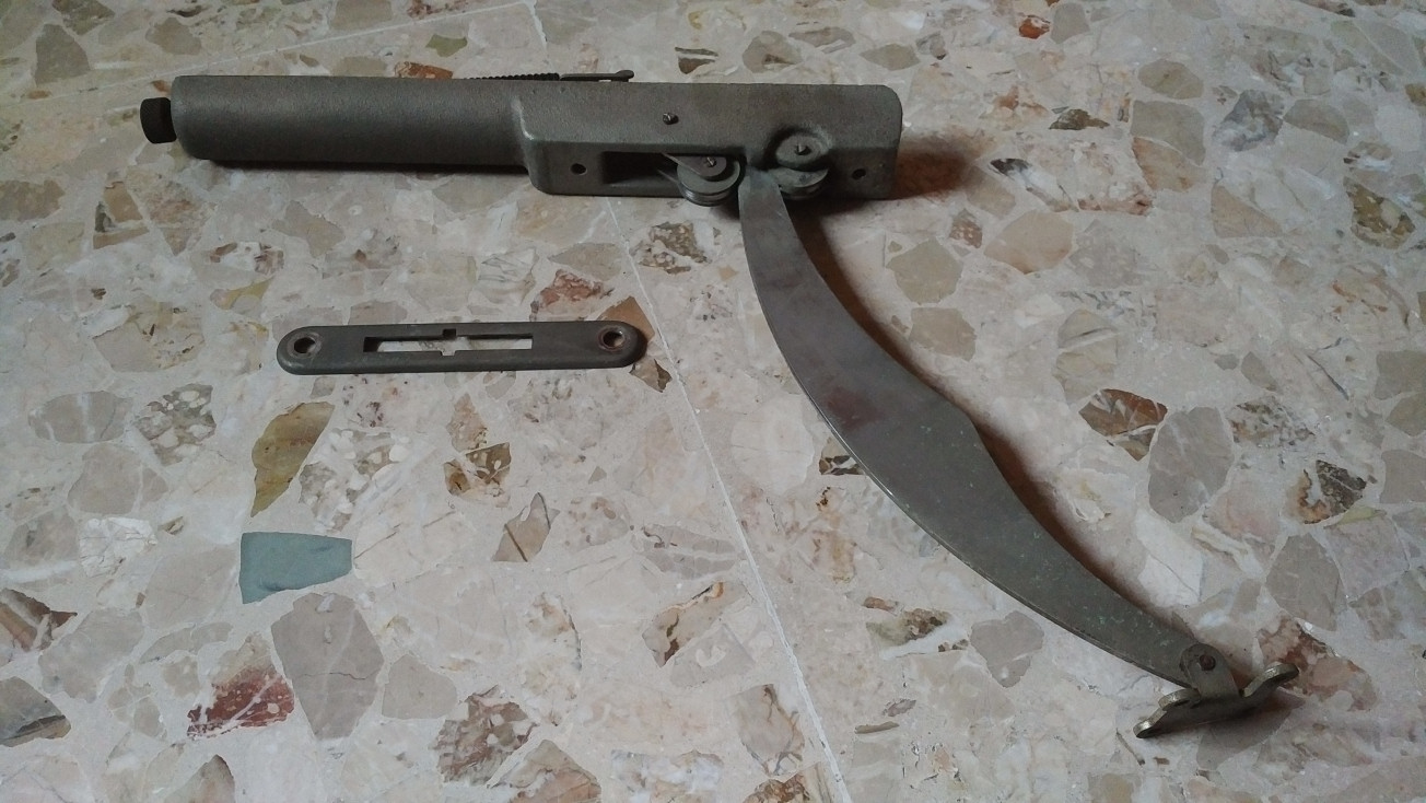

While we talk of 163s - a question to present and past owners of this or similar models. I have disassembled the lid support, which I will try to polish (not an easy task, it seems - it's heavily tarnished and I wonder why). Is there some special care that has to be taken with this part? What has to be lubricated? Only the axles of the rollers? Do you also put a bit of oil/grease on the "rails" of the support bar? Or by doing so would it then slip over the rollers, rather than spinning them?

The cranks and estucheons on both my 127 and 194 are lacquered in brown, i believe it was called antique bronze finish or something alike.
The lid stay must ride on the rollers, not slide on them. Do you should clean the lid stay and oil only the rollers bearings.
Mine in the 127 works so .. so .. and in fact the stay slides and gets dirty of metal powder from the rollers riding surfaces... But that's another story. It shouldn't slide. I'm trying to adjust it properly.
But imho this arrangement is not good. In my 194 the rollers are perfect and roll well, but I cannot avoid the metal powder and it gets dirty, so if you touch it, it stains your hands. This rolling of metal against metal doesn't work too well...

Maybe you don't need to replace it, but carefully reshape it if you notice it's a bit tired, or clearly out of shape... Its three legs must lie flat on their feet on the lever they are supposed to press.
And these upper parts must be cleaned free of any oil! The spring washer and the lever must move at any slight movement of the tonearm to the right. Oil must be avoided in the parts working by friction!
