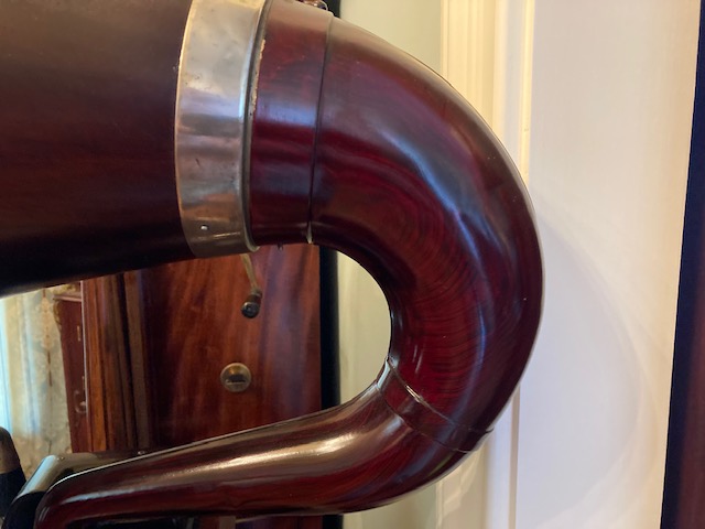

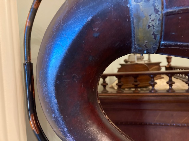

Hi KCW, If you are still needing to have your elbow repainted, its really not too difficult, I repainted a mahogany elbow a few years back that really turned out good, once the old paint is off , just prime the metal then paint it the lighter tone first then the darker next letting some of the base color come through. You can practice on a scrap first . Have Sherwin Williams or a true paint store help you with your base and topcoat colors to match your horn bell and to the sheen you desire. If you've got an original, I wouldn't replace it with a reproduction. Here is a picture of a repainted then an original elbow. You could also ask at Sherwin Williams for a painter that does wood effect on entry doors Good Luck

Thanks for sending this! That really does look incredible!
