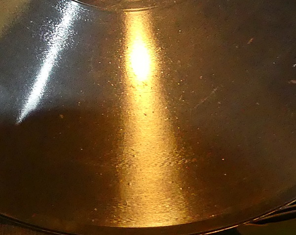

If they've been damp regularly for years, there's a good chance they are damaged. Look at the disks at an angle in good light; if you see what looks like the little bumps in the photo below, then humidity has injured the surface, and playback will be moderately to extremely crackly/noisy. The situation you describe is potentially worse, because the moisture was consistently coming from one edge; in such cases, not infrequently maybe half the record surface will be affected, the other not, or not nearly as badly, and the result will be alternating lots of and little noise with each revolution, making for annoying listening. The blebs aren't always obvious to the eye unless you hold the record to the light just right--it took me around 8 shots to get them to show in the photo--but they will be painfully obvious in playback.
Incidentally, a question for the group at large: are you seeing more of this sort of thing than you used to? I've been weeding a LOT of duplicates in a couple of large collections that have come my way, and in the process I feel as if I've been encountering a surprising number of records with humidity issues, both there and lurking previously unnoticed in my own existing holdings. I'll freely grant that I may not have been sensitized to the issue until more recent years, but could it be that shellac record material, after a century or thereabouts, is starting to reach the end of its useful chemical lifespan (i.e., doing a "pot metal" on us)? I certainly hope not!

I have not found any disks, yet, that are not recoverable. There are no bumps found (thanks for the informative pic) There is a mild fungal bloom in some small areas near the edge on some disks where they were close to the dampness. I have cleaned this off the disks, but some damage to the surface remains. The disks so far are generally in good shape, relative to their age and usage history. The grandfather of the man who gave them to me looked after them but played them a lot. Some disks look like NOS - bright and glossy, nary a scratch or scuff to be seen. There is noise from them, but I think it is the noise of love. I have disks that I have payed good money for, rated VG+/E by vendors, that sound worse. LOL.
I love nice clean 78s with pristine sound, but noise doesn't bother me. It is not what I listen to. :D
