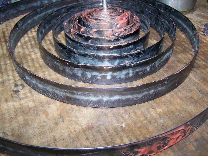

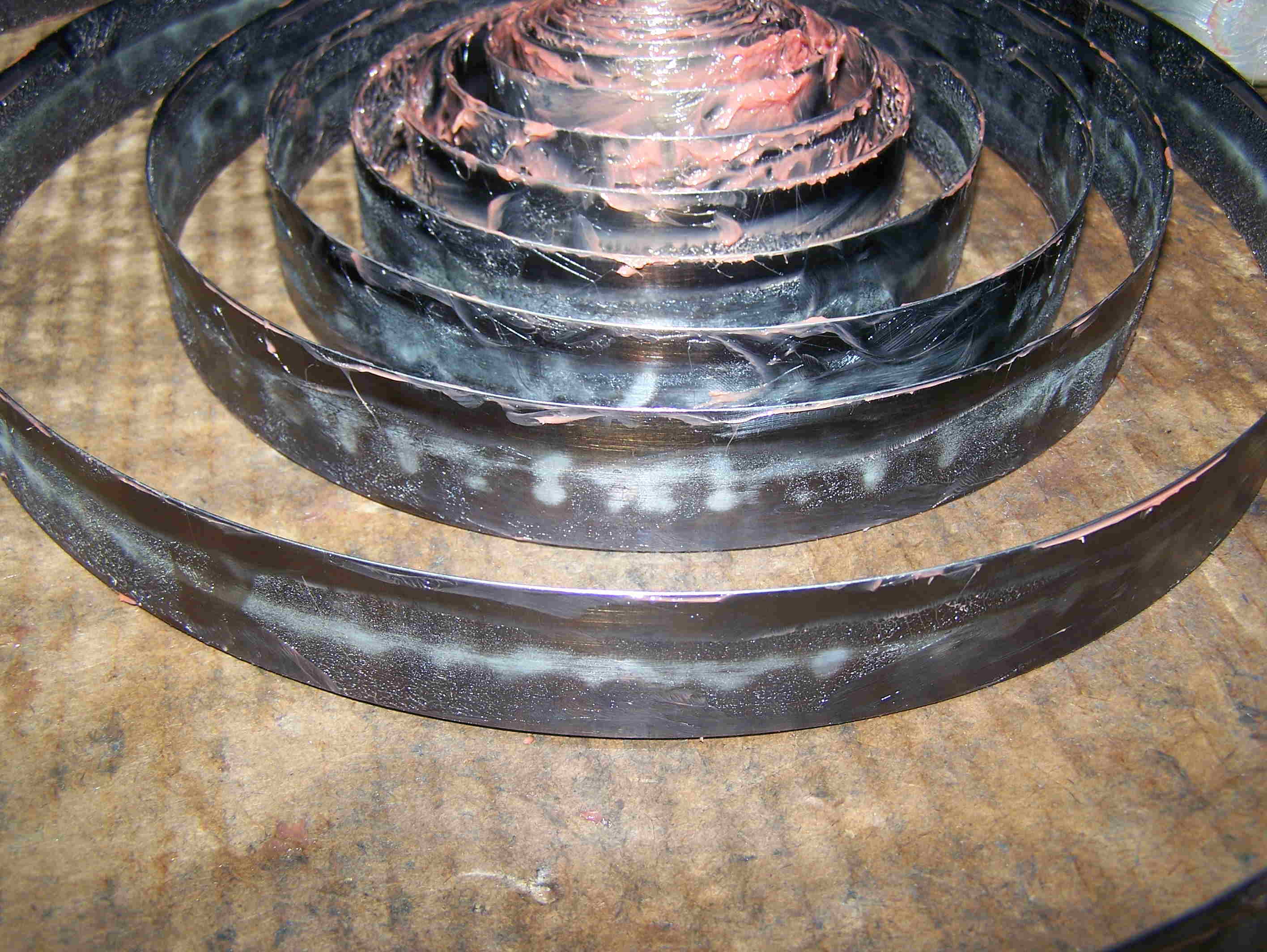

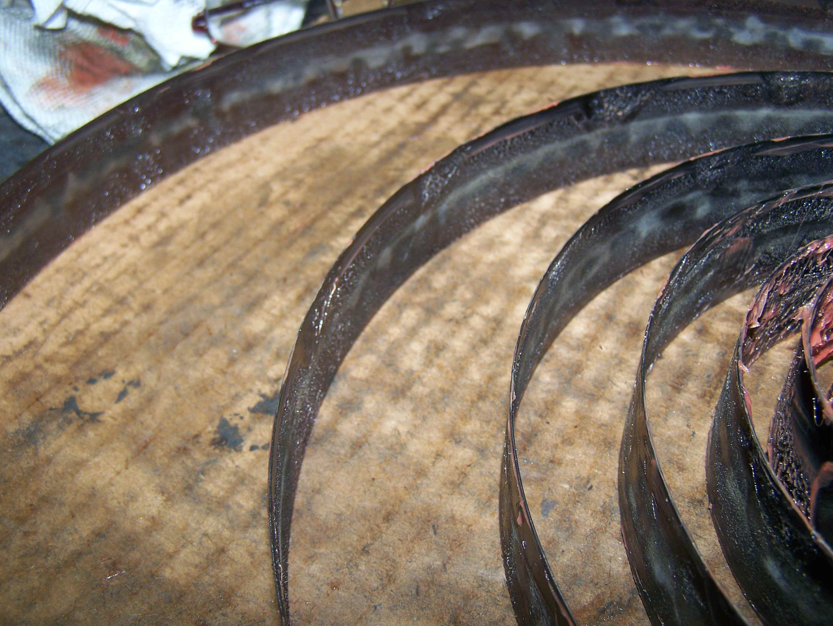

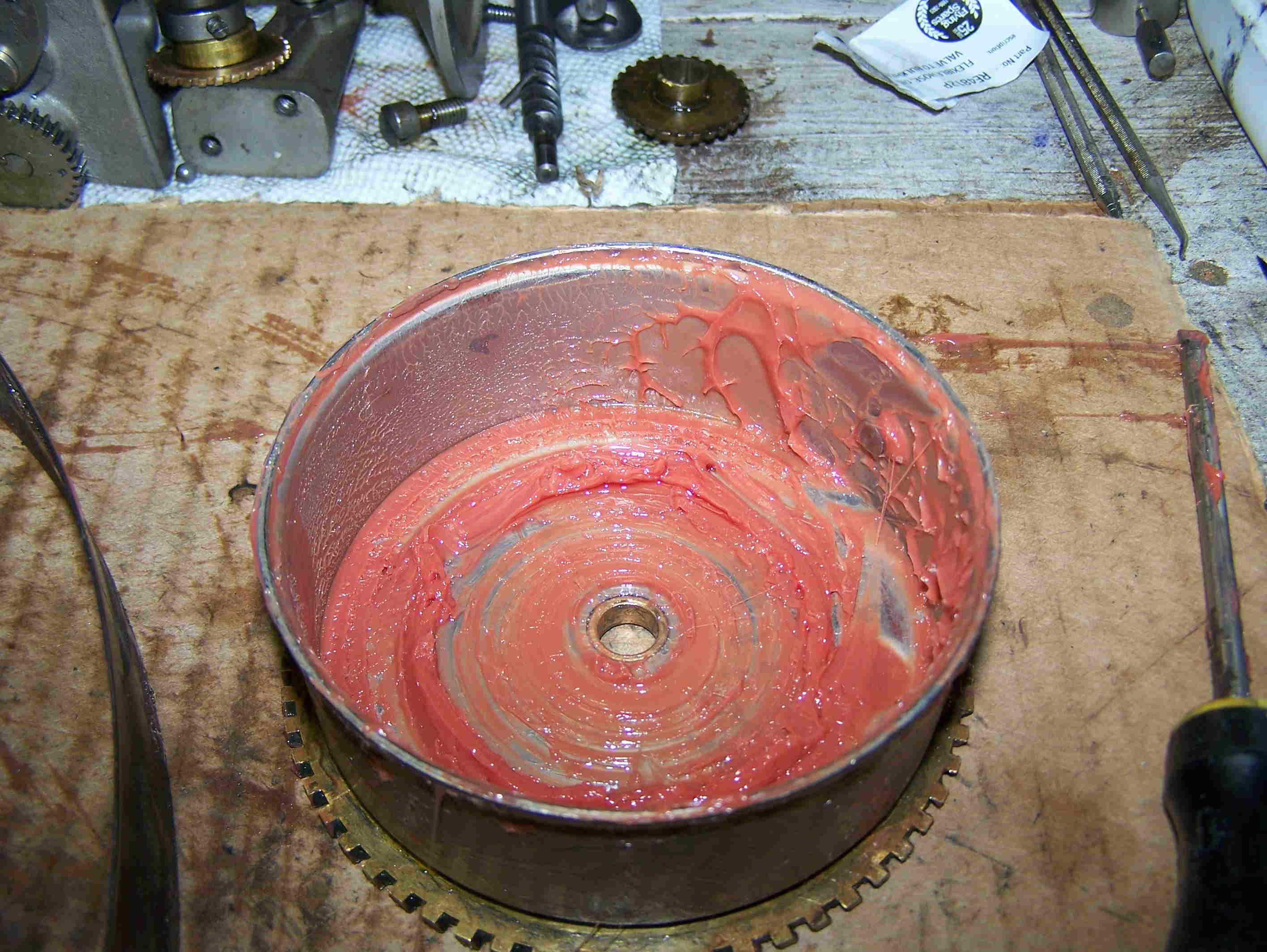

The photos show what grease is left on the spring after it was fully packed in the centre on a dry spring and barrel.
Most of the grease ended up on the barrel and on the cover (not shown), there was so much grease that the cover was being displaced from the oozing grease.
I eventually removed the cover and scraped off the excess grease, and the oozing grease pretty much stopped, but still there a little _ not much of a concern though.
There is not a great deal of grease on the main parts of the coils nor does it appear that any excess grease works it's way back into the coils.
The amount in the centre seems to stay there because the motor is not wound to the top.
I believe that the action of the grease continually moving from the centre out to the coils and back again is false.
Never the less this all works well because it spreads the grease evenly on the coils of the spring, and this is very important.
What I have discovered is that it's pretty much impossible to pre-grease the spring and get it even enough so it winds up properly, and more importantly, unwinds evenly so "thumping does not occur.
I think if one pre-greases the spring before installing it, or even while you're adding grease while coiling the spring into the barrel, you get lucky that the spring is quiet upon use.
By itself the CV-2 grease is too thick, it does not allow the springs to wind down fully, at least on the Victor spring that I was using.
The spring is a little weak to over come the thick grease and fully wind down, there is still a little tension on the spring and on the turntable spindle.
It's not much tension, but it's there.
I believe Gramophone-Georg's solution works well as it's thinned down enough as to not effect the tension of the springs, but thick enough to stay inside the spring barrel, as he says.
