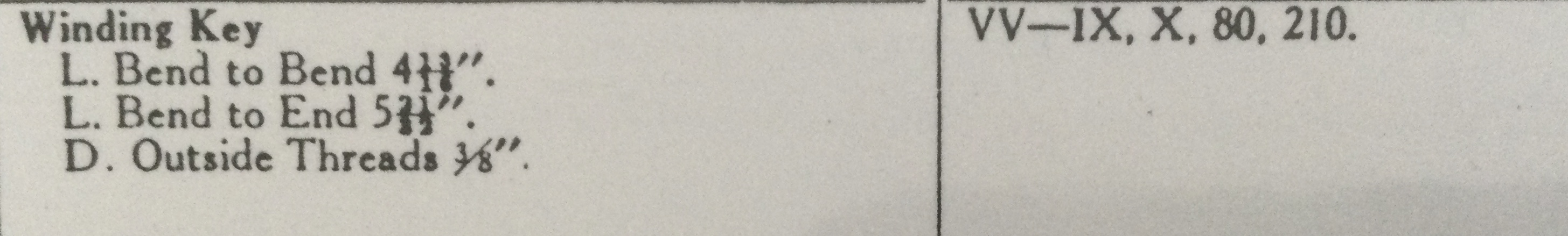

André,
Here are the specs for the crank for your serial number IX. The finish would be ‘NG’ meaning Nickel Gloss.
It is a pretty common crank, you should have no trouble finding the right one. I suspect the dimension are center to center although it is not indicated as such.
Mark

Thanks a lot Mark.
I appreciate.
Great job!
Andre.
