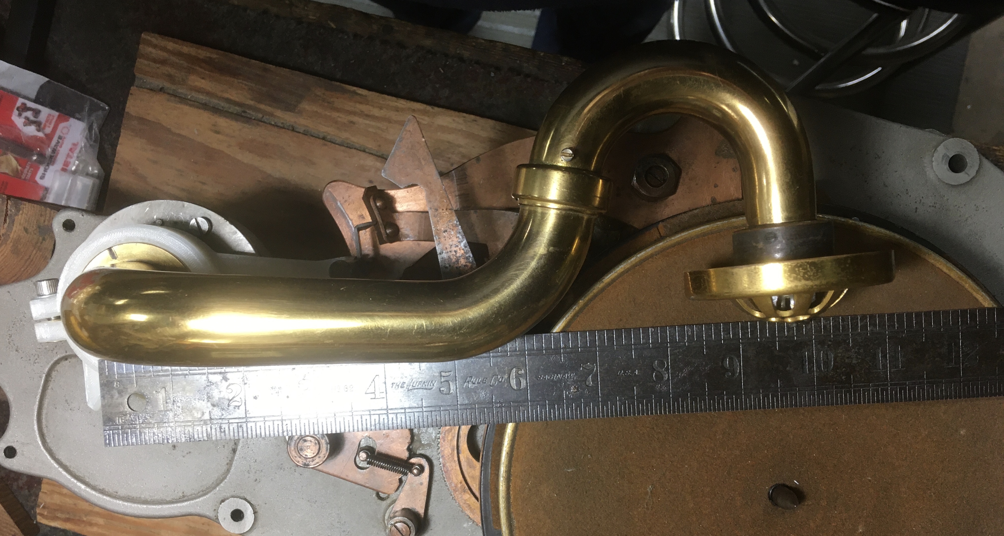

I understand two different tone arms were used on the 1927 Victor record changer, the acoustic version using a slightly longer arm than the electrical pickup version. Can anyone give me the dimensions of the electric version?

Yes, both the tonearm and the tonearm return lever are different between the Orthophonic (10-50) and the Electrola (9-55, 10-51, 10-70) versions of the first style (1927) changer.
It is a bit hard to measure but maybe these photos will help. Measured from the center of the tone arm base to the needle there is about a half-inch different in length. The arm length for the Electrola needs to be shorter because of the shape of the electrical pickup versus the Orthophonic soundbox.

I hope you find the right parts for your 10-51. What shape is the moving coil driver in? Most are badly swollen and not useable. Keep us posted on your progress.
