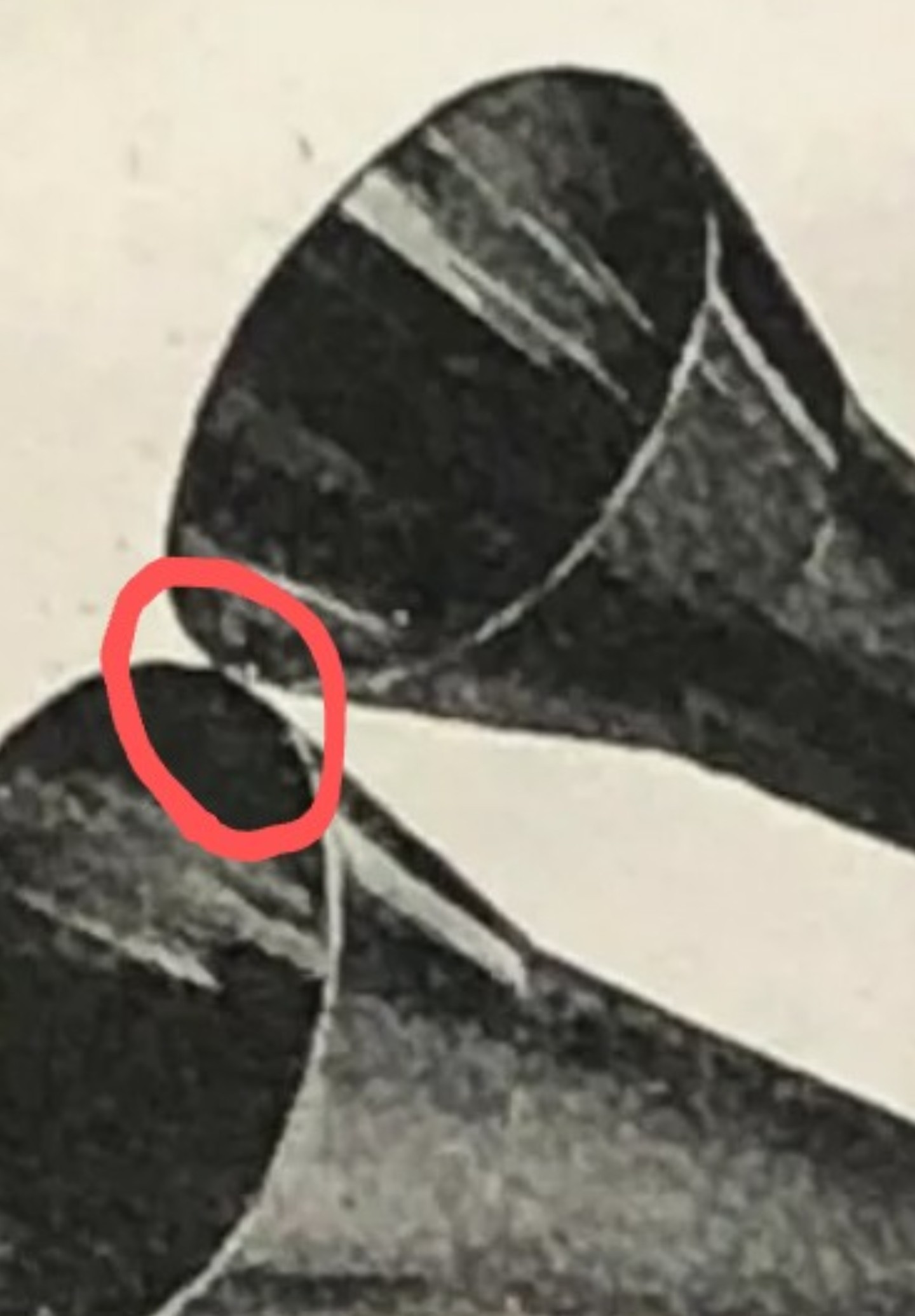

I found a period advertisement that seems to show the black funnel horns linked if you look closely. Perhaps the loops were meant for polyphones. There may be lots of artistic license in this ad.
Is anyone aware of a fancy embossed metal base known to exist? Also, has has anyone seen an origianl long curved elbow for the rear horn, other than the ones recently made?
It would be nice to have proof of any of these mysteries, but Polyphone photos are exceedingly rare.

Thanks for posting that, Scott. While not 100% conclusive, that really does seem to show a loop when viewed at large magnification.
I'm not aware of any of those cast-base Polyphones surviving -- assuming any were actually made. It sure would be a treasure!

phonohound wrote: Sun May 08, 2022 11:57 am I found a period advertisement that seems to show the black funnel horns linked if you look closely. Perhaps the loops were meant for polyphones. There may be lots of artistic license in this ad.
'Artistic licence' says it all: a Standard top works, cut and pasted onto the base, with no hole for the crank? :?

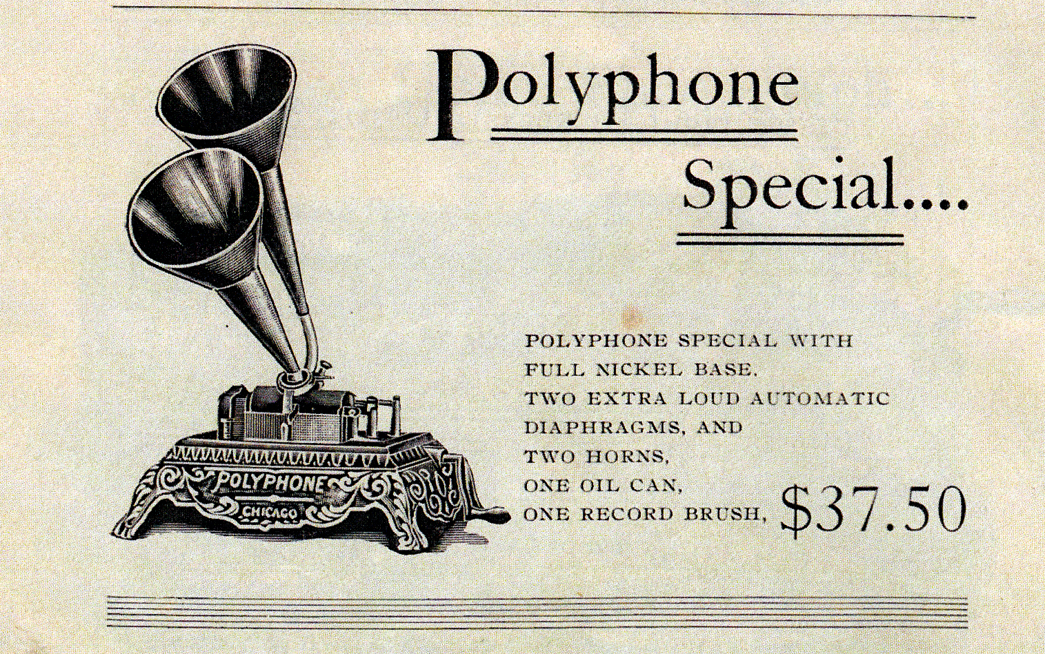

There is another ad showing this Polyphone "Special," this time clearly with a crank (and appropriate bezel). But there's no indication of loops on the horns in this ad.

TinfoilPhono wrote: Sun May 08, 2022 9:43 pm There is another ad showing this Polyphone "Special," this time clearly with a crank (and appropriate bezel). But there's no indication of loops on the horns in this ad.
What a trophy THAT would be!
