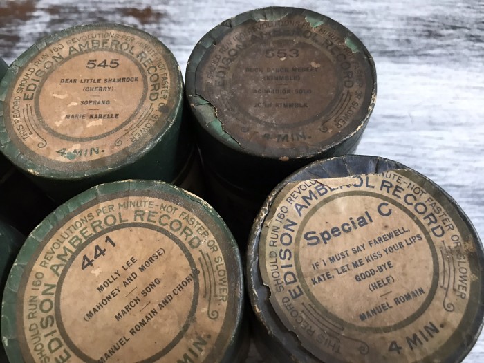

I have a special C Edison cylinder, in the original box with original lid.
Do these Special C cylinders have any significant meaning .?

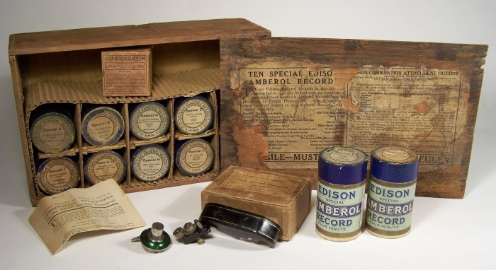

A detailed illustrated article on these appeared in the APS magazine in December 2020. There were 10 Special Amberol Records included in a promotional set to encourage Edison owners to have their early 2-minute machines converted to play the new 4-minute Amberols. Your Special C is one of these promotional records.
Here's one of the images used in the article. It shows a complete set with an Amberol Attachment for an Edison Standard.
