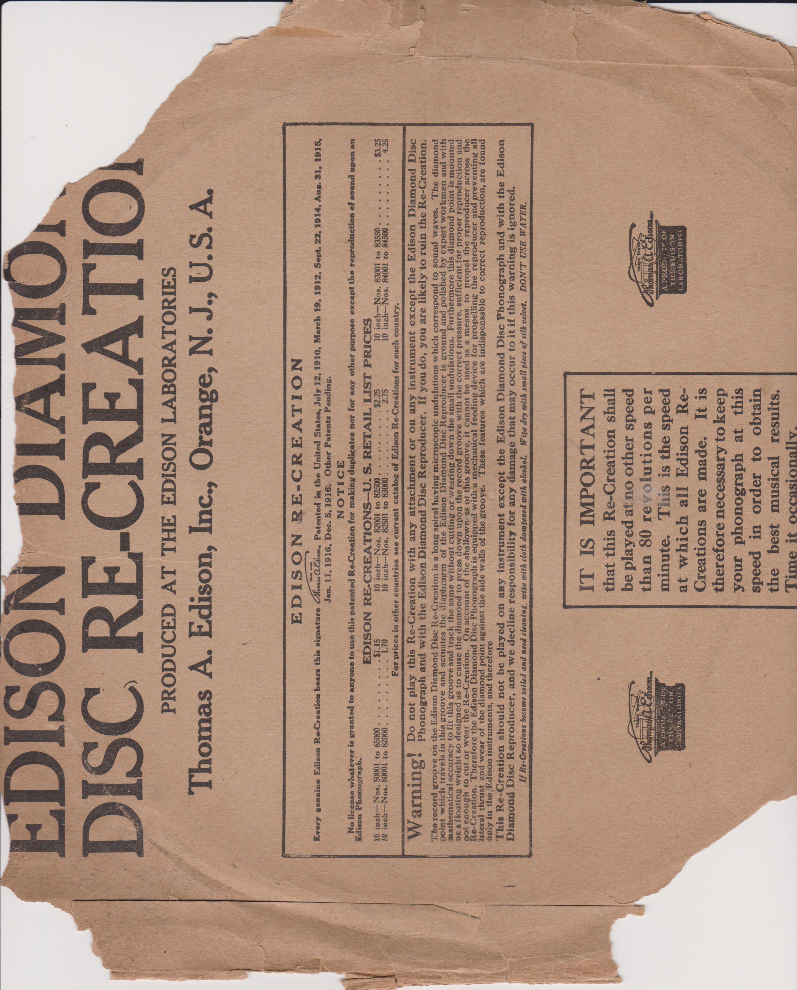

People who look at the record jacket see the words to not use water to clean the record. It would seem logical that most people would believe what the manufacture stated. "Do not use water" above the trademark.
