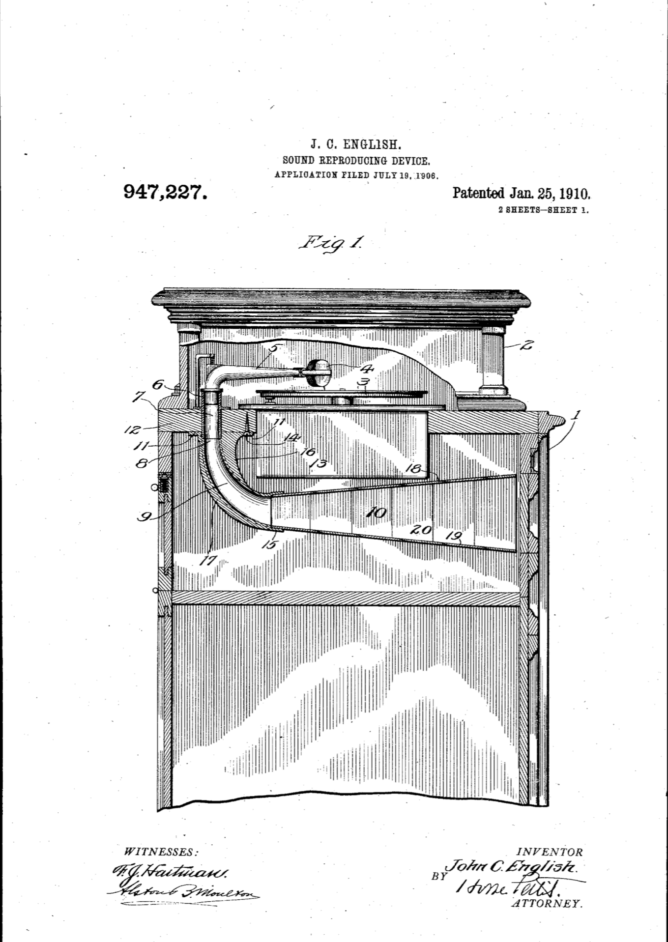

What was Victor's purpose in providing rigid support for their inside horns only at the throat (tone arm end) allowing the rest of the horn to "float", isolated from the cabinet? They were surprisingly consistent about this from 1906 until the Orthophonic re-entrant design made it impossible. If this was a patented feature what claims were made for it in the documentation?
-Dave
Victrola horns
- Posts: 524
- Location: Silver Spring, MD
Re: Victrola horns
Hi Dave,

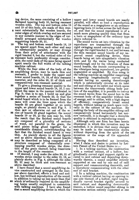

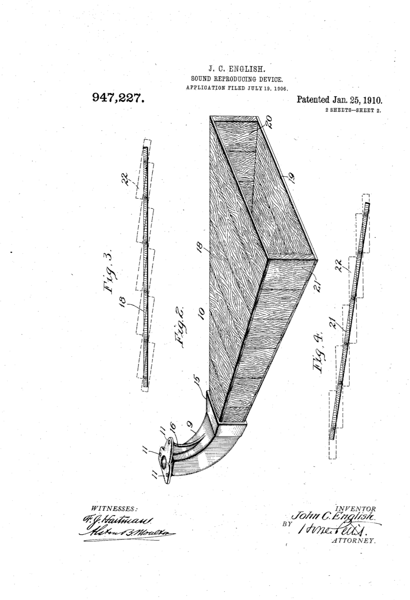

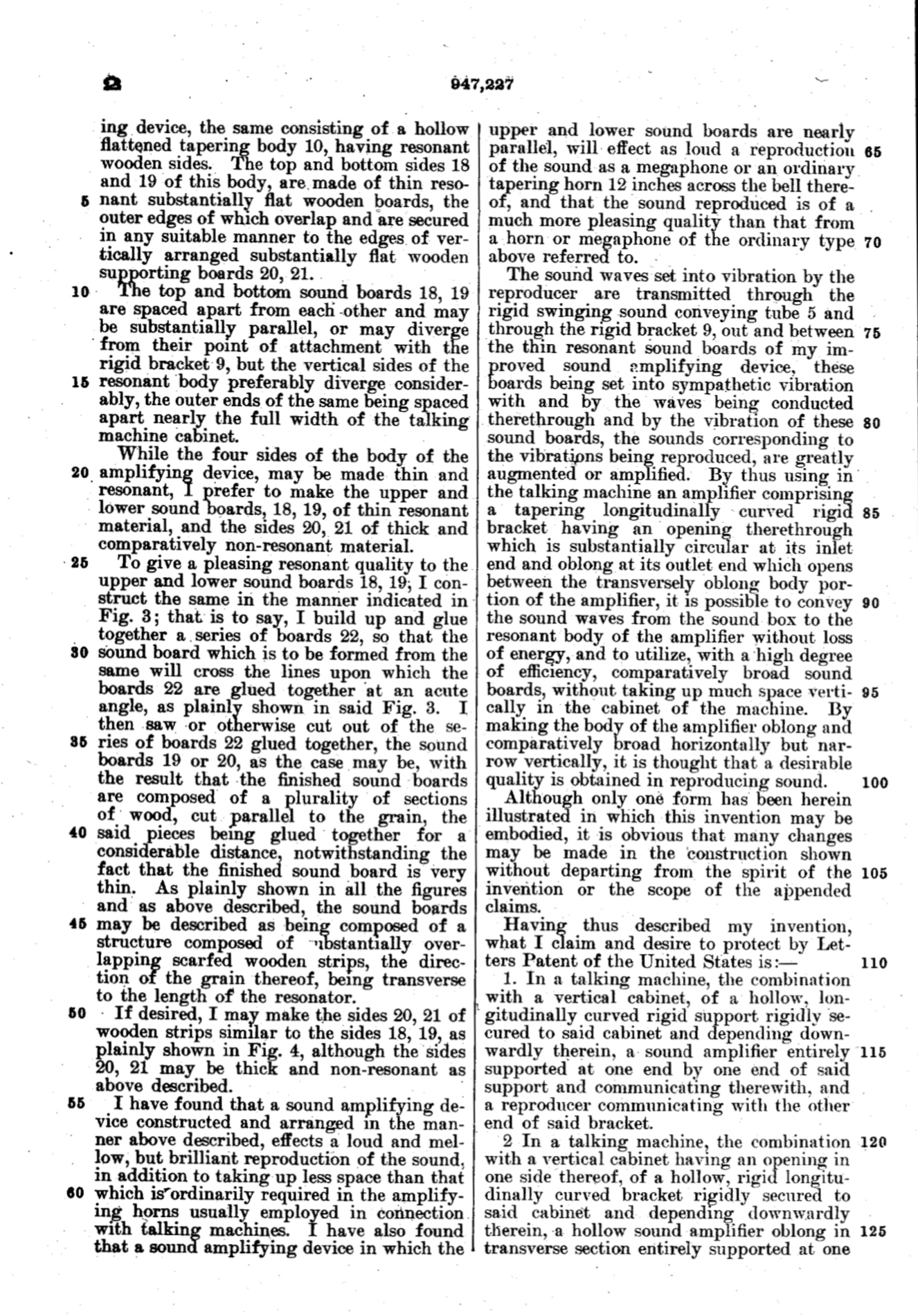

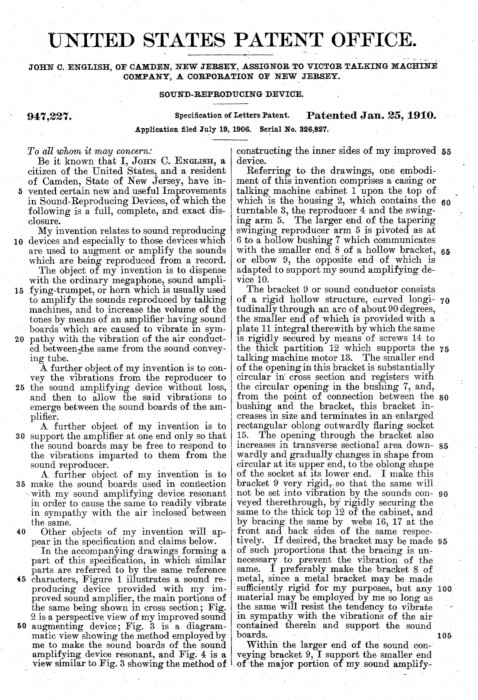

Thanks for posting this question! The description and function of the internal horn supported at one end is described in this patent. John English applied for the patent in 1906, it was granted in 1910 and assigned to VTMCo.
See the first page, line reference 30.
Mark
Mark
