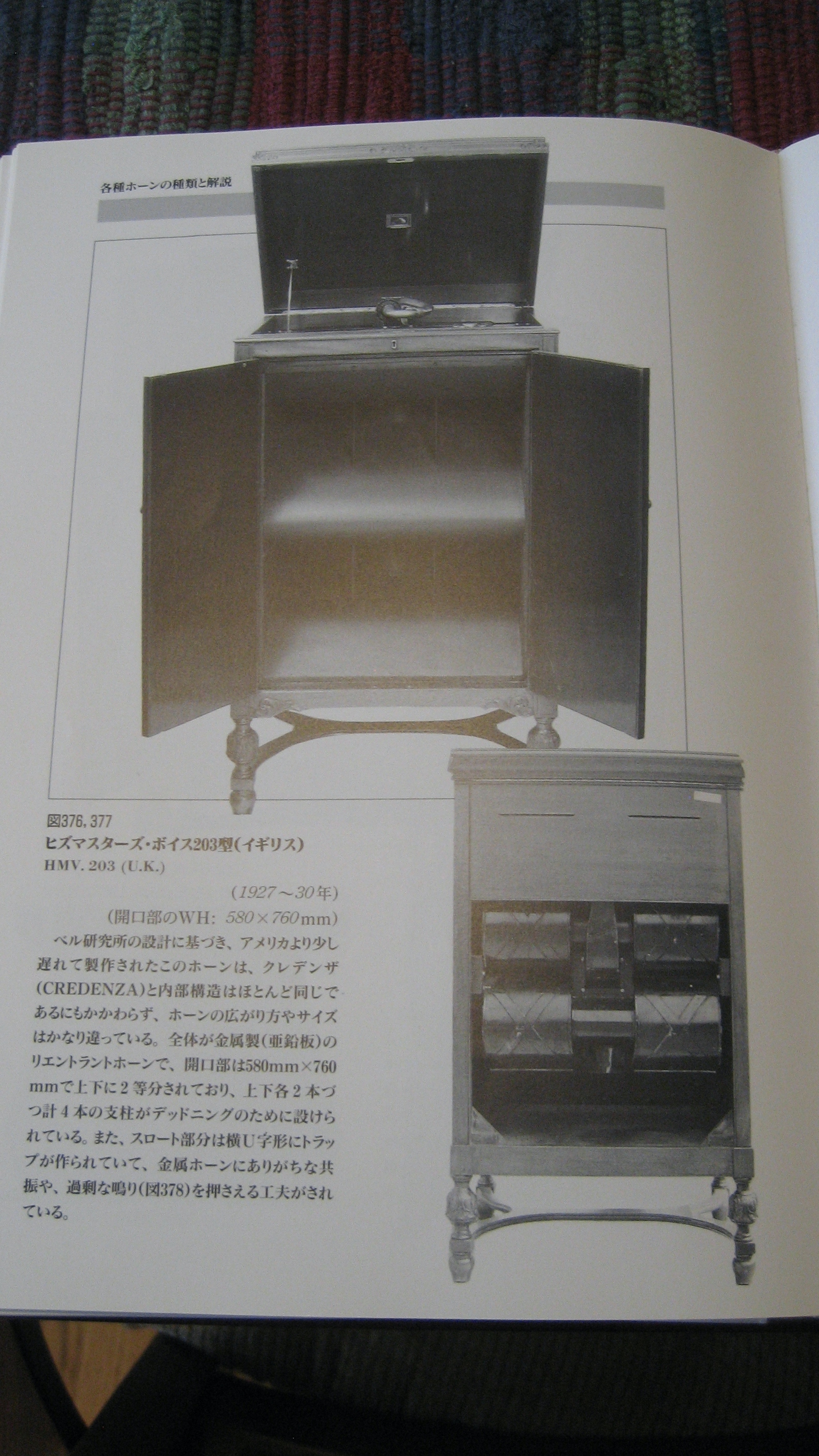

Hello everyone,
Here are interesting comparisons between hmv 203's horn and Credenza's horn. I hope everyone enjoys this.
Hideki
Hideki

Thank you for sharing:) It is always interesting to see new documentation.

Wow. The horn in the 202 does appear *much* larger.Watanabehi wrote: Mon Jan 10, 2022 7:44 pm Yes, I used to own HMV 193, which I miss very much, but I very much enjoy listening to my HMV 202. The photos show the horn differences between HMV 202 and VV 8-9 or VV 8-35 horns, which I use for RCA theater Alnico horn drivers for stereo usage. I am planning to add field coil Jensen speakers. The photos don't have Jensen speakers, only the horn drivers. VV 8-9 and VV 8-35 horns are larger than HMV 163's horn and a little smaller than HMV 193's horn.
Hideki
Do you have dimensions for the openings of the respective horns, that is, the length and width of the horns at the bell opening?

My 202's horn opening is
23"w X 30 ½"h
