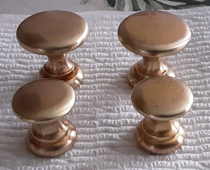

I noticed the brass knobs on my Victrola 17 i restored a couple years back have become dull again. I clean them with 0000 steel wool and dawn soap. Anyone who has done this knows it can be a pain in the brass to clean them.
I have tried some Mohawk Brass Lacquer to see if it slows down or prevents oxidation. I know a lot of you collectors love petina but i myself love shiny brass and it looks better on my restored machines.
Has anyone tried this? Does it last? Since it can be easily removed with thinner i dont feel bad about doing it.
Here is a picture after spraying

I am not entirely convimced these knobs were on this 17 originally, the other 3 17s i have, have knobs with recesses circles carved into them. These knobs look more like a 16 knob. Wonder if the factory did this or the previous owner.
As for any original finish on the knobs, it was long gone before i cleaned them
Overall, i think they look pretty good, not the best but perhaps a 6 on scale of 1-10.

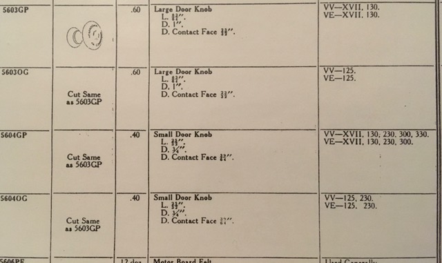

Hi Jon, you are quite correct, the XVII upper and lower door knobs have a circular pattern on the front face. I checked the parts listing and found that these special knobs are used only on a few models. The smooth front knobs you have probably came from a XVI and were likely changed by a previous owner. I suspect Victor would not have made the error, anything is possible but it is more likely that they would have followed the Bill of Materials during assembly and used the knobs assigned to the work order.
See part numbers 5603GP and 5604GP (GP = gold plated)
Mark

Mark, i am impressed, very helpfull, thanks. Does the .60 indicate the original price?
