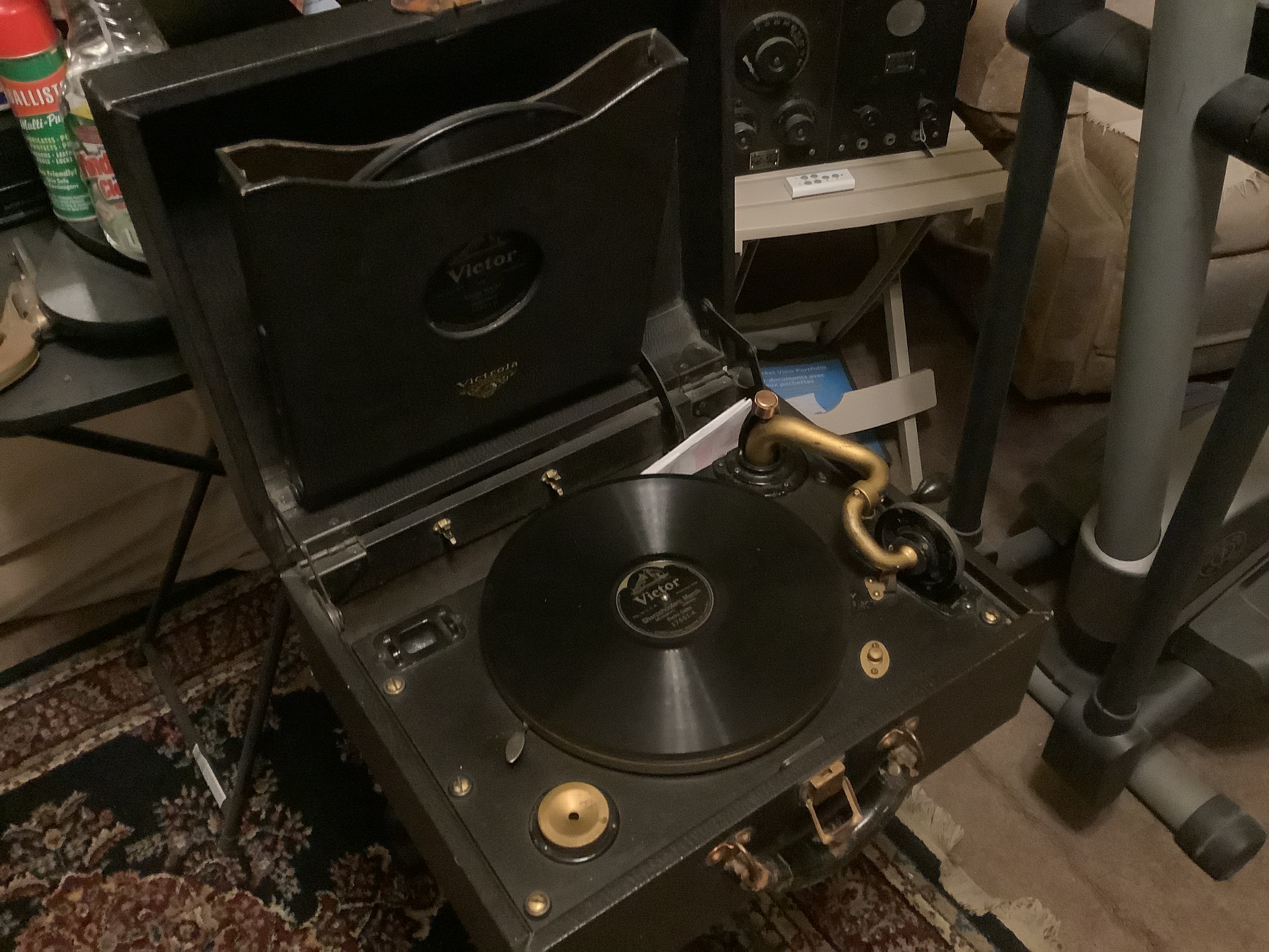

Please post a photo of your 2-60.

Here ya go! Would have posted it earlier… but couldn’t figure out how to attach pics. Pretty proud of it for $80. Really clean suitcase portable found 2 miles from home. Soft tone needles really help with electrical recordings… and luckily I have a pack.
Appreciate your info about the ball bearings. Amazingly… they are all there! Spent some time adjusting the tonearm and the little beast plays near perfect now. That’s all it was. I’m not taking it further.
