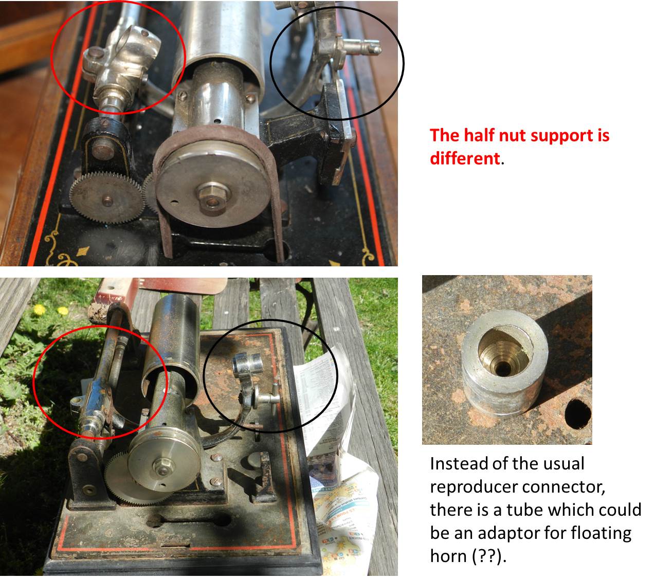

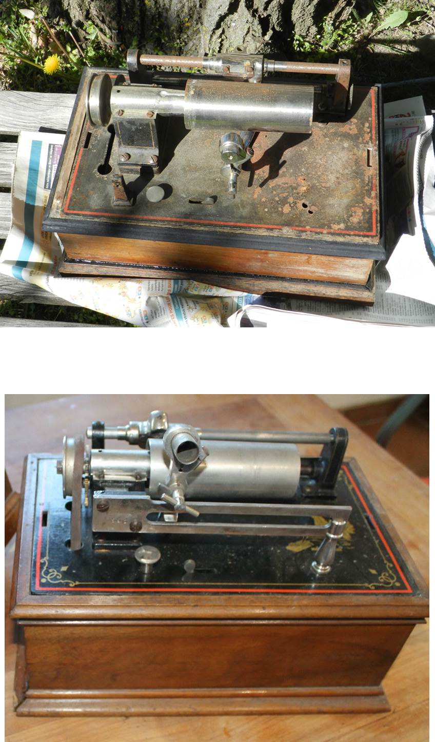

I found an incomplete Pathé machine and I didn't succeed to identify which model it is...
The machine is incomplete, I'm not sure the wood case is the good one and, anyway, the moldings are not original.
I found a pic of a quite similar model, also unidentified (at the bottom on pic B). At least, I know what is missing...
Instead of the usual reproducer connector, there is a weird piece which could be a part of an incomplete floating horn adapter (?).
Any idea ?

It appears to have been modified.
The arm is for a horn and similar to that of a Phenix phonograph.

When I found this machine, it also had a Salon mandrel and I'm pretty sure there is enough space to mount a Salon cylinder but, playing it would require a floating horn so, maybe, the small piece on the last pic was part of an Orpheus attachment.
