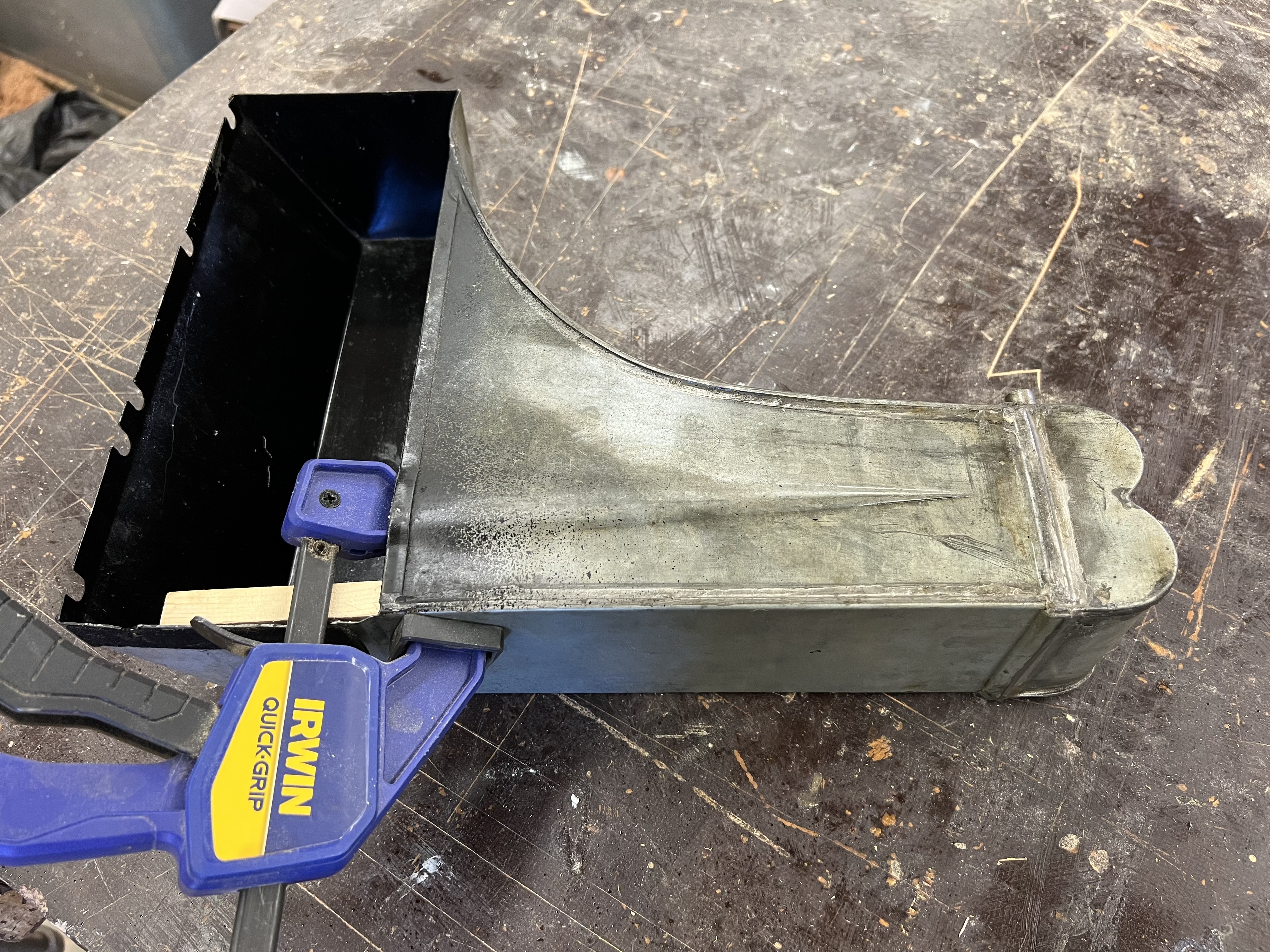

Some pictures of the internal horn section:
I’m curious if there is supposed to be a part of some sort on the shaft that holds the lifting bracket, or if it is just threaded on part way so it will clear any obstacles as it lifts the horn.
- Posts: 1325
- Location: United Kingdom
Re: Columbia 112a specific repairs
That looks as it should.

When I took the horn apart I noticed that the fixed support had come loose, so I used a piece of wood and a clamp to hold it in place, and some MG120 silver bearing solder to repair the cracked area. It got a little messy, since my iron would produce quite enough heat for the job, but hopefully it holds. This solder and the flux that comes with it do a phenomenal job on old metal like this. My usual go to is plumbers solder, but it doesn’t flow do well in zinc and steel. This silver solder works like a dream, though.
The pivot has a flange inside, and is pushed in place by the removable pivot on the other side, so there ought not to be any stress in it to cause failure again. This machine was beat up pretty badly when it was shipped to me, And this is likely a casualty of the shipping incident. Fortunately no damage to the cast section of the horn.
