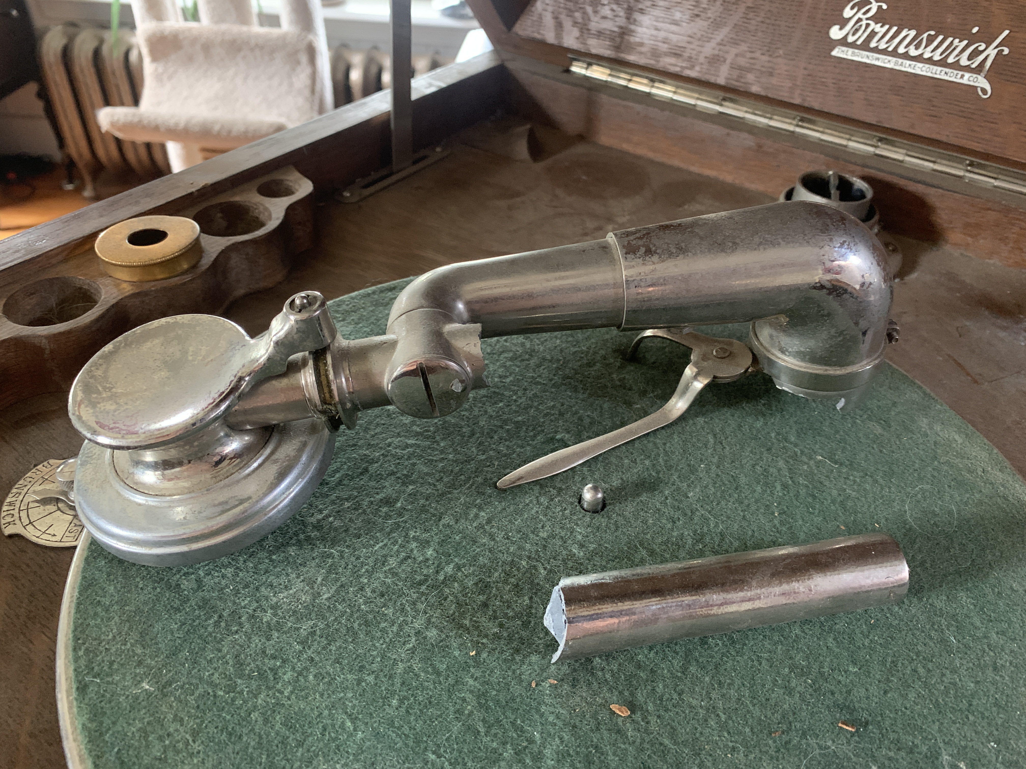

... the case is in nice shape and should clean up well, but that tone-arm has all sorts of pot metal issues. Can anyone identify the model and let me know if this is worth fixing (and I know that term is subjective, I don't mean resale value, I mean quality of play)? I haven't taken apart the motor but I believe the crank isn't catching either. May be a simple fix but won't know until I dive into it.

I did find the original needle cup, it was down under the motor with its contents strewn about. That's great, because I've been looking for a gold needle cup for quite some time and this one came with one non-original to itself! Basically I paid $10 for a needle cup and it had a phonograph attached to it. That tonearm though is quite a mess. I think my only chance is to find someone with a trashed case and see who wants a working Brunswick more ;)

I think you have found a very nice early Brunswick Ultona tone arm phonograph. It looks to me a wax finished golden oak. A plus in my opinion.
With access to this forum you should be able to sort out any issues with the arm or the motor. With the Ultona arm you will be able to play three different types of records: laterals like Victor, Pathé vertical and of course vertical Edison Diamond disc.

It's a versatile machine that will play both lateral and vertical cut records. You shouldn't have much trouble finding a replacement tone arm and judging from the replies you've gotten so far, it sounds like you may already be on your way. As for a date, I'd say early '20s.

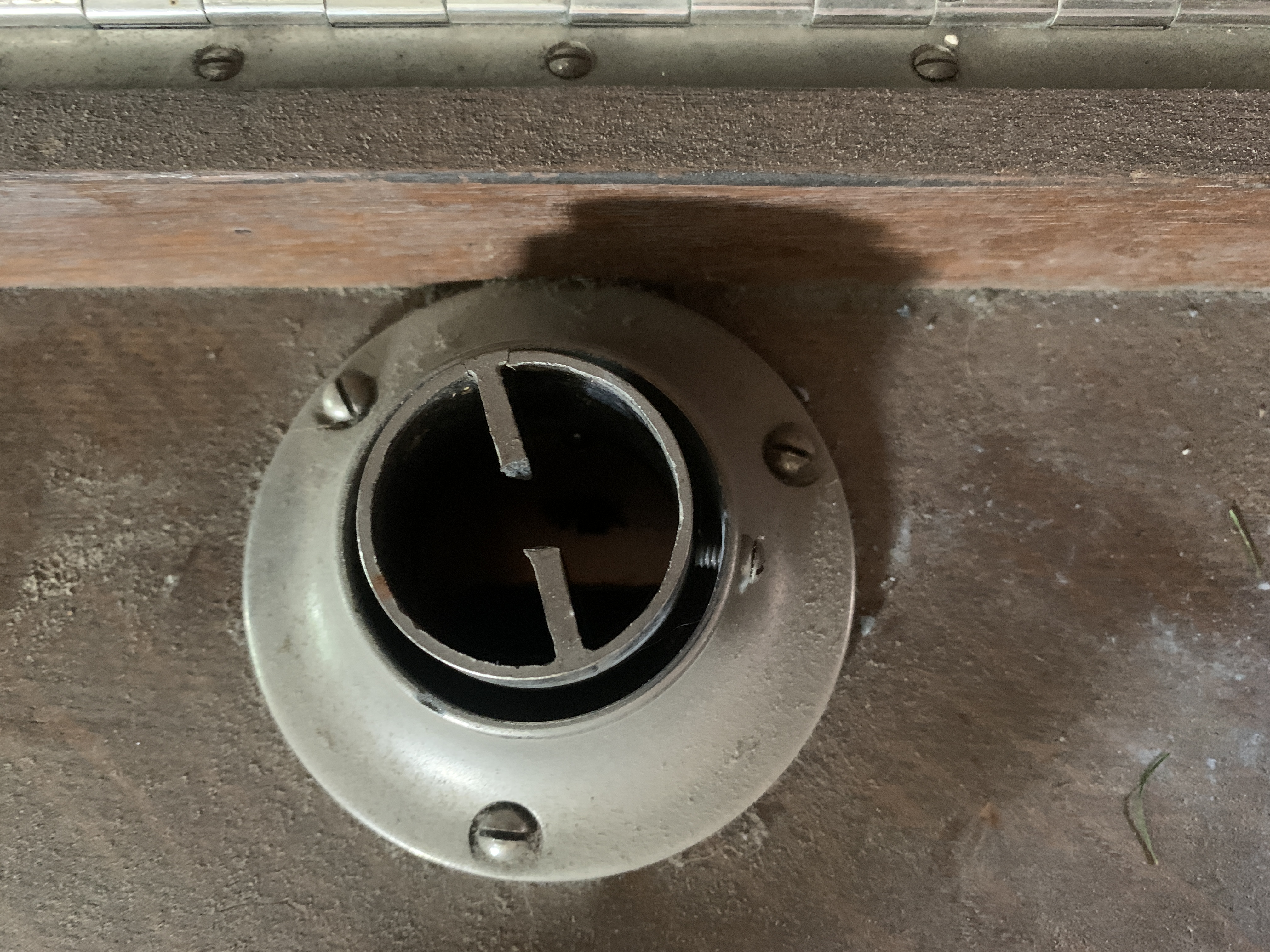

So over the course of trying to get this back up and running I've found out that this is a pretty a-typical tone arm and reproducer. For one thing, that large screw that holds the reproducer arm onto the tone arm. It looks more like a Victor screw as the Brunswicks usually have a smaller screw and a washer.
The other is this fling-flanging pot metal retaining ring. I haven't seen any others like it and i'll tell you what... this WON'T come off...
