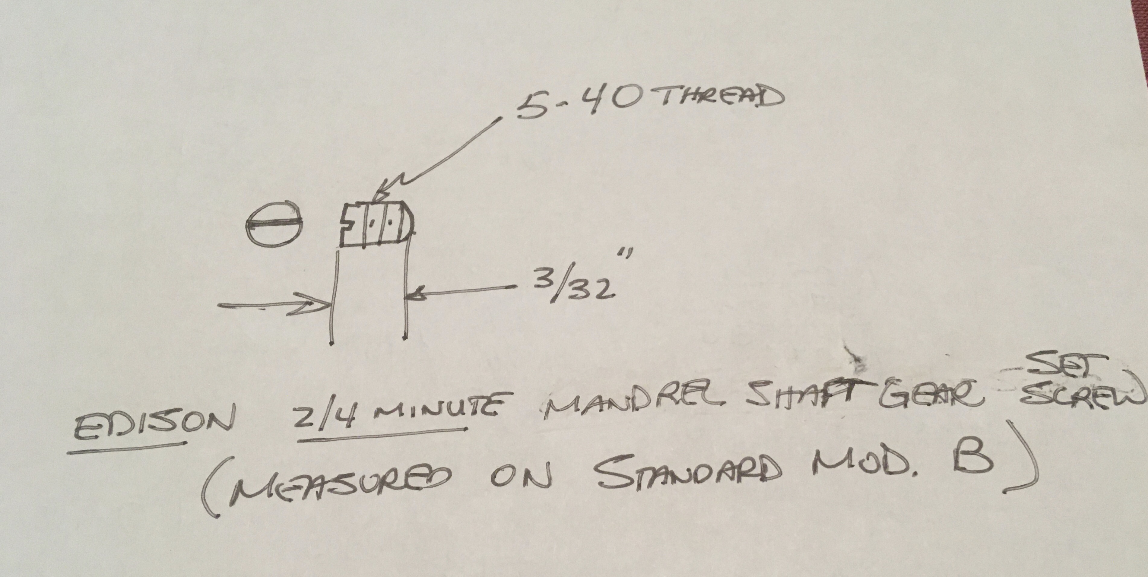

Good Morning-
I searched the Forum for the answer to my question but to no avail. I hope the answer to this question is not glaringly apparent but I have not been able to figure it out. I am looking for the screw size for the set screw on an Edison Standard mandrel dual gear with a 2/4 minute attachment. I had a need for one years ago and got around it by finding and buying another gear with the screw in it. This time around I would just like to buy the set screw. I am not as adept as many of you out there that can determine smaller screw sizes and I don't have the ability or tools to cut off a screw and alter it into a set screw-although I wish I did. I also can't find the correct size at my local and very complete hardware. (MAN those things are tiny and hard to handle!). Anyway, any help with the size would be greatly appreciated. Thank you in advance.

52,
The set screw thread you are seeking is a standard 5-40, the length is 3/32”. Locating modern set screws with a slotted head is problematic, typically they have a hexagonal opening for an Allen key. However, in this application that will not be a problem unless you want historical accuracy. The other option is to use a section of 5-40 rod or a screw and cut your own slot. The 5-40 set screw is readily available from McMaster Carr (in packs of 25) or the threaded rod or screw option.
Ever hear the old adage that “One measurement is worth a thousand expert arm-chair opinions”?
I measured the set screw in an Edison Standard model B in the (to be repaired) collection. Here are the results. I double checked the thread pitch with the pictured 5-40 x1/2” screw. I hope this helps.
Mark

Wow, Mark. That might be the most thorough answer possible!

Re: Set Screws
Post by collector52 »
Good Morning-
To Jeff, Dale, Mark, and Jim-thanks so much for taking the time to reply to my question. I totally agree with Jim-that was probably one of the most thorough replies I have ever received to a question and I greatly appreciate the time and effort spent to send it. It even sites a source which will save me time trying to find some. As to keeping things authentic-I strive to do that on all of my machines but if I have to make an exception a set screw would be the easiest to tolerate.
