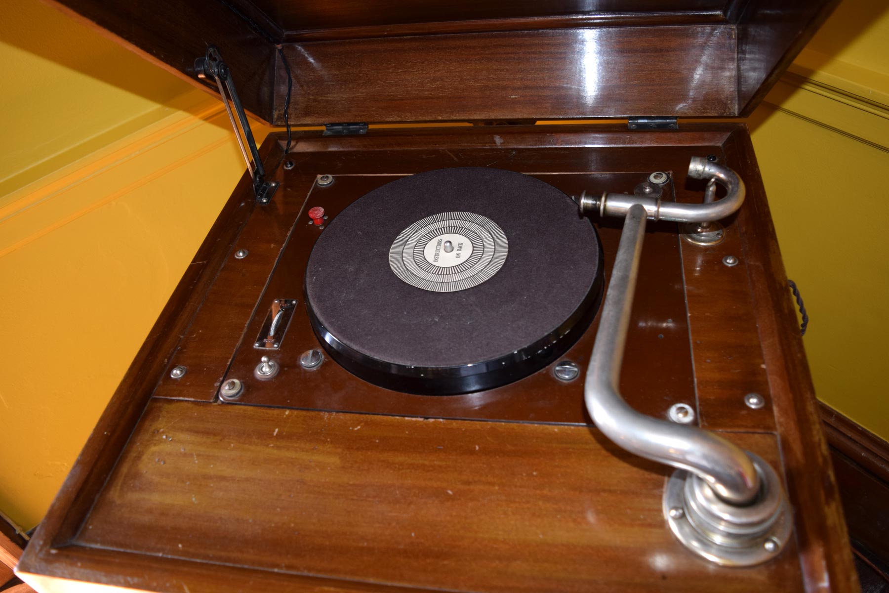

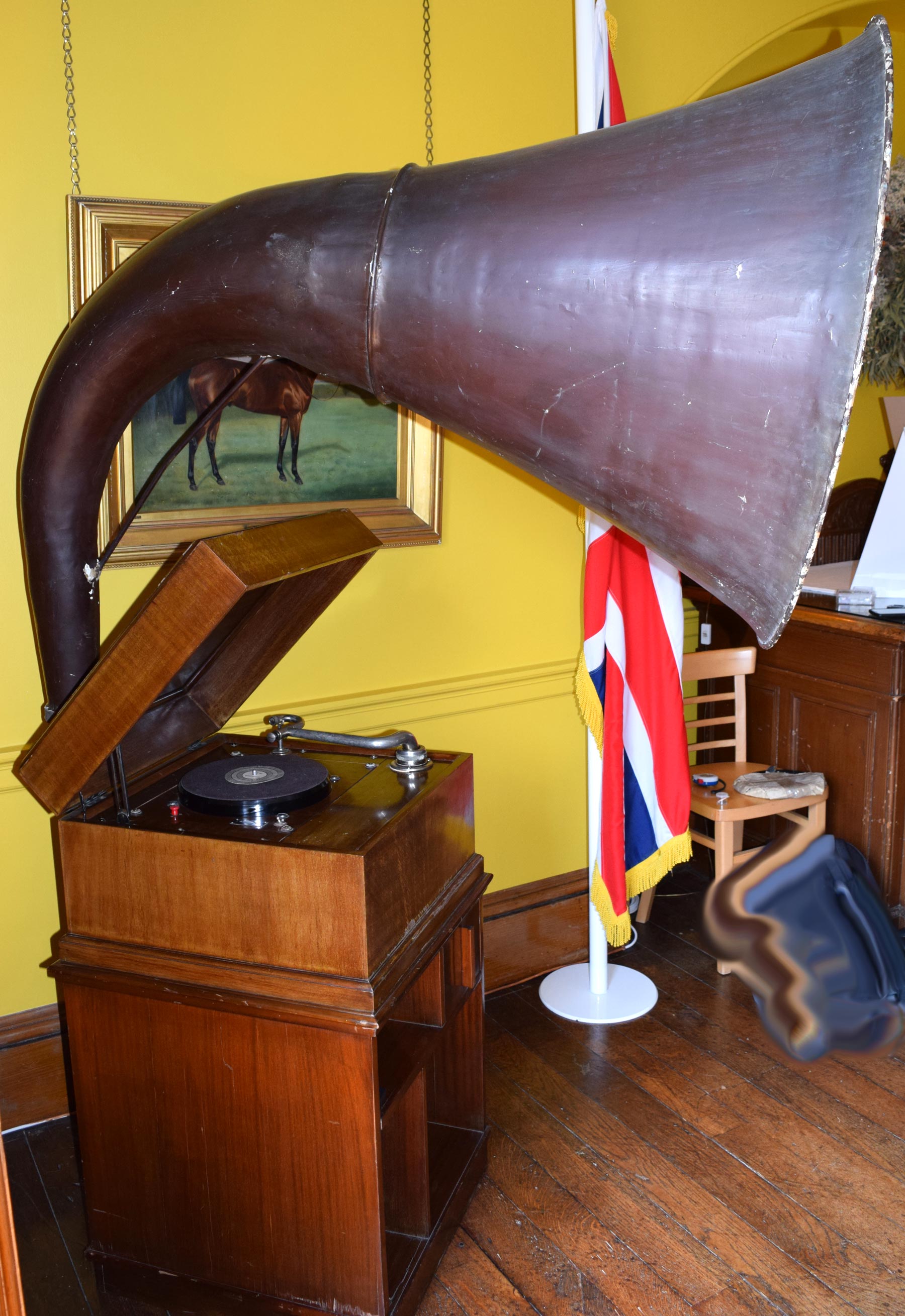

EXPERT All-Range C.1935
This example was unearthed at Harewood House in West Yorkshire. It had been in storage and the curators at Harewood House Trust decided to put it out on display. It caused quite a stir so they decided to find out more about the gramophone. They contacted me through my website and I was only too happy to let them know what they had and sent them details on this rare beast. I was planning a trip to the UK so asked if I could come have a look at and document it. They were very obliging and a date was set up for my visit. I suggested I bring a few tools along to see if I could get it working. I was told as it was part of the Trust and as such, any work on it would have to be approved, which could be a lengthy process.
Harewood House is a must see venue. The grounds and buildings are simply stunning and the car park was full on a Monday morning. I was told the gramophone belonged to George Henry Hubert Lascelles, the 7th Earl of Harewood. He was a huge Opera fan and was head of an array of impressive musical societies, so quite apt that he should own one of the best acoustic gramophones ever commercially made. He was quite a character and had his fair share of intrigue and scandal. Come on! he was president of Leeds United Football Club from 1961 until his death in 2011.
Back to the gramophone.
Unfortunately, the gramophone is currently only for display and does not work. The motor needs repairs and the soundbox may need rebuilding. The two examples I have seem have had the same damage to the horn. The diagonal brace rod, which is meant to help support the horn, has punctured through the paper horn. All quite easy repairs, and I have encouraged the curators at Harewood House to have these repairs done, so that the beast can be played and perhaps even used for concerts.
I’ve put together a draft web page on this All-Range. It’s not live yet but can be viewed and critiqued here.
http://www.gramophonemuseum.com/expert- ... range.html
Details: Expert All-Range with 36” diameter horn:
  • Sits on a matching Expert cabinet with drawer.
  • All the fittings and pipework are identical in size to the Expert Senior, at least on this example.

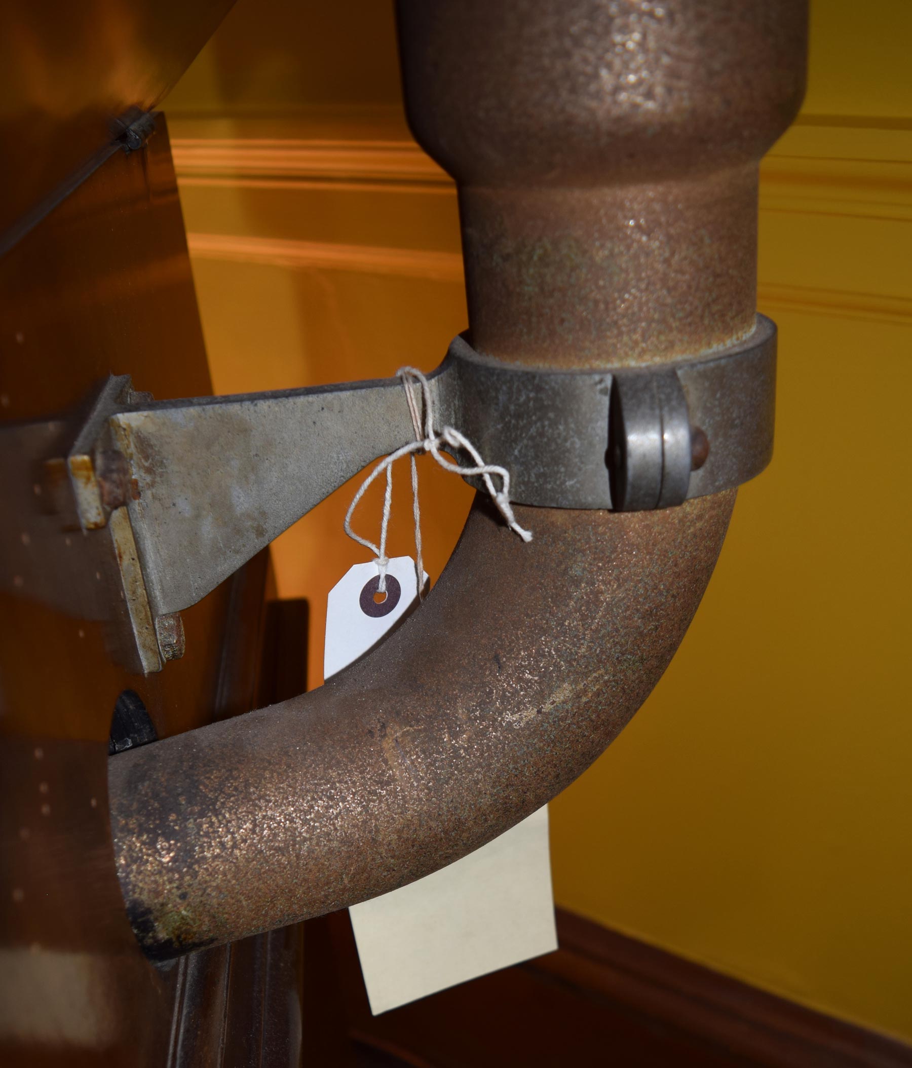

  • Unique support brace attached to the rear of the case, suggesting a different cast. Which one came first?
  • Fitted with an electric “Connoisseur motor, manufactured by A. R. Sugden in 1948”. It has a vertical idler wheel to rotate the turntable. Thanks to “physicist” for identifying the motor.

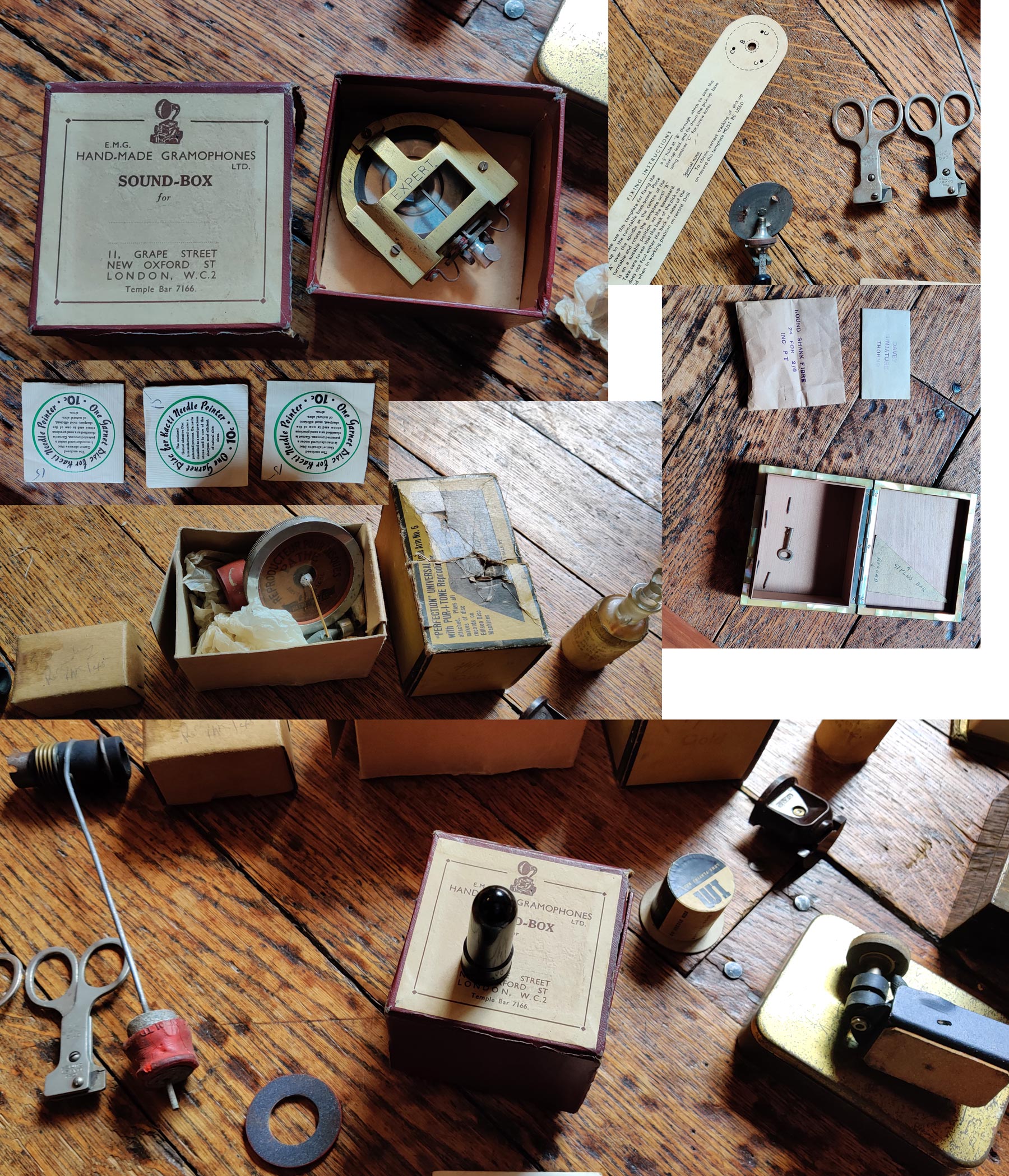

  • Expert 4-spring soundbox in its original box.
  • The cabinet drawer contents are pictured below. A pair of Davey bamboo cutters, Davey Dressing tube, Davey Rollright, a BCN Fibre Needle Sharpener and accessories, a Pathé reproducer for playing vertical cut records and a variety of fibre and steel needles.

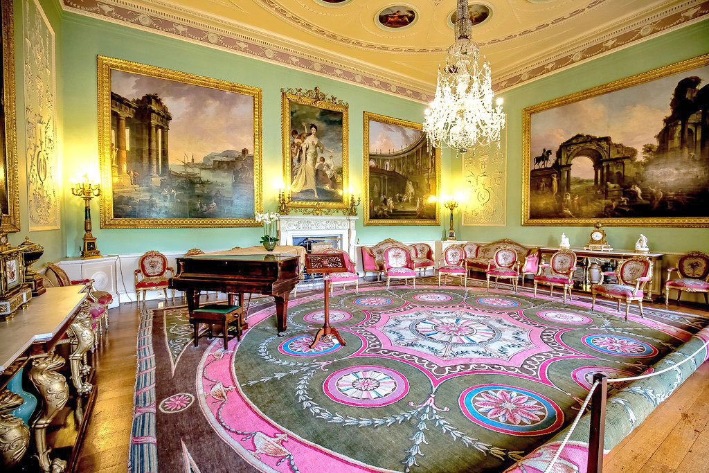

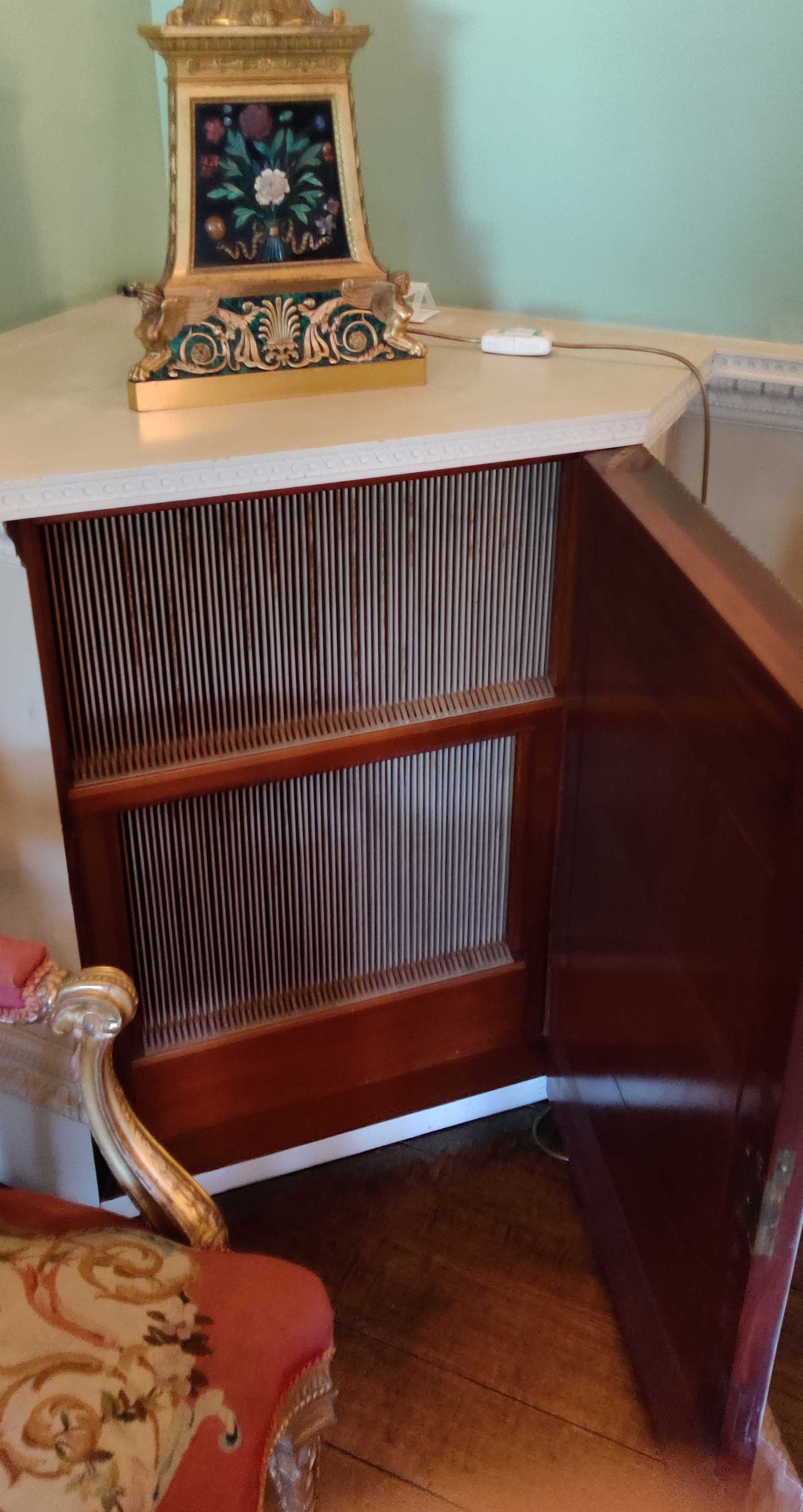

  • A key was found with the gramophone that did not fit the gramophone. On wandering about the music room, I discovered two corner cabinets in the music room that were locked. The key fitted and opened to reveal record cabinets, suggesting that is where the gramophone was located when it was last being used. On my visit, it was exhibited in one of the small dining rooms.
  • Unusual item is the “Ultra- Paradox” counterweight device with a “Lifebelt” and printed instructions. I can see everyone rushing off to make one.
Queries:
  • Could it be an early Expert Senior with unique but primitive looking back bracket brace and perhaps the horn upgrade came later?
  • Could the motor also be a later upgrade?
Perhaps a “posse” of EMG/Expert fans should descend on Harewood House Fund under the guise of CLPGS and get this behemoth up and performing. I’d love to turn up with a stack of records and hear this beast at its best in the most perfect surroundings.

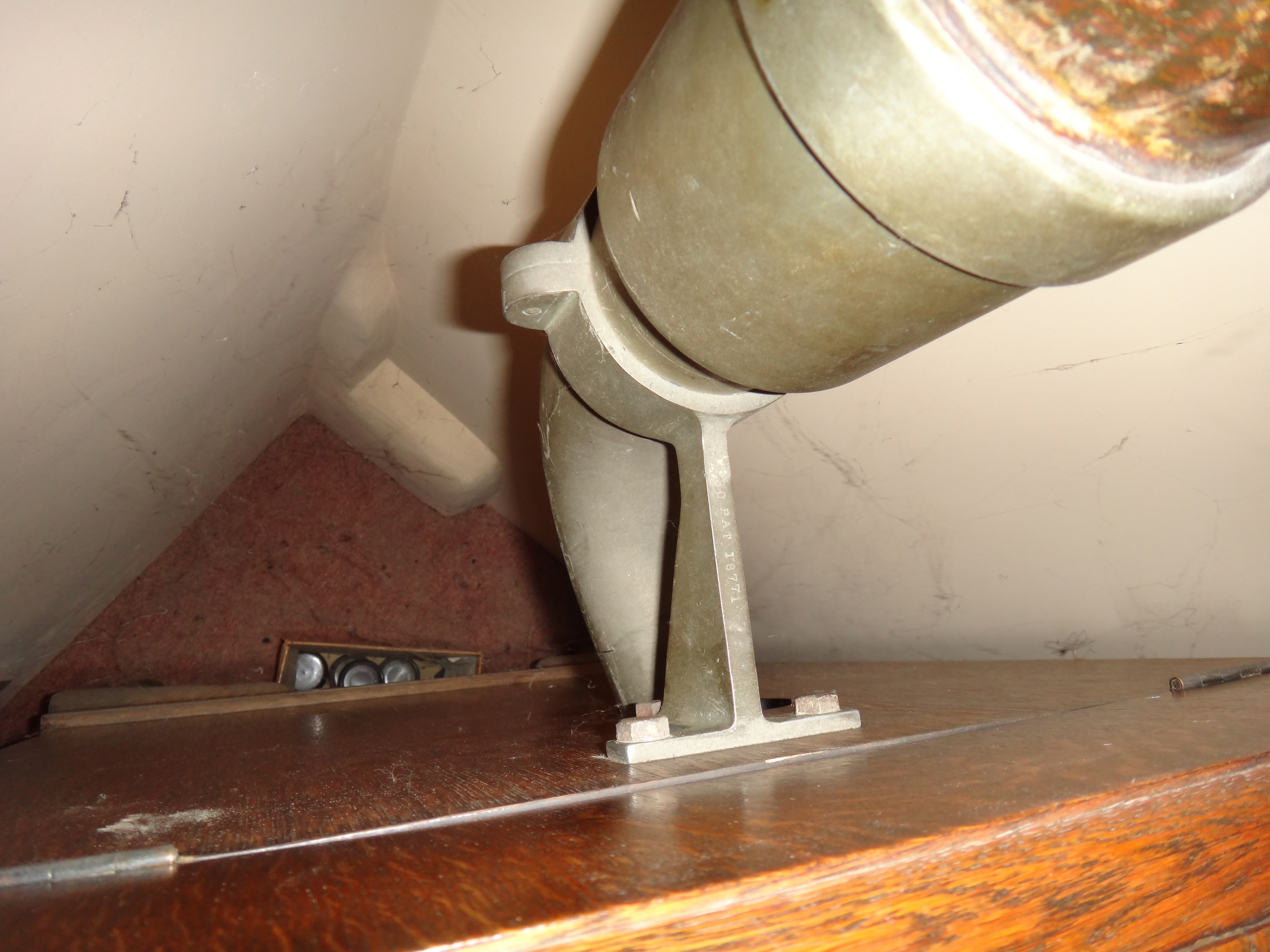

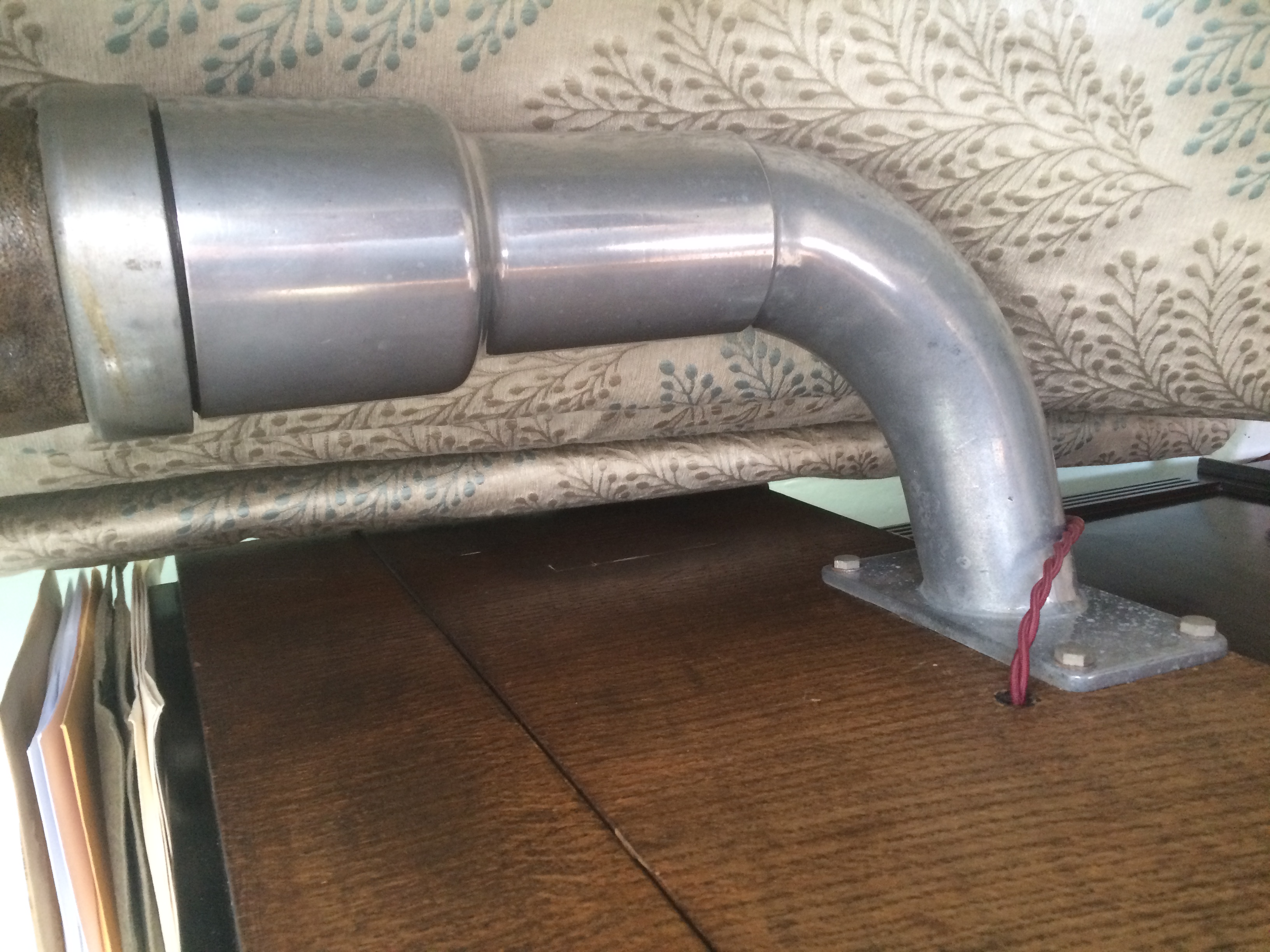

I am a little confused in relation to your comments about the rear conduit which, to me, seems normal for Senior/All Range instruments although it does appear to be made from steel (or possibly cast iron ?) rather than aluminium. Here are a couple of shots of my pedestal Senior which is thought to be one of the earliest examples built in 1930---tone arm bearing flange stamp No.2. It would be interesting to inspect the Harewood equivalent in due course. The magnificent electric motor would suggest a far later date for the whole instrument wouldn't it unless an earlier motor was superceded ? Very difficult to know but my guess would be that motor "updating" has indeed taken place (post WW2 ?). A "forensic" inspection might produce a few clues ? I wonder if the Harewood records (please excuse the pun) might contain original invoices etc ?

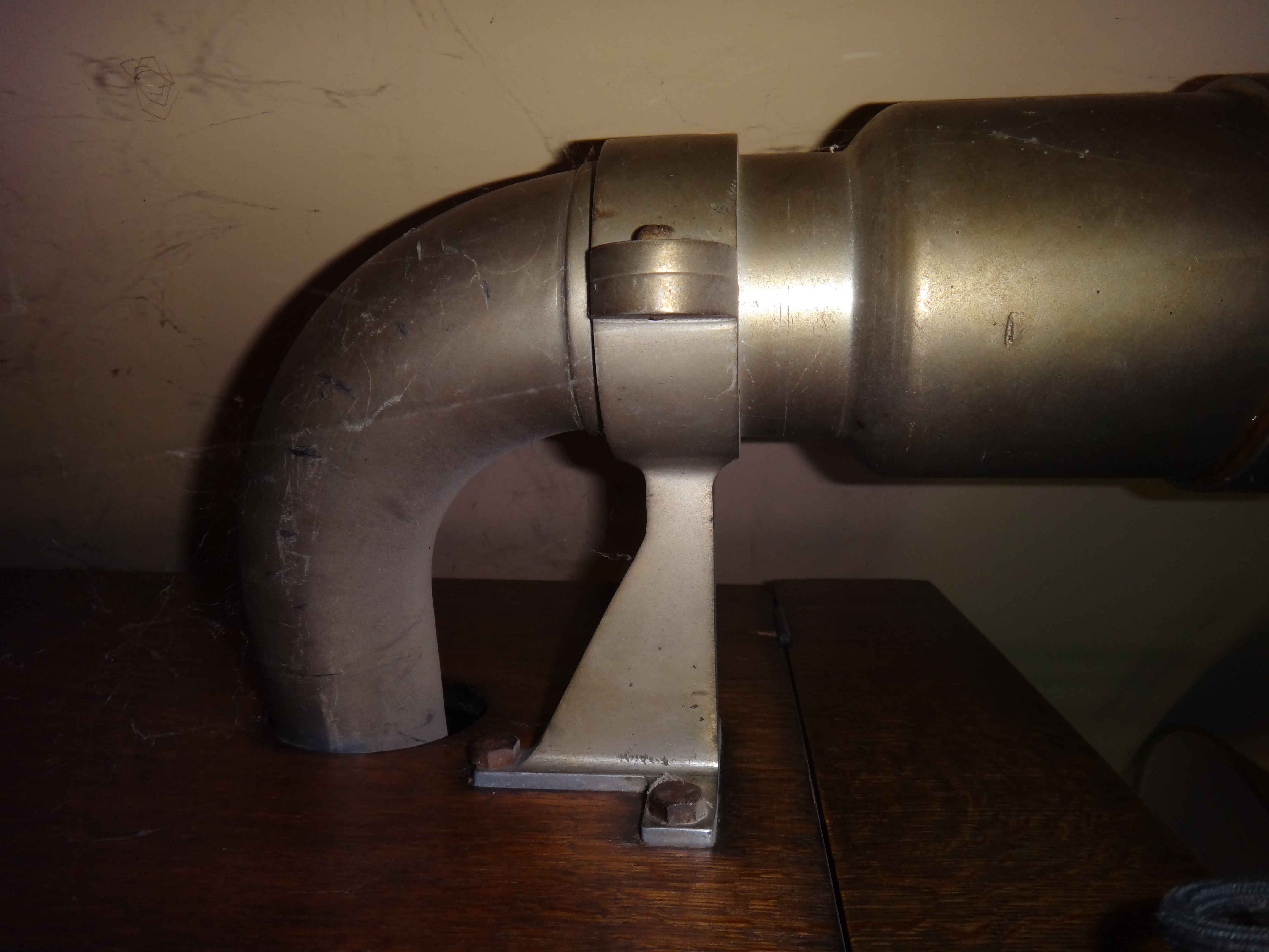

How interesting that Graham's early Senior has the same bracket - mine has none:
(click on photo to see it in its correct orientation!)

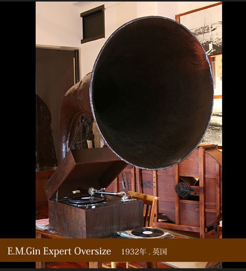

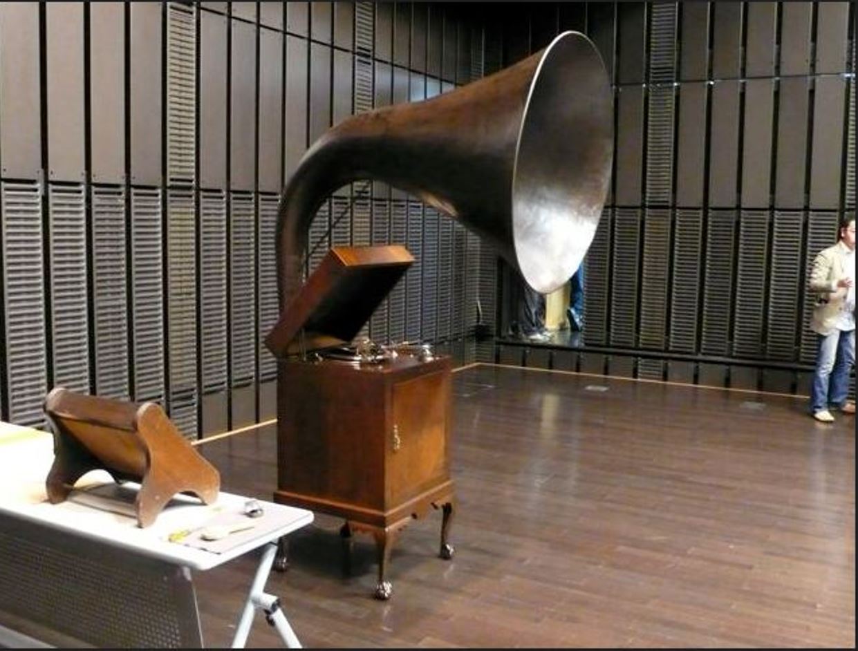

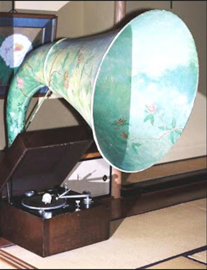

Here are the examples I have come across in the public domain. I think all three are in the Far East. I had forgotten about the beautifully decorated example which could well be an All Range making six I know of together with the Harewood example and the two in Ireland. Whilst I have photos of the latter, their owner might not wish to see them publicised.

Maybe it was just the pedestal models which had the additional conduit support ? Most Senior table models I have seen also had none.

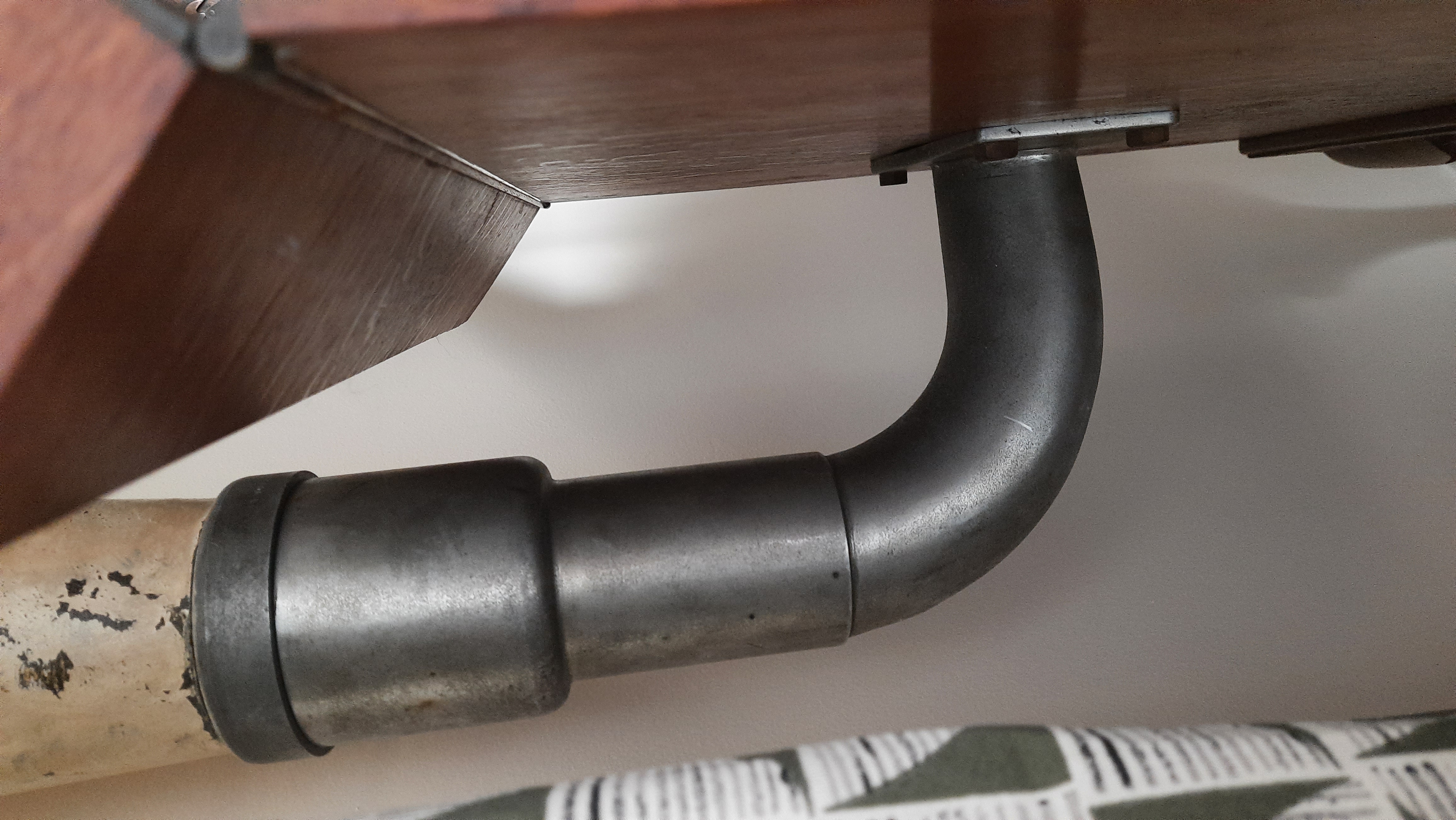

I thought I'd chip in with a picture of mine, which doesn't have the additional support. It might be only the earlier examples which had it as you suggested Graham? The mystery deepens!
