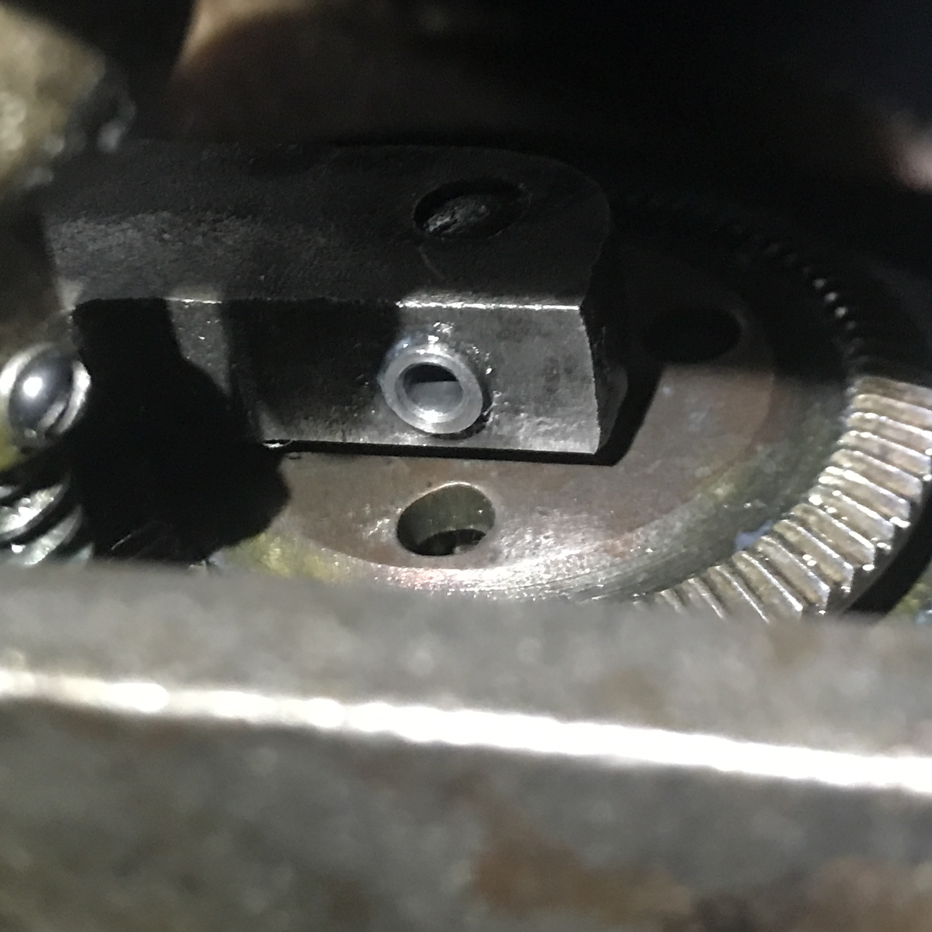

Got it-- Glad you removed those clips-- To get at that ball bearing, you would loosen the set screw on the brass spindle gear (top collar too, but you don't have a screw yet), then slide the shaft through the top of the motor. Then you'll be able to look in the bottom hole to see if the bearing is there. The pic you just posted makes me think the bearing is in place. It look like you have a little clearance at the bottom of the shaft-
BUT- The picture makes it look like the fiber gear is not pressed tightly against the brass spindle gear. It should mate up tightly to the brass gear. Also-- I can't tell from the pics, but make sure the fiber gear is on correctly. the teeth slant a bit- Could it possiibly be backward?
I think you have the problem pinpointed. Once the shaft/gear/bearing issue is resolved, you'll be playing ragtime!

I presume the image included is the bearing? It looks a little off center, but nothing crazy. I do have the gear pressed as close as possibly can be to the teeth of the brass gear it is upon. I fear if I try to force it further, it would end up breaking. And the fiber gear is positioned so the teeth are pointed toward and are pushing the governor with the tips of the teeth. That is how my other machine is set up and it works just fine. Like I said to begin with, it will run, but only when it is at an angle, not when it is level as it would be normally operating.
