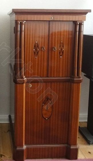

I feel like I have seen this cabinet before in a Deutsche Grammophon catalog, but the basic lines appear to be different. Thoughts?

I would be surprised if this was of Deutsche Grammophon/HMV origin.
Whether it is or it isn't, there are several aspects of concern.
The top is rough and unfinished, suggesting that a decorative pediment may be missing.
An electric motor appears to have been fitted, with the power lead emerging from the redundant winding hole.
The soundbox looks like an HMV No.4 of later date.
