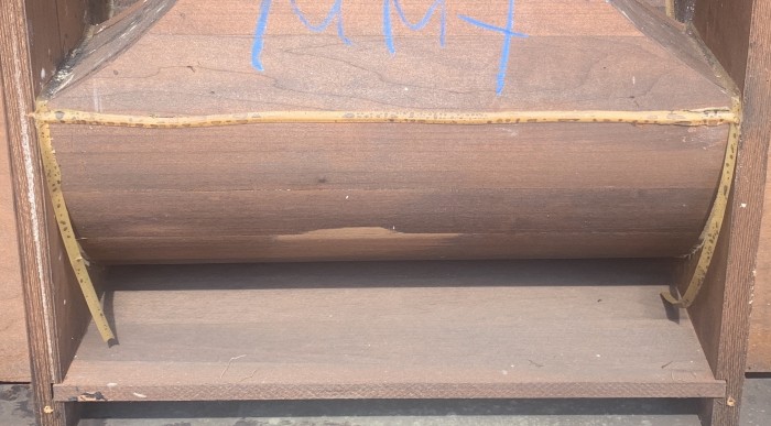

Anyone have any idea what this material is that they used to seal around the horn on my Columbia 710? It's coming off and I'd like to either re-attach it or replace it with something correct or heck, even better. Now where did I put that can of expanding foam? :lol:

Just from here it looks like paper and wax. If I were working on it, I would use thin brown paper and some of that wax ring material you get at a hardware store for sealing toilets to the floor with. Warm the wax, pack it in there with a popsicle stick, paper over the top once the wax is smoothed, and then melt wax & brush it on over the paper. That'd probably do it.

I see no one has responded--yet. Have you examined the material yourself and, if so, what does it look like? Was it a glue that dried to a flexible joint that has now hardened and peeled over time? Or something else? And how easily does the rest of it peel off? I would try to answer those questions first before applying anything new. I wonder--and this is pure speculation--if the original material were something like rubber cement. That does not dry hard (I don't think you want a rigid joint here) and you could peel it off at a later point.

When I opened up the back of my VV 8-12 I used clear silicone calk to seal any openings in the pot metal flange and the wood horn. It just makes sense to me to use modern materials that were not invented in 1927 in areas that no one sees. I would pull off the dry tape and toss it in the trash.
