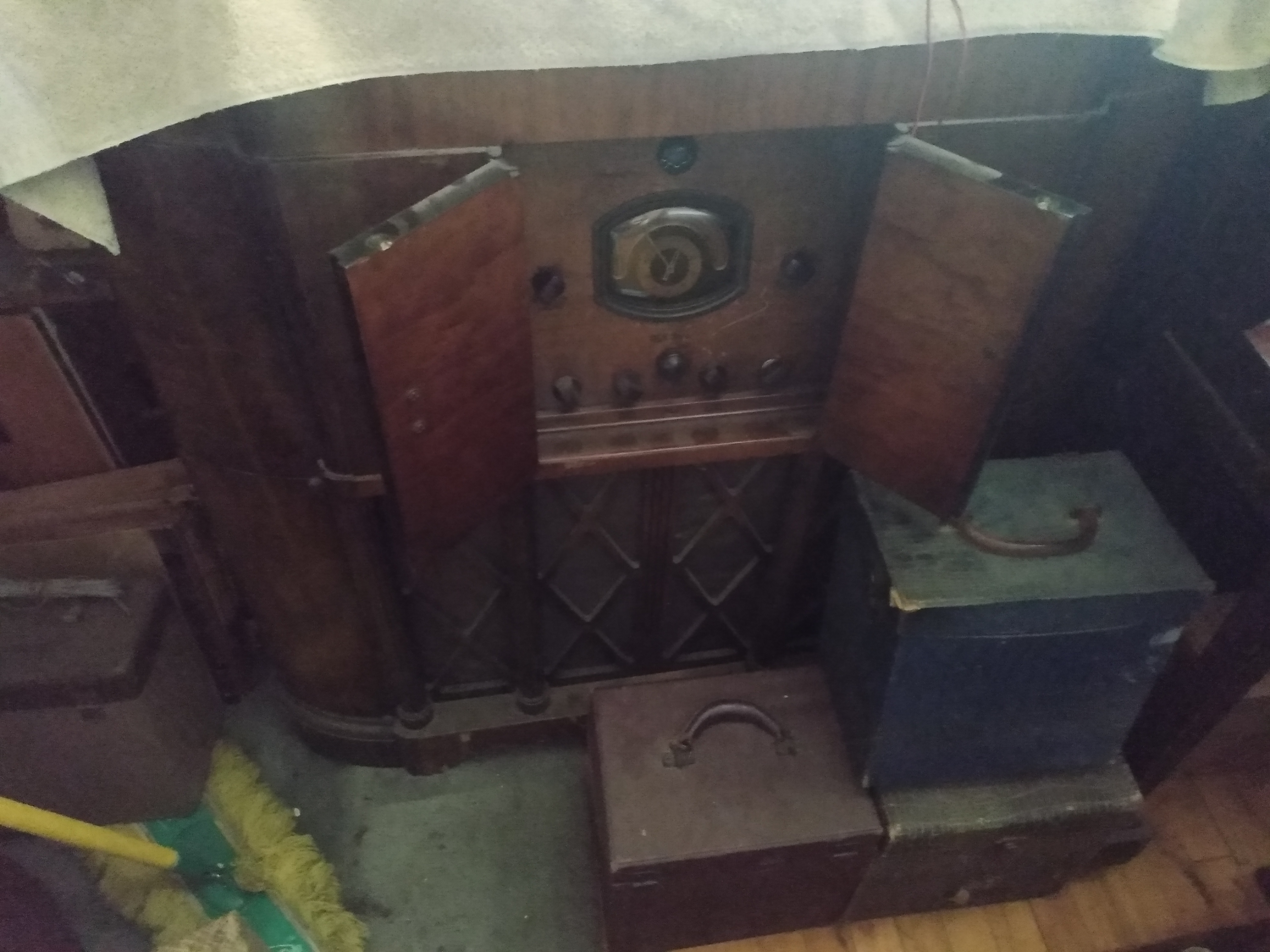

Hi folks,
Any shots at how much an RCA D-22-1 should sell for these days? It's been restored in the past 10 years (motor, amp, radio, pickup) but something went wrong- not entirely sure what, I'll add that tomorrow when I get more info. Unfortunately I have no photos of the inside. This is, for anyone who may not know, the model with 22 tubes. It has the 30s magnetic pickup/cutter, and the gentler changer.
Any input?
Thanks!

Re: RCA D-22-1 Pricing
I can't contribute much to the D-22 price question except to say that the quality of the restoration should count pretty heavily. Though I can't be sure from the picture, it looks like the grille cloth has been replaced; the original was a sort of spider web/lightning bolt pattern never used on anything else. Exactly what failed (I assume it's not working) is critical too; many parts are unique to this machine. All that is not meant to discourage anybody from owning one, especially if they enjoy '20's and '30's music- its performance is astonishing. There may have been physically larger machines than this but (with the possible exception of the Stromberg Carlson 74, which I've never heard) no other horseshoe-magnet pickup machine matches its sound. Once I finished the electrical work on mine it's turned out to be very dependable.

gunnarthefeisty
- Posts: 787
- Joined: Mon Jan 04, 2021 2:57 pm
- Personal Text: Started collecting in August 2020, small collection of records
- Location: Minneapolis, Minnesota
The backing is indeed there. Yes, the cloth has. been replaced. I've been told there may be a missing/misplaced cap. I don't see how that could happen with a professional restoration, but I guess since it's so big mistakes happen. Sometime soon we'll re-seat all the tubes, plug it in, and see if it'll work. It's also got a decent sized piece of veneer missing.
