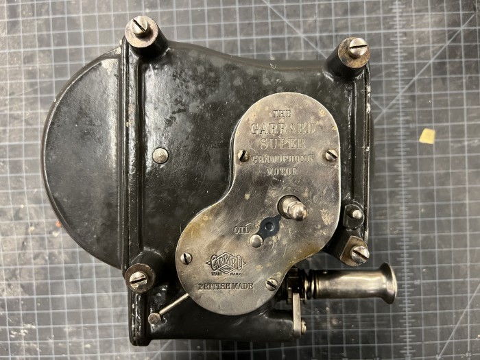

I am almost the proud new owner of a Garrard Super. I probably paid too much, but I have wanted one for many years, and have never seen one up for sale before.
A couple of things I need to know about these motors:
Who has the best replacement springs (is there a good spring supplier in north america)? Where can I find a suitable 12" turntable for it? Is the spindle taper that the turntable mounts on relatively interchangeable across various columbia/victor/HMV models? I will also need a crank for this, though I may wait on that, since I don't know what case I will be putting this in yet, and may need to make a custom adapter of some sort. Is there a standard crank threading for them?

Well, I finally got to opening up this beautiful motor, and assessing what it needs to run again.
The speed control button on top of the motor was sticking, and it freed up with a little bit of oil. No obvious damage to anything, except the sadly all to common sign of some brute using the wrong size screwdriver on a few of the slotted heads of the case screws.
I sprayed some WD-40 into the oil pump area, as a couple of the screws holding the bottom cover for the oil pump mechanism were stubborn due to caked on grease/oil - these two screws or their threaded holes go through the casting and into the oil pump sump. One came loose, and the other is still soaking.
I cranked the motor over a few times, and got fluid to come out at the top of the motor, which made me very happy.

There is indeed a broken spring, so I’ll need to replace it, and will be smart and do both at the same time.
The springs are a little less than one inch wide by .026” thick. This agrees with Chunny’s website where they’re listed with those dimensions by 16’ - 9” long.
After oiling all pivots and the governor manually, I spun the main gear, and it is really impressive how long the gear train keeps spinning. I can see that this motor is going to run beautifully once I’ve got the new springs and finished cleaning it up inside. Worth every one of the many pennies that it set me back both to purchase and then have shipped to the states.
Fingers crossed that one of my existing cranks will fit the coupler on the motor. If not, it should be easy enough to make a new coupler or make a new crank to match the existing coupler.
