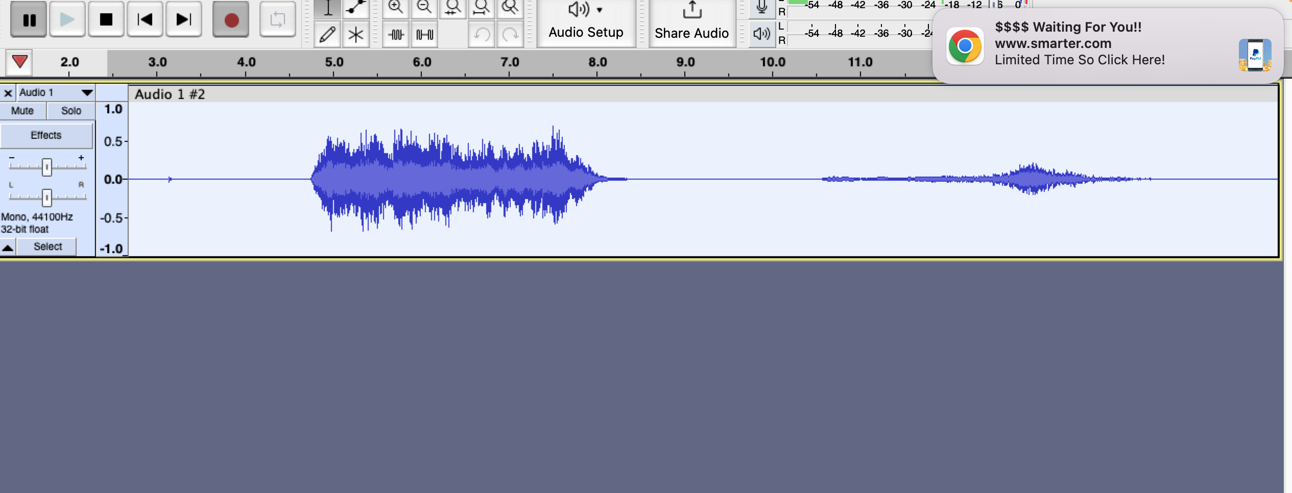

Hi Everyone,
I recorded the sound wave of my Home-made Gramophone using Audacity. It is the beginning of Grieg's Peer Gynt No.2 Symphony London Record. I have no idea what it shows. Thanks.
Hideki
Hideki

This is amplitude against time. If you look for the spectrum, which audacity will have, I believe, you'll get a picture of the frequency content...

That's right--to see the plot spectrum, go to Analyze-->Plot spectrum…; then a pop-up with a graph of amplitude versus frequency should open.Inigo wrote: Thu Nov 03, 2022 5:48 am This is amplitude against time. If you look for the spectrum, which audacity will have, I believe, you'll get a picture of the frequency content...

Here is the another one for the same recording.Watanabehi wrote: Wed Nov 02, 2022 9:59 pm Hi Everyone,
Hideki

This graphic can be analysed to extract conclusions, but to test a gramophone, the ideal way seems to me to be this: to record in the same circumstances several records of different types of music, and then add or join all the wave files in a single one. First you'll have to use, on each one of the files, the audacity facilities to remove the bias or DC component, and then level the files to the maximum volume (maximize feature) proceeding one by one. After that process, you can add all them together, one behind the other.
Then the spectrum analyser can be extracted from all the records, so you'll have s more clear picture of the overall sound of your gramophone... played in that particular environment. To judge only from one record didn't give the complete image except for that particular record.
Of course you can do it also without any pre-processing of the files. It could be interesting to compare both spectra, the pre-processed one and the raw one.
Judging by one sole record, I can see narrow 'holes' in the reproduction at 650-900-2000-3000-5000 Hz in the general decay line from 300 to 11000 Hz. Although these peaks in the high frequency range could be parasites from the recording. Or the recording is a later one, Decca ffrr type post-1945, which had a surprising treble response.
Of course, to test the response of the machine, the best is to use post-1945 recordings, or the most modern ones you have, or a sweep frequency test record, if you have one.
I don't have one, but I have a fixed note recording at the back of one record, and I used that to test (only by ear) my 194. I played it very slowly, then raising uniformly the speed, etc, so I managed to get a kind of sweep. I noticed by ear clear points of high intensity, resonances of the horn, and some 'holes' in the frequency sweep. Curious.
I don't know how these programs calculate the spectrum, but I've always observed this slope from the mid bass to the high treble. Clearly the energy captured goes down towards high frequencies. I think that some kind of 'normalising' would be required to see this slope as an horizontal line, so you can compare different spectra. All the programmes I've used show this mountain shape. Then you go to the books and see the spectra diagrams of different machines, and they show an horizontal line in the 300-4000 region. Clearly the energy is measured in another way. I'm thinking of the Percy Wilson book, for instance.
