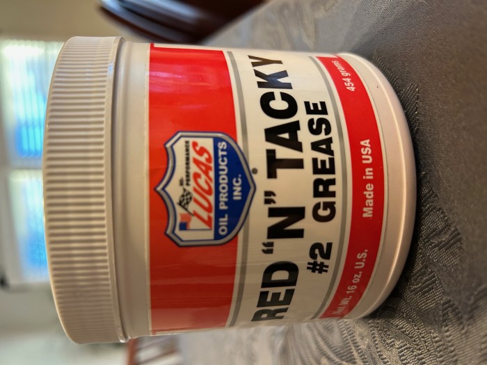

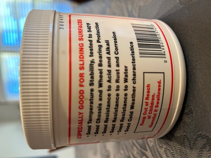

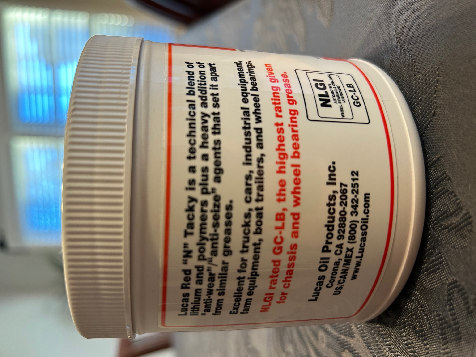

Has anyone ever tried this grease for motor springs? From the description, it sounds like it would be ideal, and the consistency is perfect. Not sure why the photos are sideways - my apologies!

Tacky is not what you want for spring coils to slide* nicely against each other. Tacky is what causes thumping. It'll be interesting hear from anyone who has tried it. I'd be happy to be wrong. :oops:
*Yes, I see where it says good for sliding surfaces. I believe the case of sliding spring coils may be somewhat different than what's alluded to on the can.
