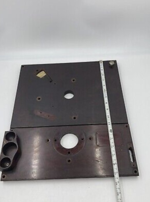

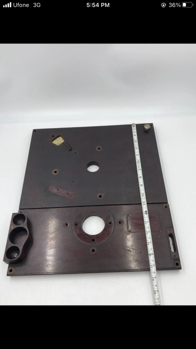

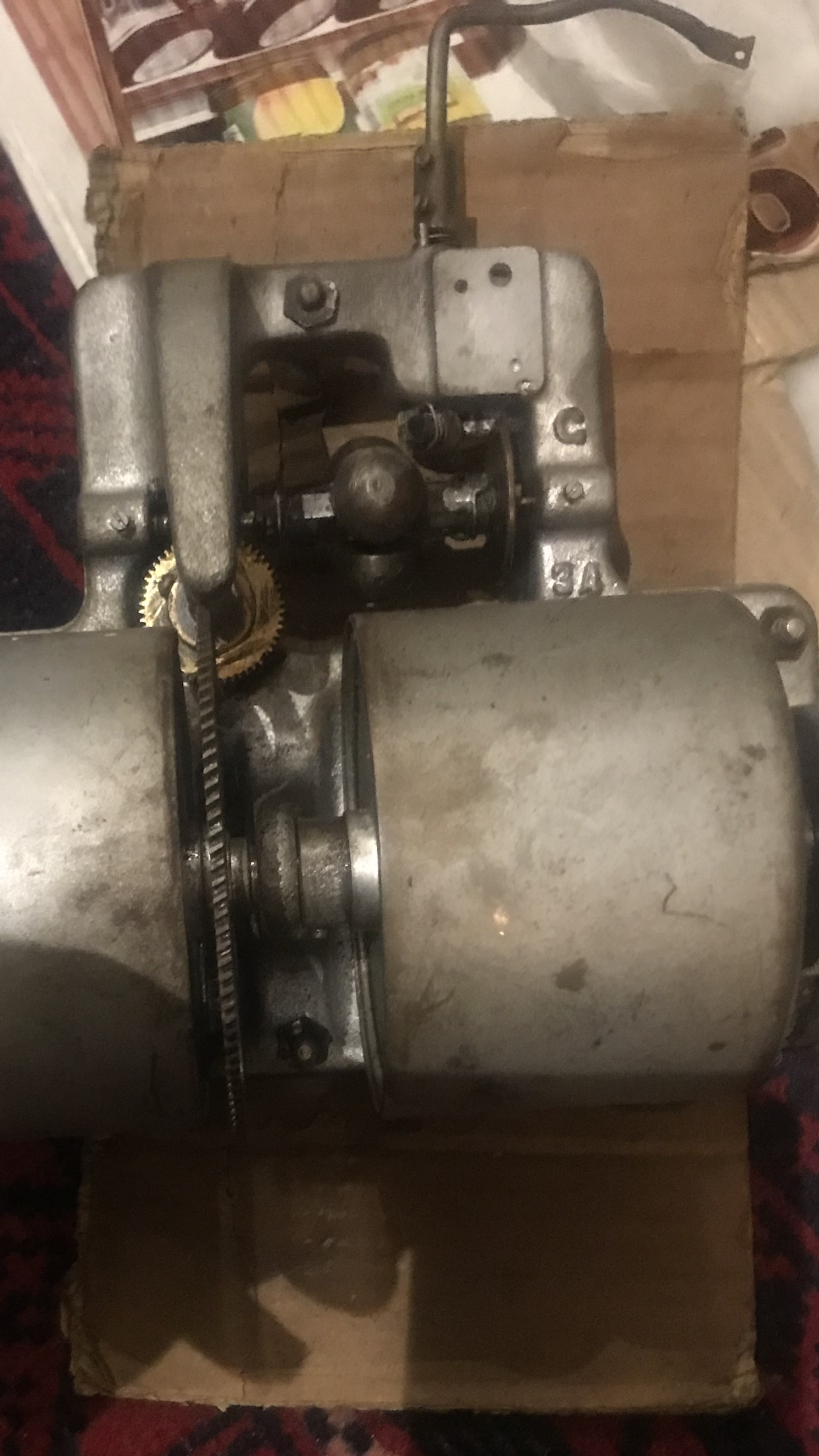

Hello! Will you please suggest which type of Victrola tonearm and reproducer should I buy for this four spring machine?. Please also suggest the appropriate Victrola plate indicating the model number for this machine which I should buy for this phonograph. The pictures of the motor board and motor are here so you could suggest.
Please note that the brake I have is the short arm type. Does this mean I need a long arm tone ? Please advise

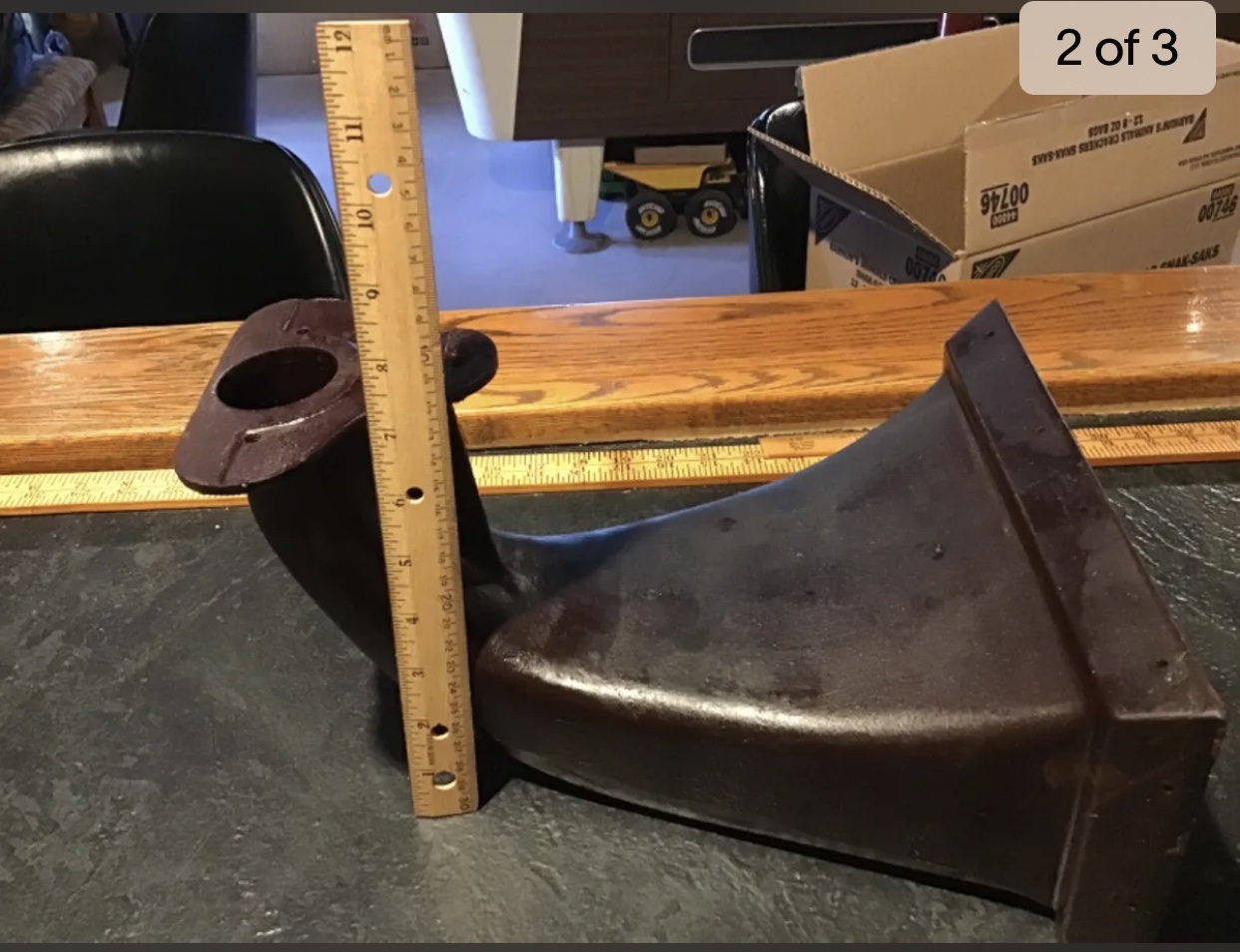

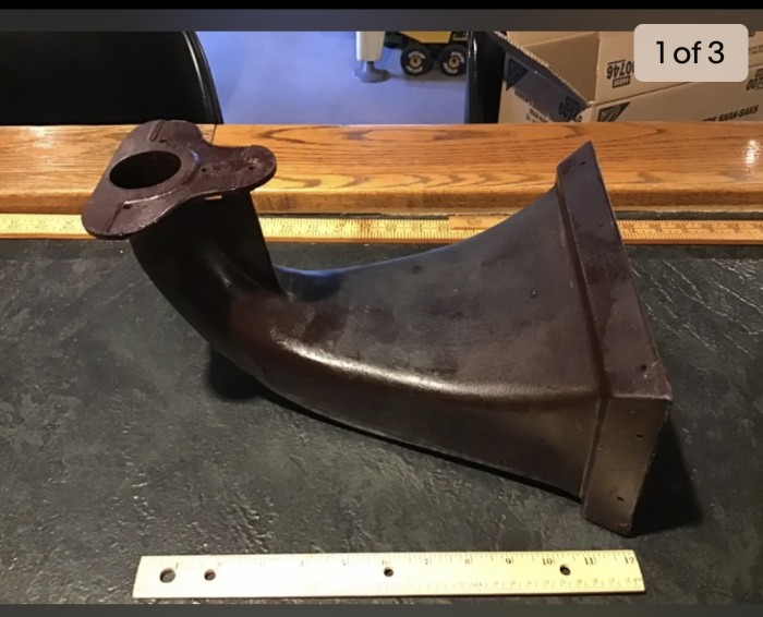

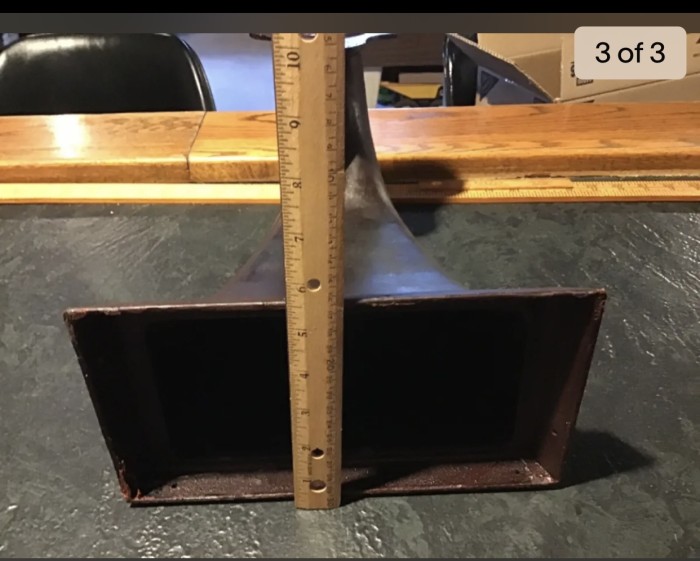

If you provide the forum with a better photo of the tonearm hole and its screw holes, and measurements of them, and the distance between the center of this to the center of the motor spindle hole, someone in the forum might help and tell you which tonearm(s) would fit all this... Also, do you have the horn? This also gives a clue...

Re: Which tone arm ?
The approximate distance from center of spindle to center of tonearm hole is about 6/Β½ inches. Here are the pics with actual measurements. Please advise. Thanks

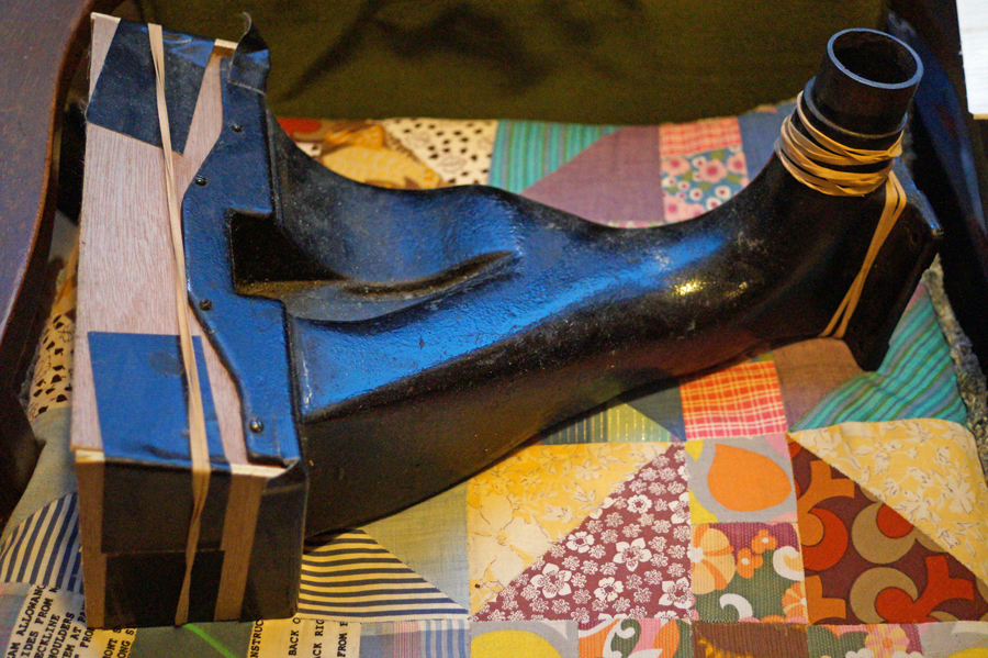

Your horn reminds me of my mystery horn, which some time ago I used to play records using blutooth.
If yours is anything like mine then it is VERY HEAVY !
(My mum made the cushion it is resting on incidentally).
Looks heavy but actually not
just 8 pounds
Well, mine weighs 11 pounds - maybe not that heavy either - perhaps I just need to exercise more .................
