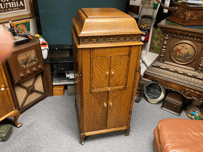

The "factory second" VTLA is so interesting. My later oak VTLA was assembled with such detail and precision. The slot in every screw was perfectly in line with the next. Even screws not normally seen were in line. I have seen quite a few Victrolas and this is the first time I've noticed such precision.

Your VTLA looks like a real showpiece. Aligning the slots is above and beyond, but a nice touch just the same. Your Oak VTLA would be the centerpiece of many collections.

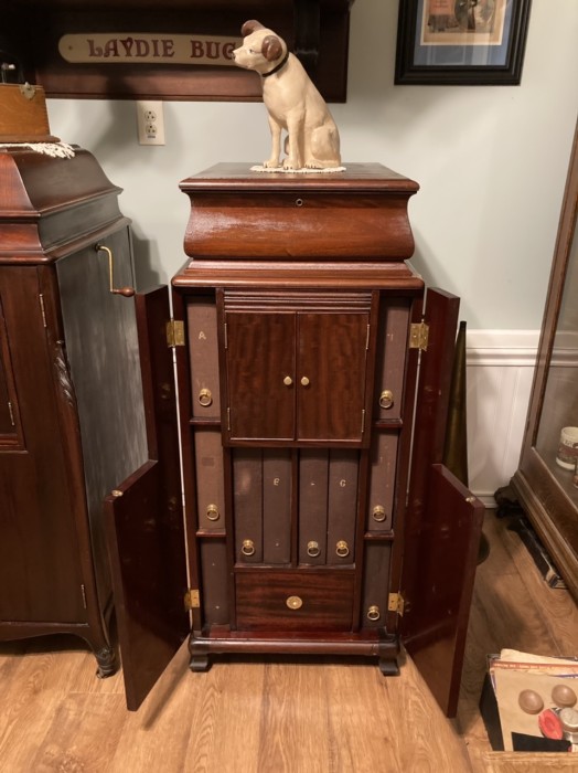

Regarding my VTLA, the cabinet was built by Pooley, so it may not be fair for me to include Victor.
I would suspect that the cabinets would have to have been crated before being shipped to Camden, so it makes me wonder if the phonograph parts were installed at Pooley and a closed crate was all that Victor would have seen. For all I know, (and maybe somebody knows the correct answer), the Pooley VTLAs may never have been in the Victor factory and been shipped from Pooley to the dealers or distributors. That would make good sense because it would save on shipping and handling.
I am surprised, (and glad), that the large “L” door, held in place by two small screws, managed to stay in place for 116 years.
Maybe I should have preserved the defect, but I don’t want to have issues, so now the door has all of the screws that it should have had when it left the factory.

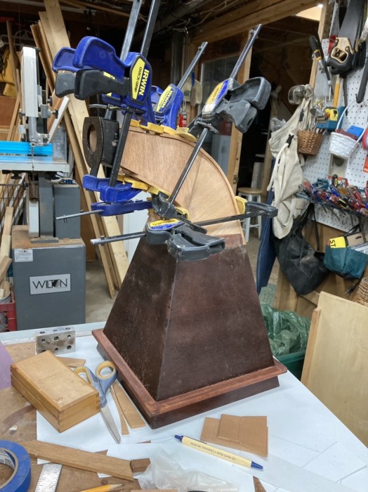

The Pooley VTLA-Victor-Django machine is coming along in spite of itself. The new, reproduction drawer is in. The new horn is coming along, (the bent parts have to set for a couple days before getting trimmed and glued). The bell of the horn is from an L-Door. The casting is original and the rest is new, solid Mahogany that would have been a guitar. The motor should be here in a couple weeks.
Skihawx was kind enough to to let me look at his machine, so now I can make a fairly accurate horn and motor board. I coped the dimensions and joinery from his drawer.
I am becoming optimistic that I will be able to end up with a fairly authentic machine in the end.
