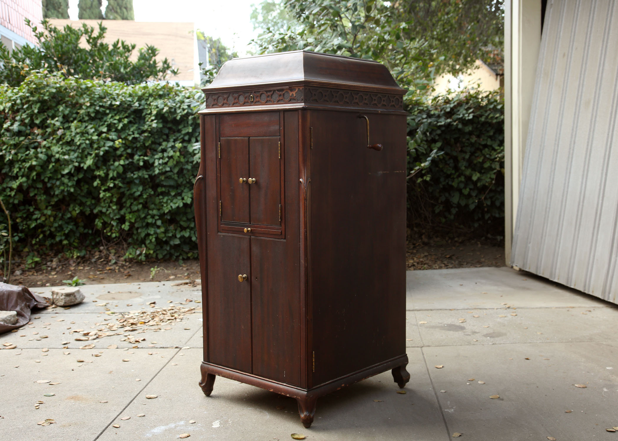

I intend this to be a restoration thread, but I’ll need some help from those of you that have experience. Here are some photos as it currently stands.

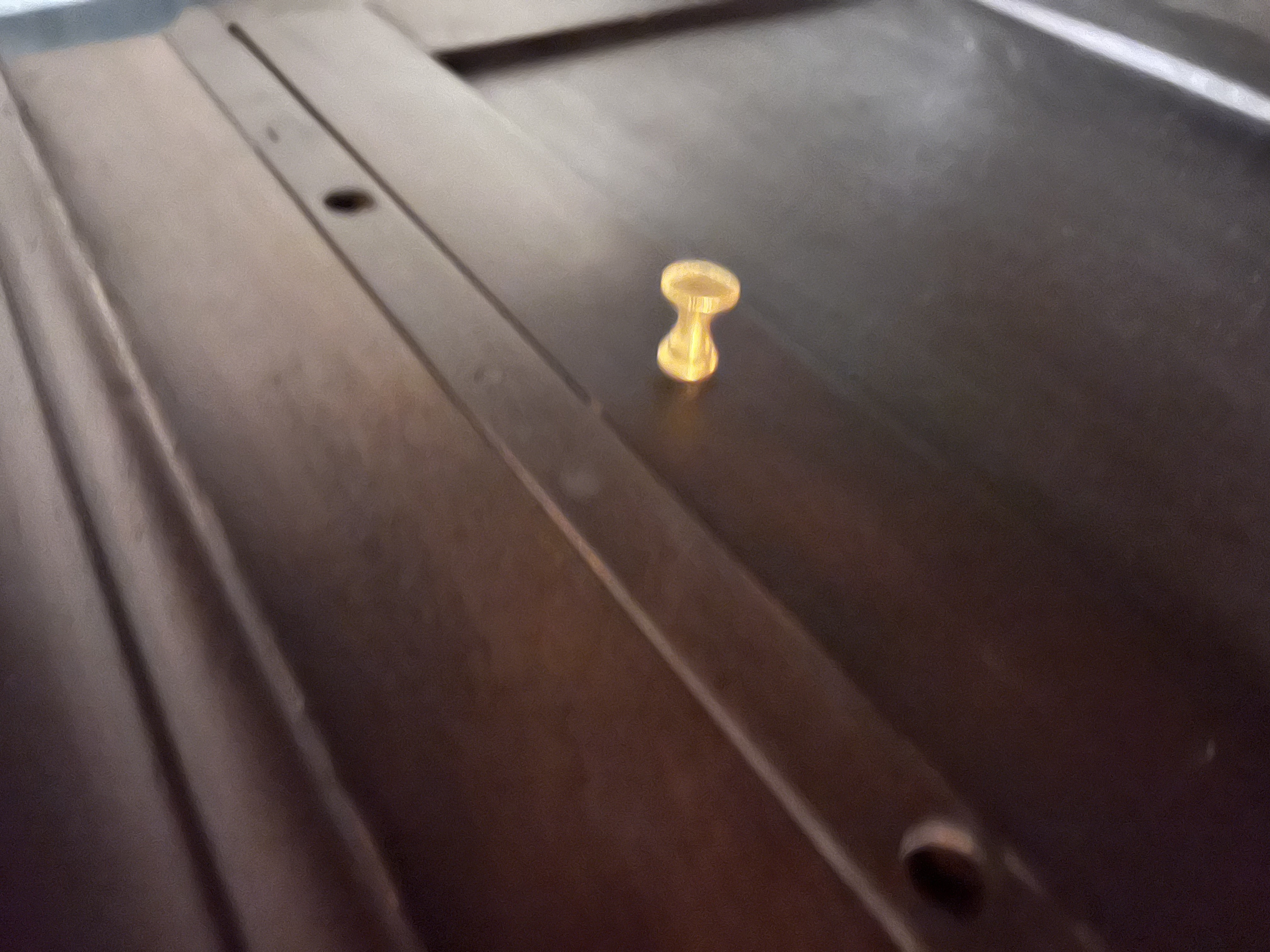

The knobs were all pulled off and in the parts drawer, so I guessed what went where. I’m missing one of the larger ones. I think the one I used for the shelf really belongs on the rear access door (it fits better), but I don’t know if they looked like that. Were they the same?
As you can see, this poor machine got wet at some point.
The lid is warped and missing the veneer on top. I wonder which way the grain ran - front to back or side to side?

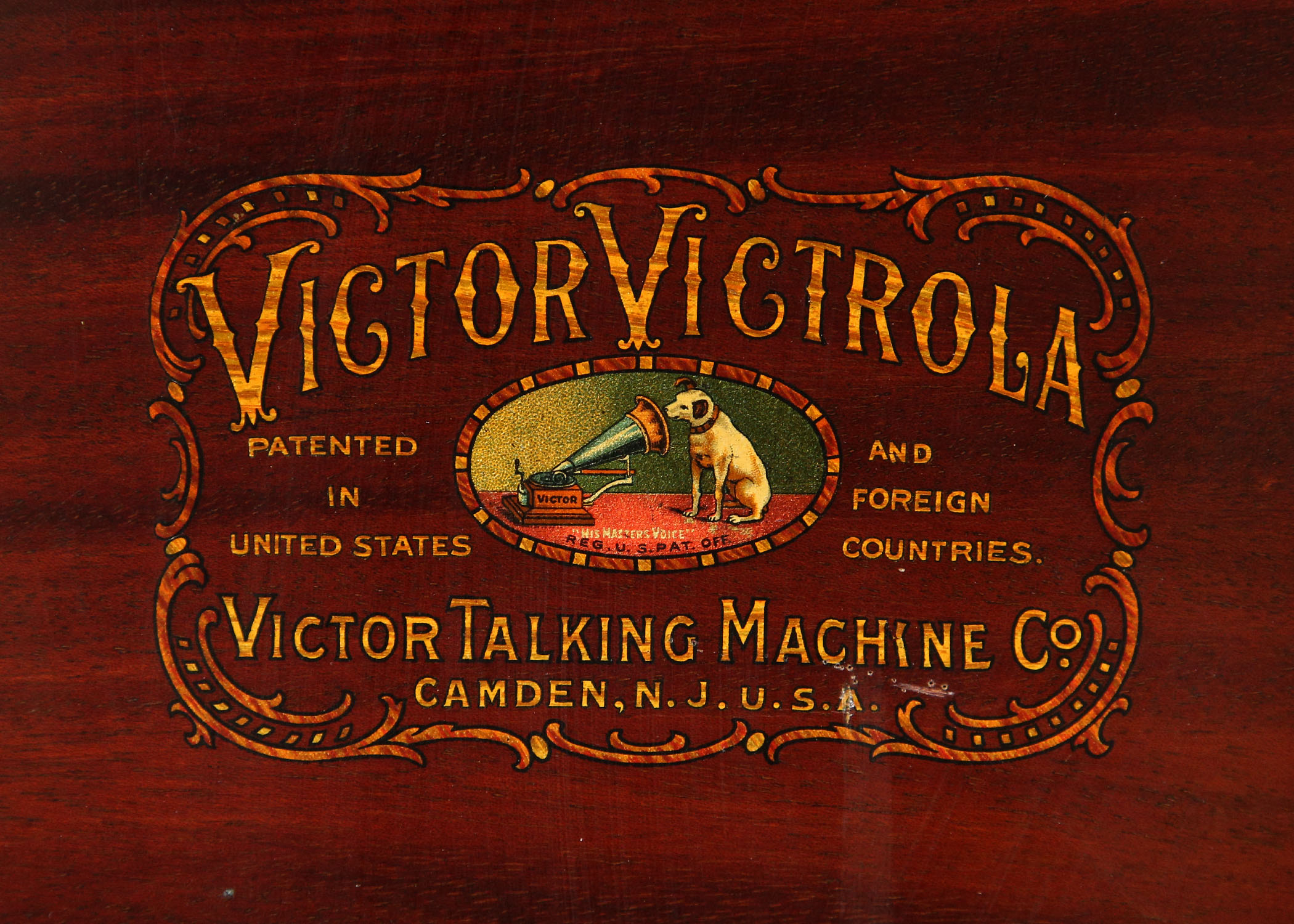

The inside of the lid looks better, but the warp is there. I love the early decal. Note the installation defect on the lower right.

My inclination is to reduce the most egregious-looking damage and go for a cleaned-up but not new look. The lid will be a real issue. I’m still not sure how to address it. I’m not sure how flat it can be made without messing-up the inside with the nice decal. In any event, I’m going to take my time on this. In that time, I’ll be looking out for pieces, repair schemes and any advice I can get. Thanks for looking, and let this be a lesson to you all.

My VTLA is serial number 7124, so very near to yours. The crank escutcheon is a kind of "press in" affair with only a small ring showing on the outside of the cabinet. The grain on the lid top matches the direction of the lid's interior. Left to right. The crank looks correct.
I have the large knob you need. PM me with your info and I'll send it to you. Mine was missing the back door knob, so I cannot definitely tell you which one should go there. I have one in place, but it may not be correct. I recently got a large "lot" of parts and the large knobs were in that lot-glad to send you one.

Well, thank you Matt. The information is very helpful and the offer of the missing knob is extremely generous. I will PM you with my info.

For the present, I think the big knob will do nicely. I don't quite yet know how, but I'm going to try to save the original saw-toothed lid prop. I like its primitive look, but I can see why they migrated to the sturdier design. Thanks again for your amazing help!
