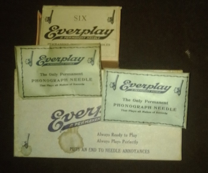

Re: Modern tungs-tone stylus
No, not that I'm aware of.
If however you're wanting to use tungsten to play records, it's probably worth searching for an Everplay needle.
They use a coil of tungsten wire that can be fed to the playing tip as the wire wears down.
I've never used any of mine but apparently they're a popular choice for use with early record changers, and tungsten wire of the same gauge is still available so you can replace the wire coil once the original is used up.
A note on the Everplay- I have a few and find them very useful, but primarily on acoustic machines. I've tried them on many different types of electric pickups (acoustic and crystal) and they produce a pretty harsh sound, especially on higher frequencies. The culprit is the wire coil and wheel to turn it (the unit resonates quite a lot). When using on an electric changer I have a piece of rubber similar to viscaloid that is lightly compressed by the top of the wheel and bottom of pickup. I got this idea from some of the pickups in RCA phonos that have the viscaloid damening strip around the thumbscrew. This eliminates the harsh ringing sound, but to my ear is not as fine sounding as a good steel needle. However, this does allow me to utilize the auto changer on some of my pickups too heavy for a Bent Shank Sapphire needle. The Everplay on acoustic machines is perfectly fine- it sounds like a medium to loud tone needle depending on the brand you typically use.
Thanks so much for posting this information.
As someone with absolutely no experience using an Everplay, you've saved a lot of trial and error on my part if I ever do decide to use one of mine.
