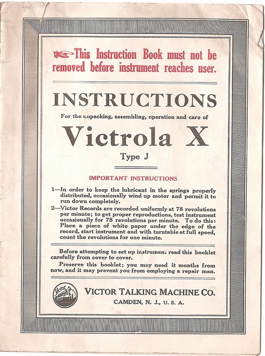

I found this online. It's the cover of a manual from 1916 and by that time Victor claimed to be recording at 78 rpm. If anyone has anything from Victor that states that the speed is 76 rpm, please post an image. Thanks

Oh, Victor lied like a rug about its recording speeds. I often say, the one speed acoustic 78s never seem to run is 78 RPM, and in fact if you match the speed of Victor records against score pitch they usually come out at somewhere south of 78--75 and 76.5 are common values. I've had them, and not so early as to be a matter of "oh, that was in the beginning days," come up as around 72. And here's a dirty little secret that came as a surprise to me once I started really paying attention: Victor kept right on claiming 78 and recording at 75 or 76 for several years after the introduction of electric recording. 78 became fairly reliable only around maybe 1930 or so, at least as far as I can tell.

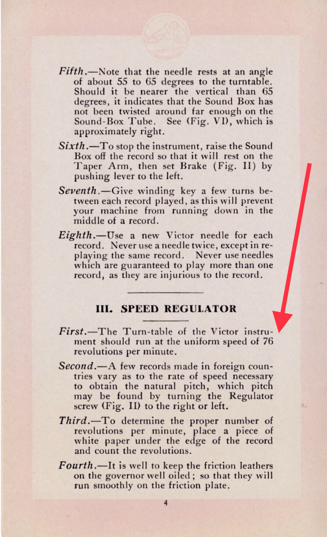

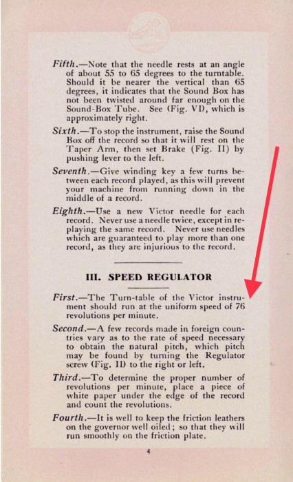

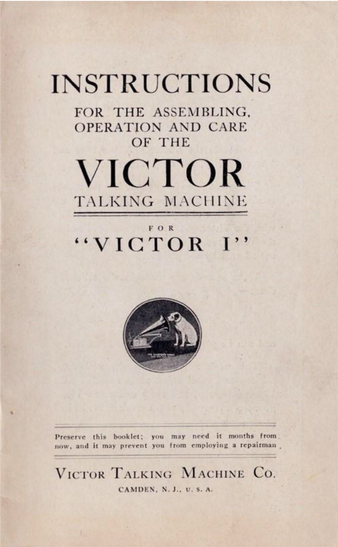

Here is the user’s manual for the Victor I which documents the 76RPM figure.
The entire manual is available in the APS Library.
Mark
Mark

Thank you for sharing that. So it seems that at some time Victor changed from 76 to 78 rpm as their standard.MarkELynch wrote: Fri Dec 09, 2022 6:31 pm Here is the user’s manual for the Victor I which documents the 76RPM figure.
Mark

"Django wrote: Fri Dec 09, 2022 6:56 pm
Their stated standard. Victor kept right on recording at slower speeds long after it started publishing "set your turntable to 78 RPM" instructions all over the place.

Edit: The manual for the XII also says to set the speed to 78 rpm, so that would mean that Victor’s “standard” speed was 78 rpm in 1910. So it appears that Victor quietly changed the speed from 76 to 78 rpm some time between 1908 and 1910.

The change of the markings on the speed control from 76 to 78 may have been done quietly, as suggested, but it is more likely that it was discussed in one of the Victor Executive Committee meetings. The Victor meeting notes are highly detailed and cover a wide range of topics. Things like motor details, production figures, recording contracts, new models, buying new turbine equipment for the powerhouse, changing salaries, payments to widows of workers killed at Victor, etc. There is even an entry that says every employee was to be given a Turkey and cranberries at Christmas. Based on this I strongly suspect that something as important as remarking the speed control would have been discussed and recorded in the weekly meeting minutes.
The Committee notes for many years are available at the Hagley Museum are available on-line. Unfortunately the earliest year posted at the moment is 1914 and makes no mention of the speed markings. Perhaps notes from earlier years exist but haven’t been made available yet. I hope so!
The change from 76 to 78 on the speed dials may have been revealed to the dealers via the Victor dealer magazine “The Voice of the Victor” I looked into this but have very few from the time period in question. Perhaps others here have a more complete library. Hagley has a few from 1909 but they contain no mention of the speed question.
It is also possible, but I think less likely, that it was revealed to the trade in general via the tabloid “The Talking Machine World (if that was being published at this time). Again, I have no issues that might cover the time frame we are interested in.
