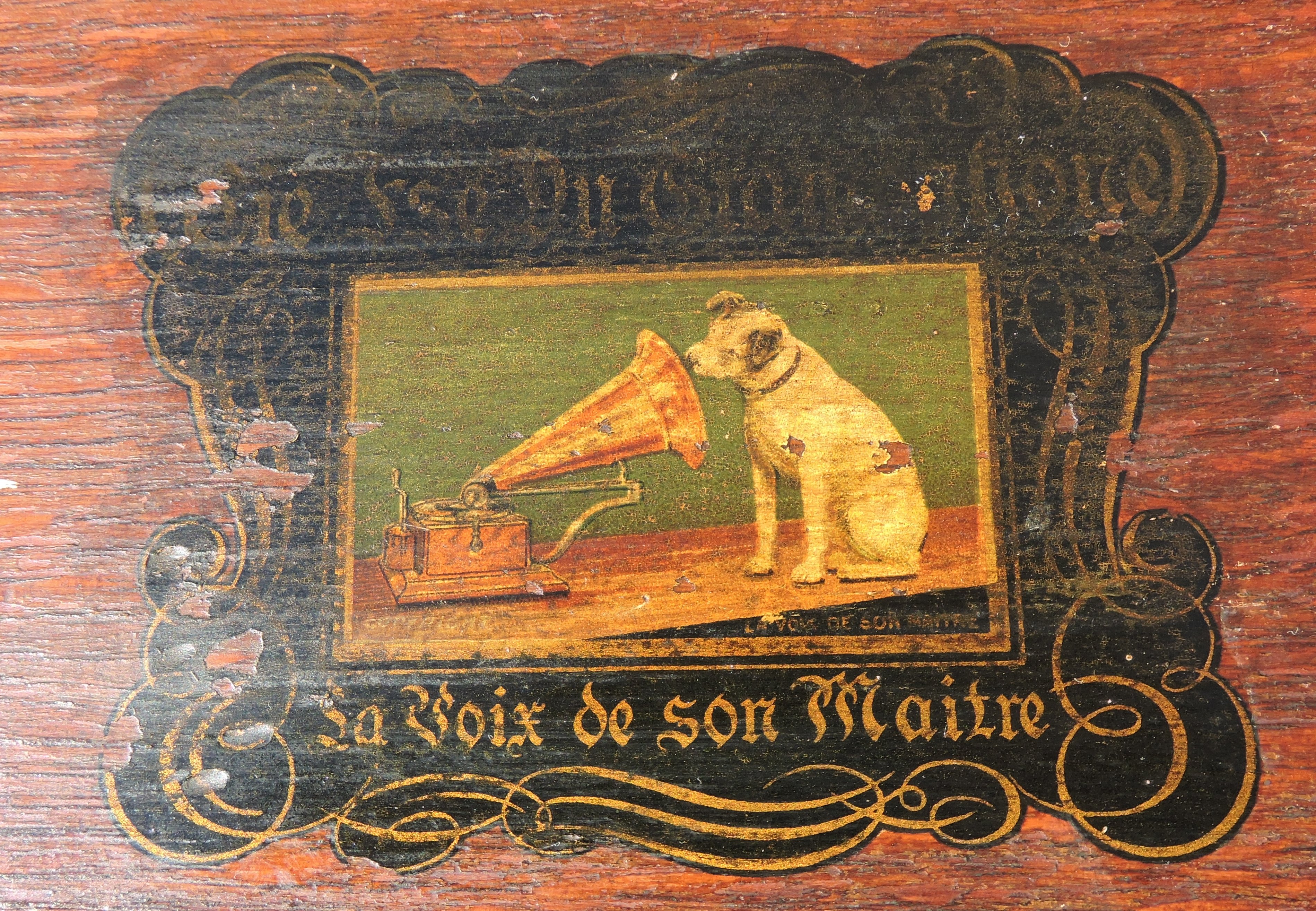

Something else that's just occurred to me looking at the photos, I believe the horn is indeed a replacement MG anyway as it appears to be the smaller type with 9 panels. I'd expect to see the large MG horn on a No. 7.
gramophoneshane
- Posts: 3463
Re: Please, help to identify this early La voix de son maître gramophone
I suppose there's always the possibility that along with the smaller motor, this "special"(?) 7 also received the smaller horn for export to France.
OnlineSteve
- Posts: 3896
Or (clutching at straws), that the "S" means Small.....motor and horn?
The transfer is certainly an old one but I don't know if it's a factory one. I think we saw the same one on another gramophone but I didn't find a pic.
Although the label is hardly readable, given that the cabinet is in oak with a mahogany finish, it should be HFOS. By the way what the H and F mean? (I'm sure it's not high fidelity!....)
Steve, we put a different horn and it does look better. (again what means MG?)
We assume that the “gold” finish on the arm is not original as it rather looks as a varnish in poor condition; so should it be nickeled?
Thanks again for your help

OnlineSteve
- Posts: 3896
The cabinet is not a mahogany finish. It's an oak cabinet with a pigmented varnish applied to it which can go a slight reddish colour with age. The original catalogues claimed these were "waxed oak", but they were anything but.phonodesbois wrote: Sun Dec 11, 2022 5:26 am The transfer is certainly an old one but I don't know if it's a factory one. I think we saw the same one on another gramophone but I didn't find a pic.
The gold arm could be either very tarnished nickel which will polish back to bright silver or it could be very worn nickel which has left the brass base metal showing through. Photographs are unreliable to determine this unfortunately but with a bit of experience you should be able to decipher which it is with the machine in front of you.
The transfer is the original factory applied one.
MG is lazy Internet speak for Morning Glory horn. Sorry, I've fallen into that trap of using abbreviations when I casually assume everyone must understand what I'm referring to!
HMV used a peculiar numbering system for their machines which gets further confusing with their use of letters for the same model. The "H" refers to it being an external horn model. The "O" refers to the oak cabinet. The "F" refers to the model denomination, in this case what was described as a "Model 7" in UK catalogues but what might have also had a different number in France.
Hope this helps (HTH)
- Posts: 4648
My French HMV Style III has the same decal:
This has also a dealer plaque from Eugene Hermann, from Metz. It came with a record with a sticker from the same dealer, and even I got an old photo of that store from the web.
