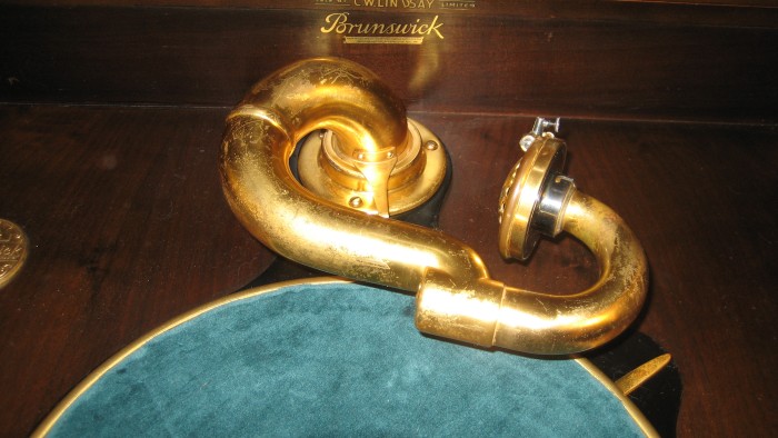

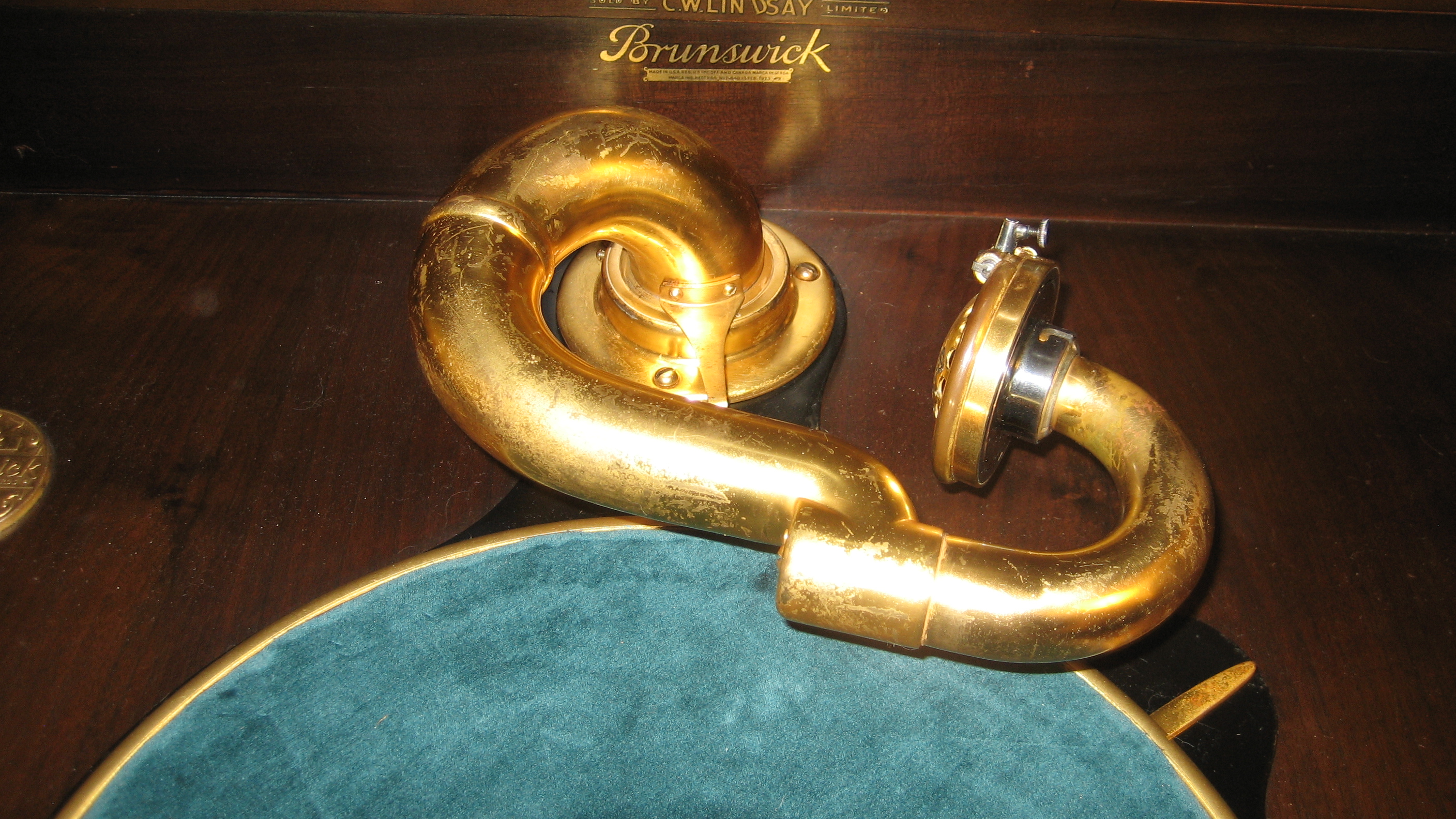

I forgot to mention that my Cortez has a longer tone arm than a regular Cortez tone arm. It seems that My Cortez tone arm has better tracking. I will post the photo of it later. Thanks.
Hideki

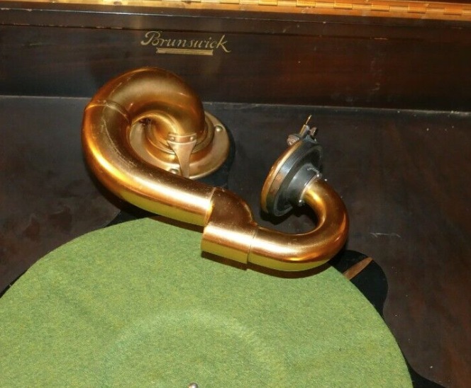

Here are the photos of my Cortez tonearm and a regular Cortez tonearm.
Hideki

CarlosV
Posts: 2194
Location: Luxembourg
Re: Cortez in Collins Mississippi- $400
Post by CarlosV »
Watanabehi wrote: Mon Dec 12, 2022 7:42 pm
Hideki
My Cortez has also the long tonearm. I do not see any significant track issues with the Cortez design. The Cortez design shortcoming, as I mentioned before, is the hard coupling between soundbox and arm, that impinges higher wear to the record surface and does not provide the necessary acoustic isolation. This issue had been identified and solved by most brands since very early times (most Victor, Columbia and Pathé soundboxes had rubber isolators almost from the start of their production).
