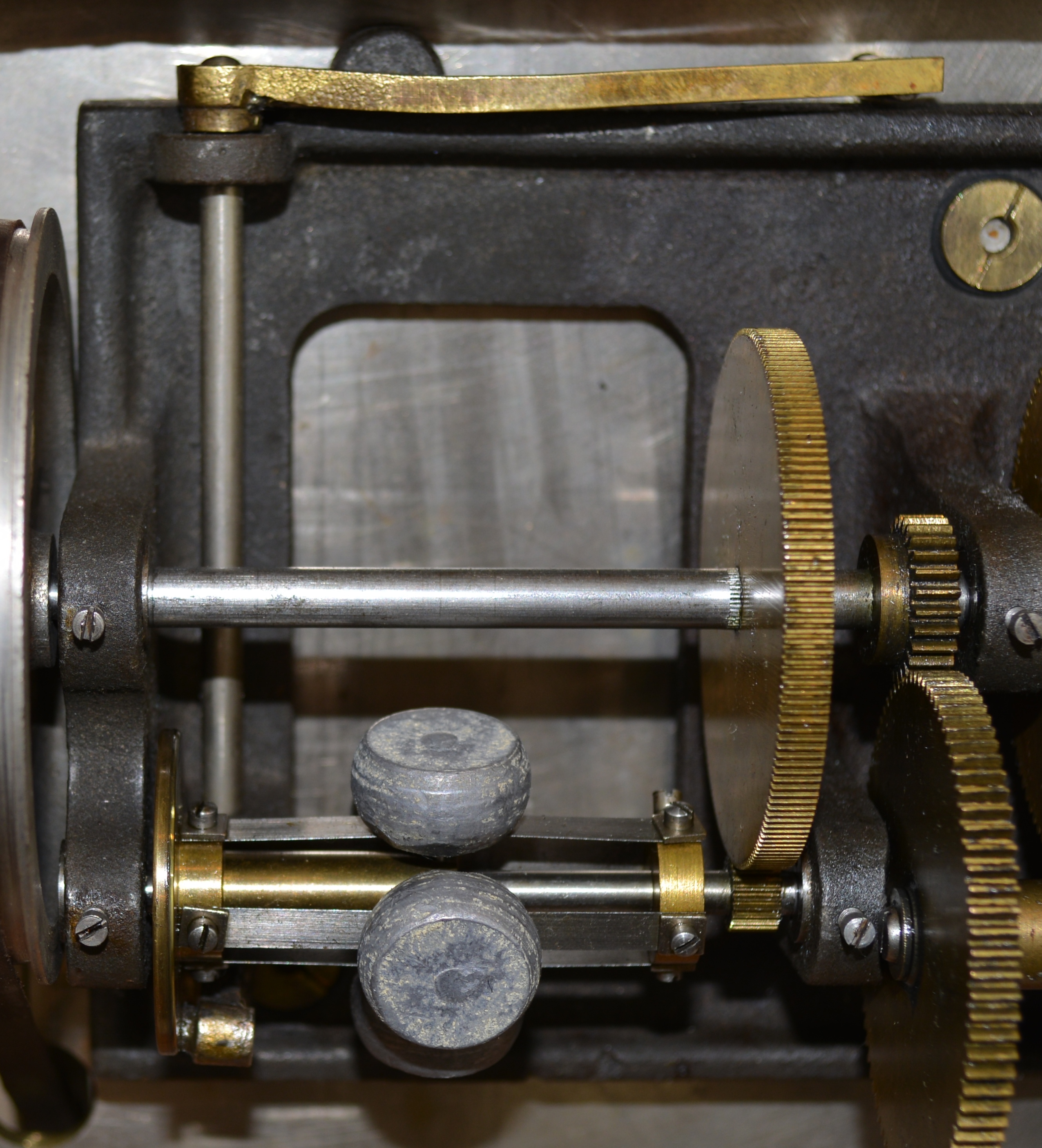

Motor : Columbia Model A, spring-motor, fitted with coin-operated components

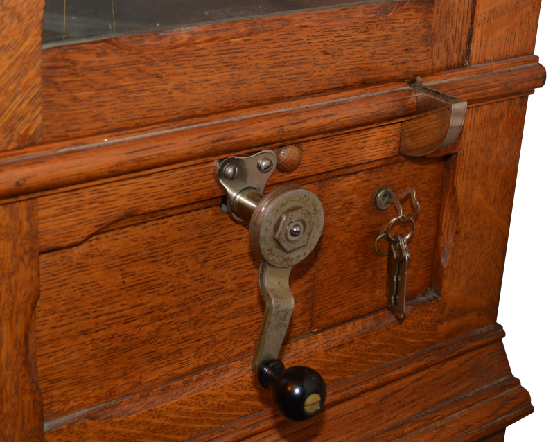

Crank : Slip clutch for coin-operation

The mechanical foundation of the motor for the spring-motor Columbia S-G is the Columbia A. This is the same motor that was used on the coin-operated Columbia spring-motor Type N and AS. Even though it had significantly more mass to move than a Type N or AS, due to the larger mandrel, the single spring motor provided enough power to play through the cylinder and actuate all of the coin operations.
