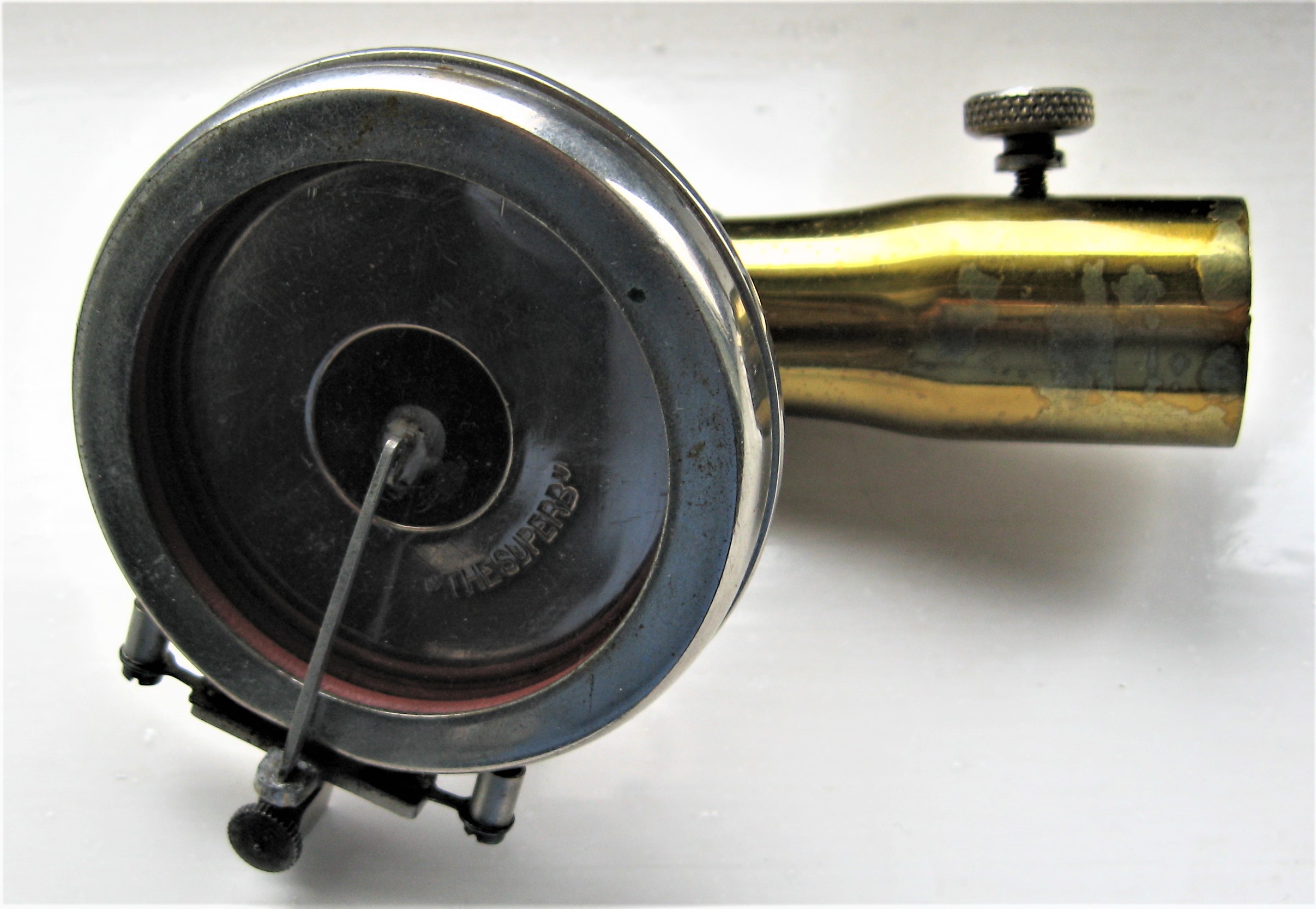

Pictured is a typical soundbox and adapter unit to play conventional "78's" on a Pathé machine.
Pathé themselves produced a reproducer and adapter, also pictured, to play their discs on a conventional gramophone.
