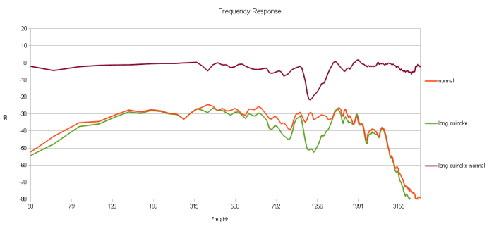

Are there earlier designs using longer quincke tubes? The EMG/Expert quincke tubes seem to be too short to make a significant difference in the frequency range that can be heard with their machines.
I have re-visited my investigation of a longer quincke tube. The attached image shows the frequency response difference with a much longer tube.
The red curve is the frequency response I get when recording Fats Waller's "Copper Colored Gal". The green curve is the response with an extended quincke tube. The difference is shown in the brown curve. The dip at ~1250Hz is consistent with a quincke tube length of ~70mm.

This is very interesting. In any gooseneck tonearm of the wide screw cup lid at the dead end opposite the gooseneck, a Quincke tube with the same thread could be made and replace the original screw cup lid, and then we would have an adjustable notch filter to get rid of the infamous Exhibition ringing tone... 70mm for 1250Hz notch, 86mm for 1000Hz... I have to try that.
Probably the damping effect of the fulcrum springs would make something similar when properly adjusted. But who can adjust an Exhibition soundbox? Not me...
I've tried many times and just when I believe I got it, some other record rings awfully and gets me down... Spanish Odeon recordings of early twenties are top most ringing, rendering the audition completely unpleasant. I have to use one of these for adjustment of the Exhibition. But if you adjust to that, other records sound muffled. I've arrived to the conclusion that one has to keep at hand two soundboxes at least, adjusted differently: one for the "strong" records and another for the"weak" records...
