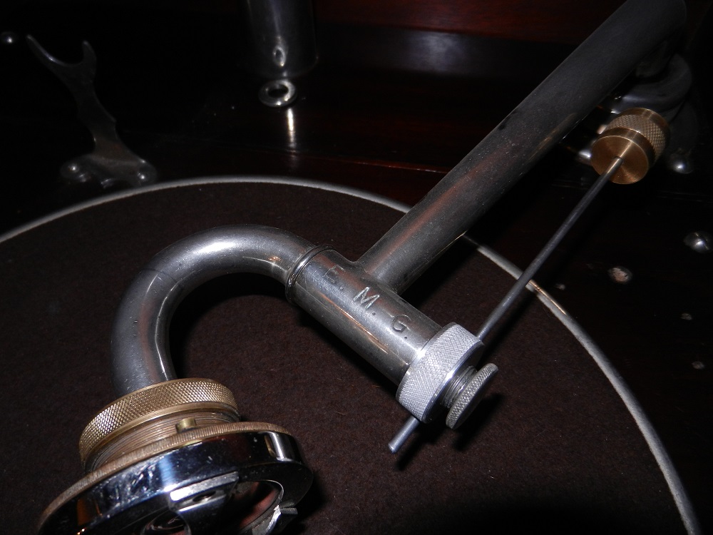

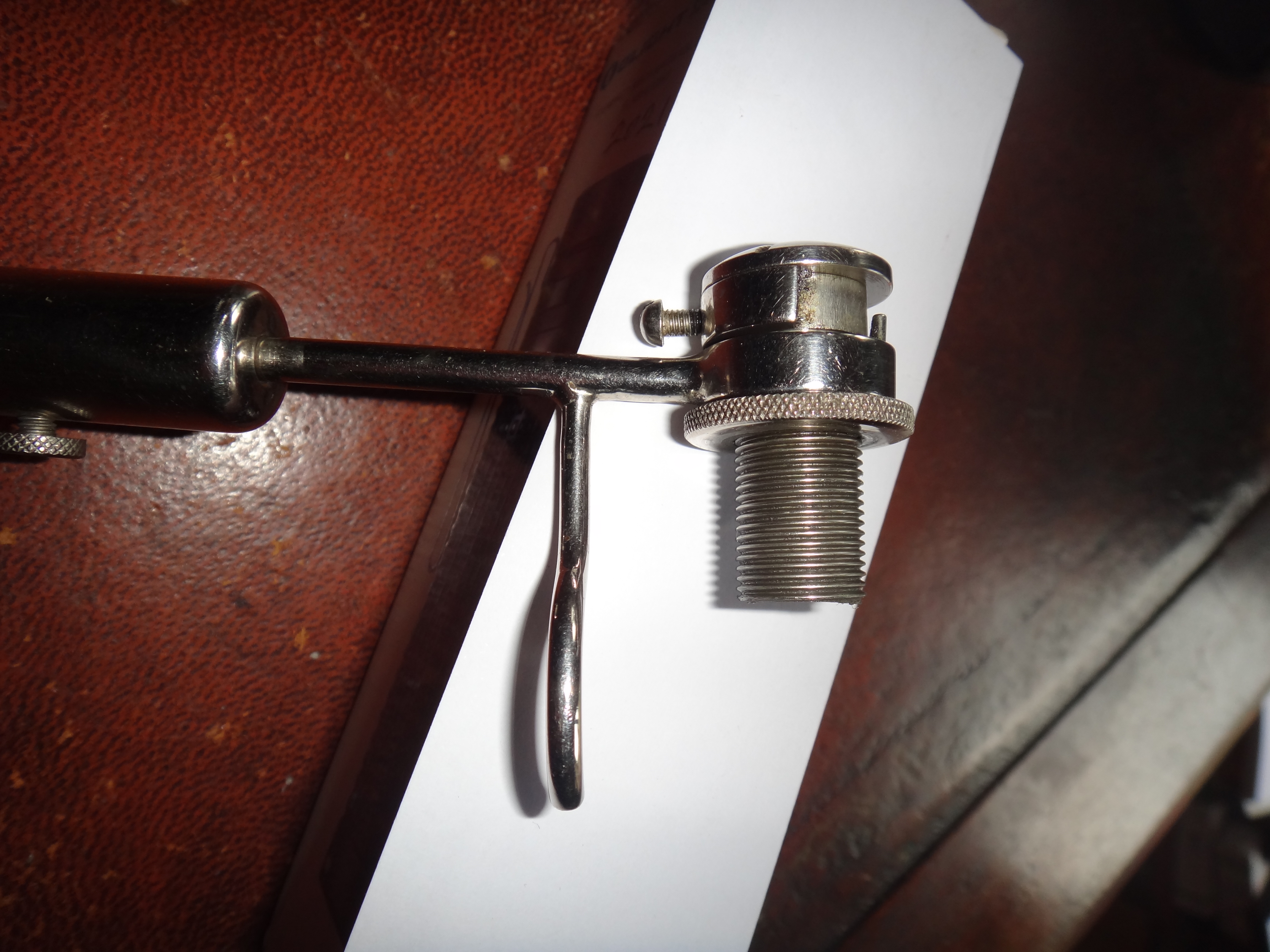

I must confess to just using the Quincke tube as a useful method of attaching a counterbalance arm.
The knurled ring is thread so that it screws onto the Quincke plug and I turned up a fitted washer so that the counterbalance arm rests in the horizontal position when in use. The rod itself slots into a hole drilled through the lower part of the knurled ring.

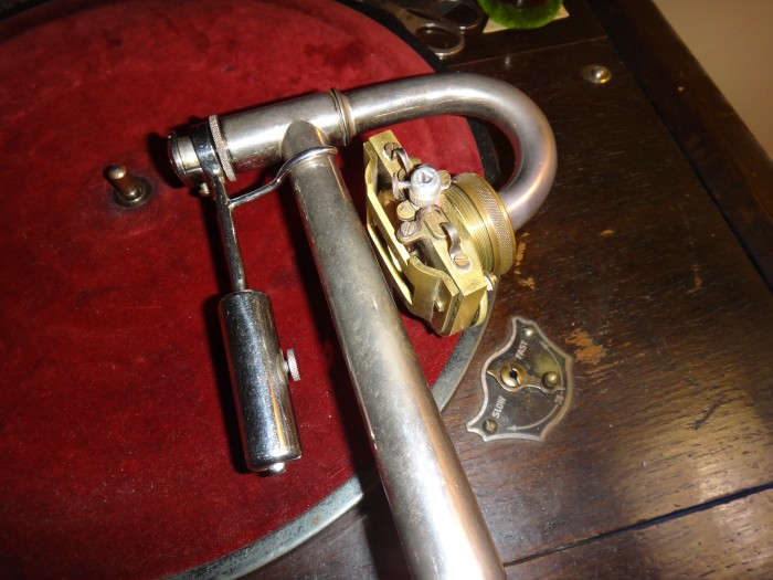

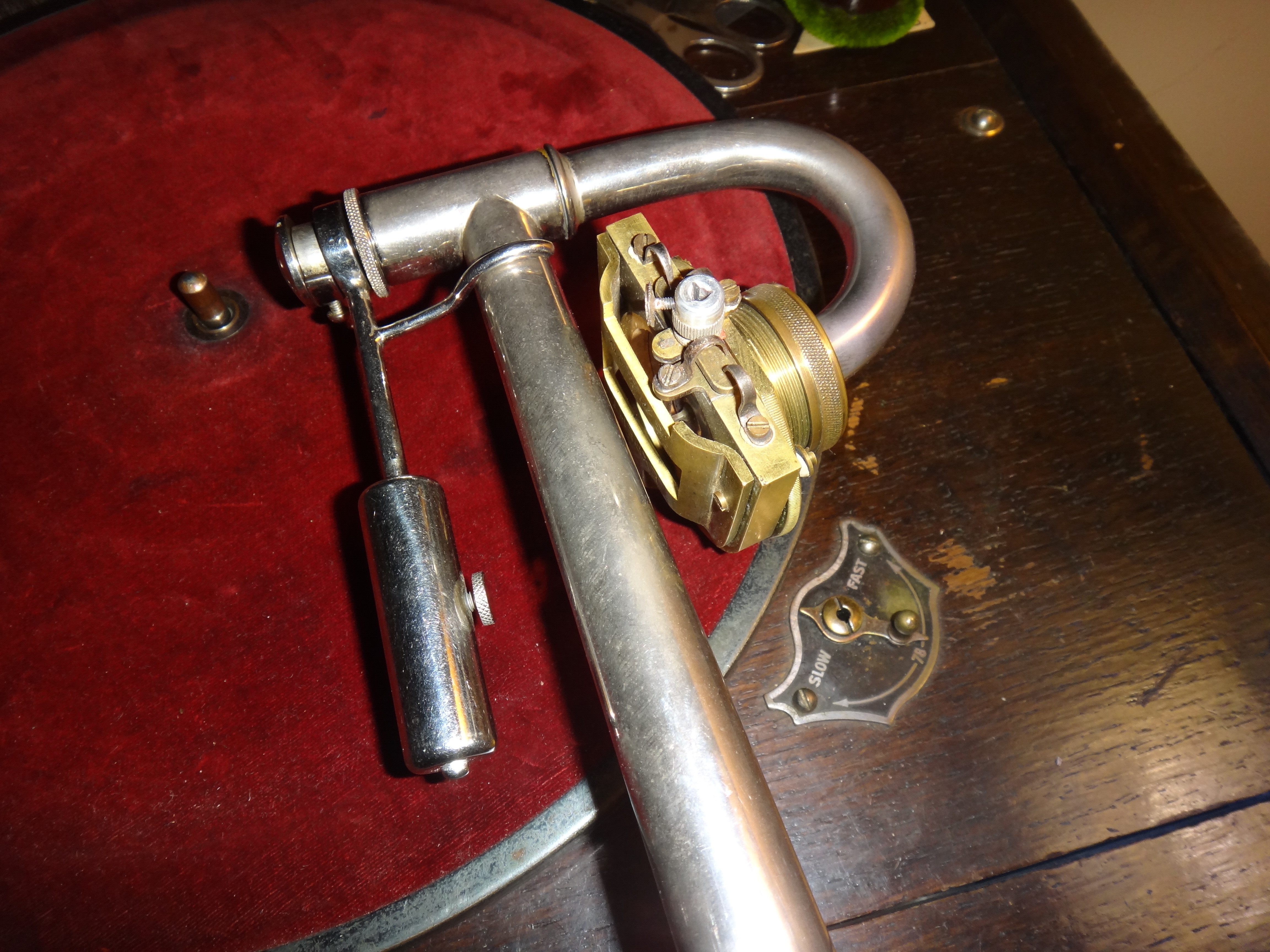

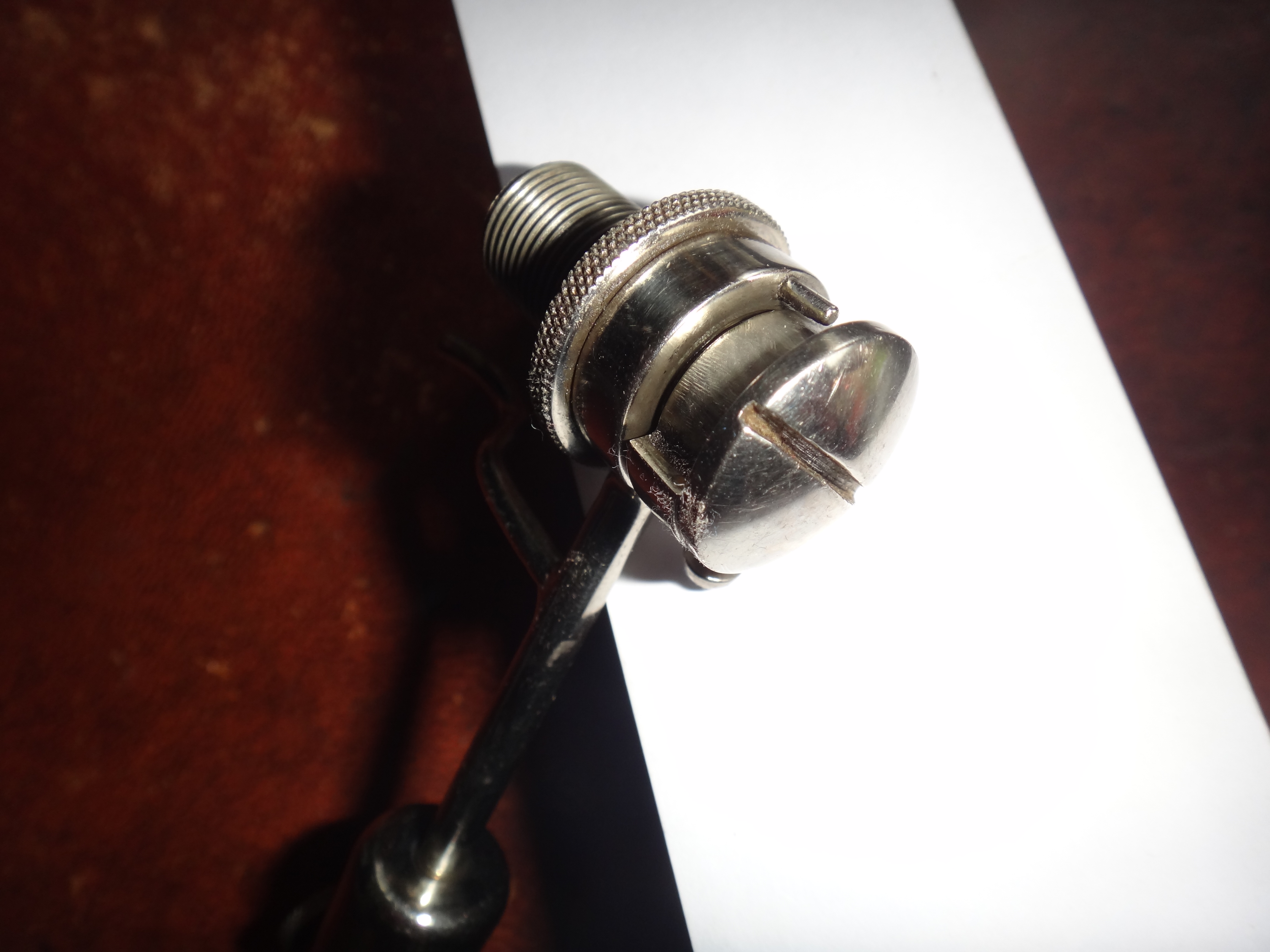

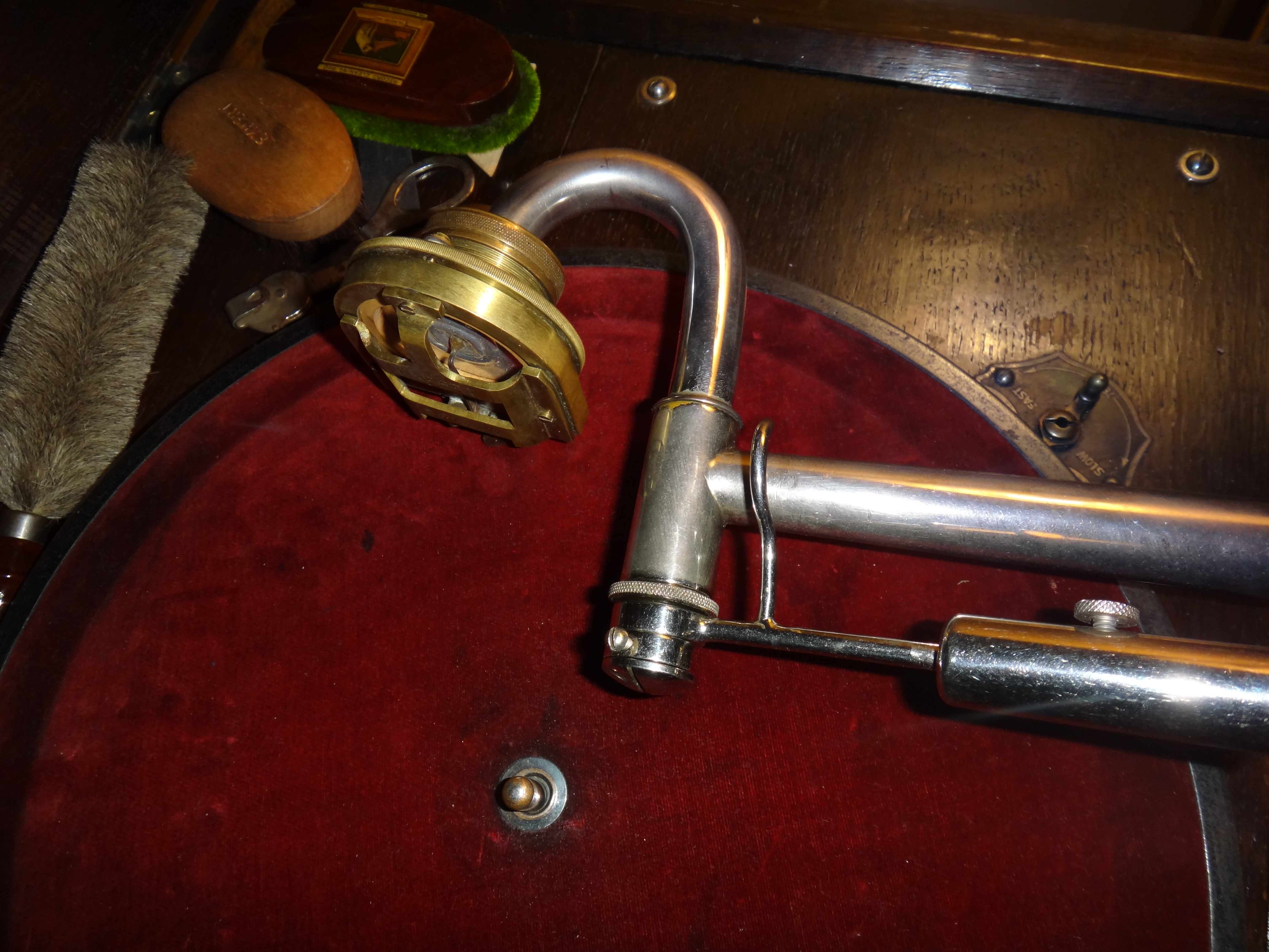

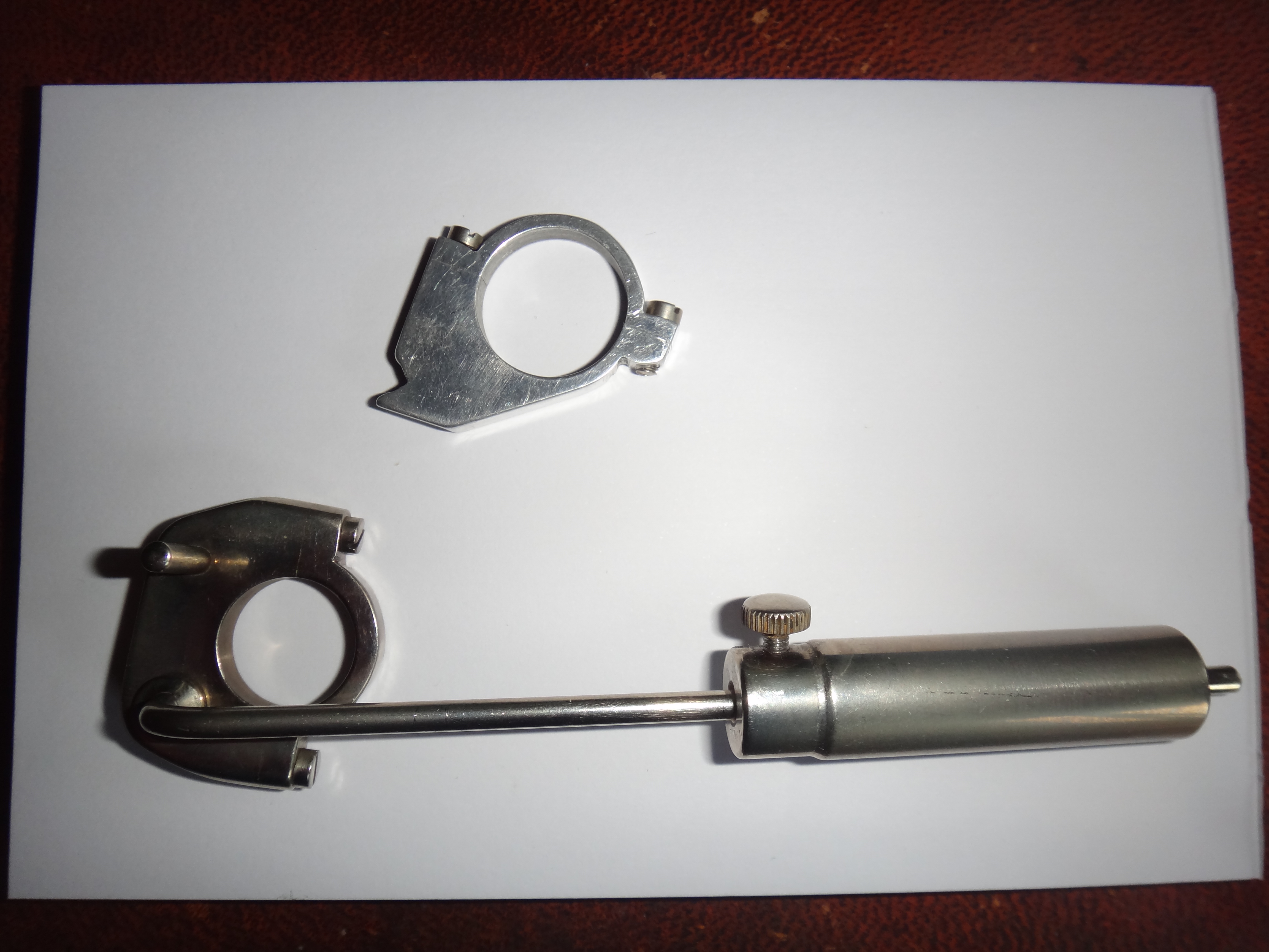

More counterweight solutions :
Ready to play.
Ready to play.
At rest.
At rest.
Showing travel limit pin.
Showing slip ring with pinch screw.

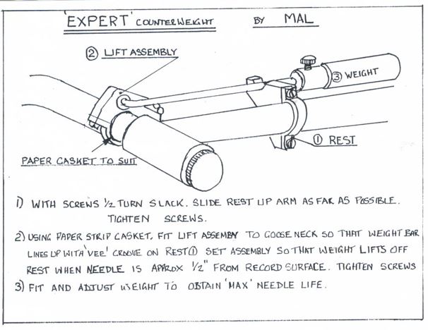

Miles Mallinson's solution.
Miles Mallinson's instructions.
MAL counterweight instructions..JPG (52.74 KiB) Viewed 725 times
